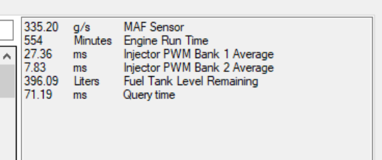

turbotech
Posts: 11
Joined: Fri Aug 31, 2012 2:06 am
cars: slow
Re: PCM Logger 014 reading RAM addresses
Post by turbotech »
Hi,
Below are the results from PcmLogger 16I. I added the injector PW since it shows to be 10x in the reporting window.
[12:14:10:498]  Device reset completed.
[12:14:14:593]  TX: 6C 10 F0 2C FE 4A 00 10 FF FF
[12:14:14:613]  RX: 6C F0 10 6C FE 4A
[12:14:14:613]  Configured MAF Sensor, g/s
[12:14:14:613]  TX: 6C 10 F0 2C FE 5A 11 A1 FF FF
[12:14:14:635]  RX: 6C F0 10 6C FE 5A
[12:14:14:635]  Configured Engine Run Time, Minutes
[12:14:14:635]  TX: 6C 10 F0 2C FE 6A 12 5A FF FF
[12:14:14:656]  RX: 6C F0 10 6C FE 6A
[12:14:14:656]  Configured Injector PWM Bank 1 Average, ms
[12:14:14:656]  TX: 6C 10 F0 2C FD 4A 12 5B FF FF
[12:14:14:686]  RX: 6C F0 10 6C FD 4A
[12:14:14:686]  Configured Injector PWM Bank 2 Average, ms
[12:14:14:686]  TX: 6C 10 F0 2C FD 5A 13 2A FF FF
[12:14:14:706]  RX: 6C F0 10 6C FD 5A
[12:14:14:706]  Configured Fuel Tank Level Remaining, Liters
[12:14:14:736]  TX: 6C 10 F0 2A 01 FE FD
[12:14:14:774]  RX: 6C F0 10 6A FE F0 82 F0 81 01 10
[12:14:14:790]  RX: 6C F0 10 6A FD 01 10 06 63 F6 F6
[12:14:14:852]  TX: 6C 10 F0 2A 01 FE FD
[12:14:14:890]  RX: 6C F0 10 6A FE F0 82 F0 81 01 10
[12:14:14:921]  RX: 6C F0 10 6A FD 01 0C 06 63 F6 F6
[12:14:14:921]  TX: 6C 10 F0 2A 01 FE FD
[12:14:14:975]  RX: 6C F0 10 6A FE F0 82 F0 81 01 0B
[12:14:14:990]  RX: 6C F0 10 6A FD 01 0B 06 63 F6 F6
[12:14:14:990]  TX: 6C 10 F0 2A 01 FE FD
[12:14:15:037]  RX: 6C F0 10 6A FE F0 82 F0 81 01 15
[12:14:15:075]  RX: 6C F0 10 6A FD 01 0B 06 63 F6 F6
[12:14:15:075]  TX: 6C 10 F0 2A 01 FE FD
