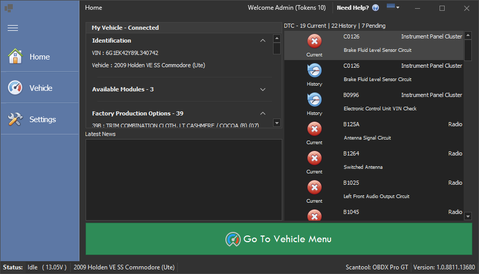

Its fantastic seeing new softwares in production! It truly does motivate me to continue expanding the tools capabilities.
I have been speaking with developers making apps for Opels, Chev/GMC, Toyotas, Nissan and Fords! Its genuinely exciting to hear from these developers!
On that note, I have been VERY busy myself, and am just about ready to release this app which will be an all-in-one GM flashing application.
The aim is to add all the custom abilities I can currently do plus basically replace techline to allow techs to perform a job without relying on techline.
So naturally, I have gone absolutely overboard with it.
I have servers configured to pull RPOs for each car which are then used throughout the application to ensure correct configuration/calibrations are offered for that specific car, along with offering any customizable options to go with them. This includes checking and verifying a modules information to minimize the chance of fitting incompatible parts.
I am looking forward to seeing the community solve issues faster and easier with this. No more "techline is down" messages, no more waiting days for support replies, there will be active developers/helpers to fix issues or provide guidance (As this is a joint venture).
Will be looking for testers soon
