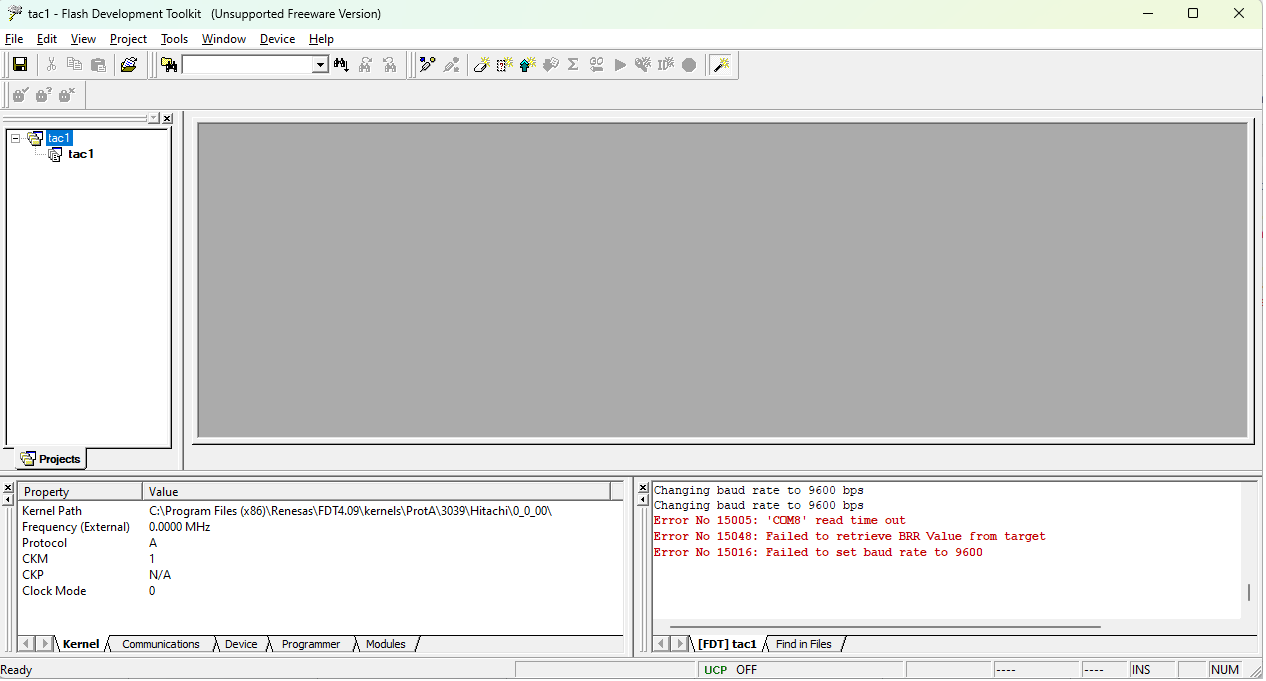

got the renesas FDT running and chip connected through a 5v FTDI adapter. Set the chip in mode 7(it's already set on the board with all mode pins set high), trying to use user programming mode so I can attempt a read without wiping it. I can't get it to connect yet, but I'll keep working on it. Got to be close I'd think. If the 3039 files will work to connect to it then I can probably modify the setup files for the smaller flash size of the 3038.

I really want a TAC dump though lol. I tried a bunch of settings in the old hitachi/renenas tool but can't get anything up and running. :comp:
I'm after a few different DBW parameters. Ex- how a TPS mismatch is handled....is it in the TAC or PCM? ect..
