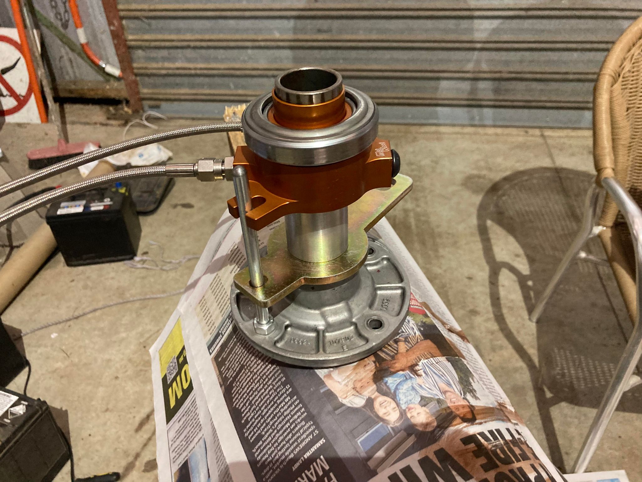

I have one of those kits sitting in the shed from Malwood, except I'm going to attempt to modify or use bits from it to make one for a 4Runner with a Buick in it, since none of the conversion or Toyota parts last more than a few days without something failing.
It's actually not a concentric slave, but a hydraulic piston that's hollow at he base of the assembly, the whole assembly with the bearing on the front moves rather than the bearing. Kind of like an upside down concentric slave.

This is the Malwood one I did a quick mock up to see how it works and to get an idea on the feasibility for the 4Runner.
Posts: 3427
Re: T5 hydraulic clutch conversion
How is that held in place at the correct height?
Posts: 7806
There is a spacer tube. Not immediately obvious in the pic. There are adjusting shims as well, they go under the unit.
