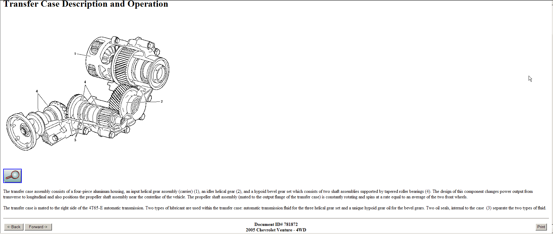

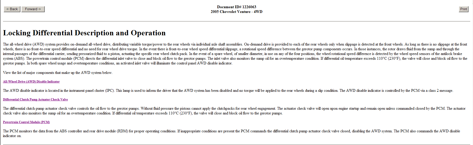

The only "4WD" p04 vehicles I'm aware of are the Venture/Montana vans, which are more of a part time AWD than true 4WD. I don't think it has 4High/4Low and techline seems to confirm this.
Maybe there are other 4wd applications that could explain it though
