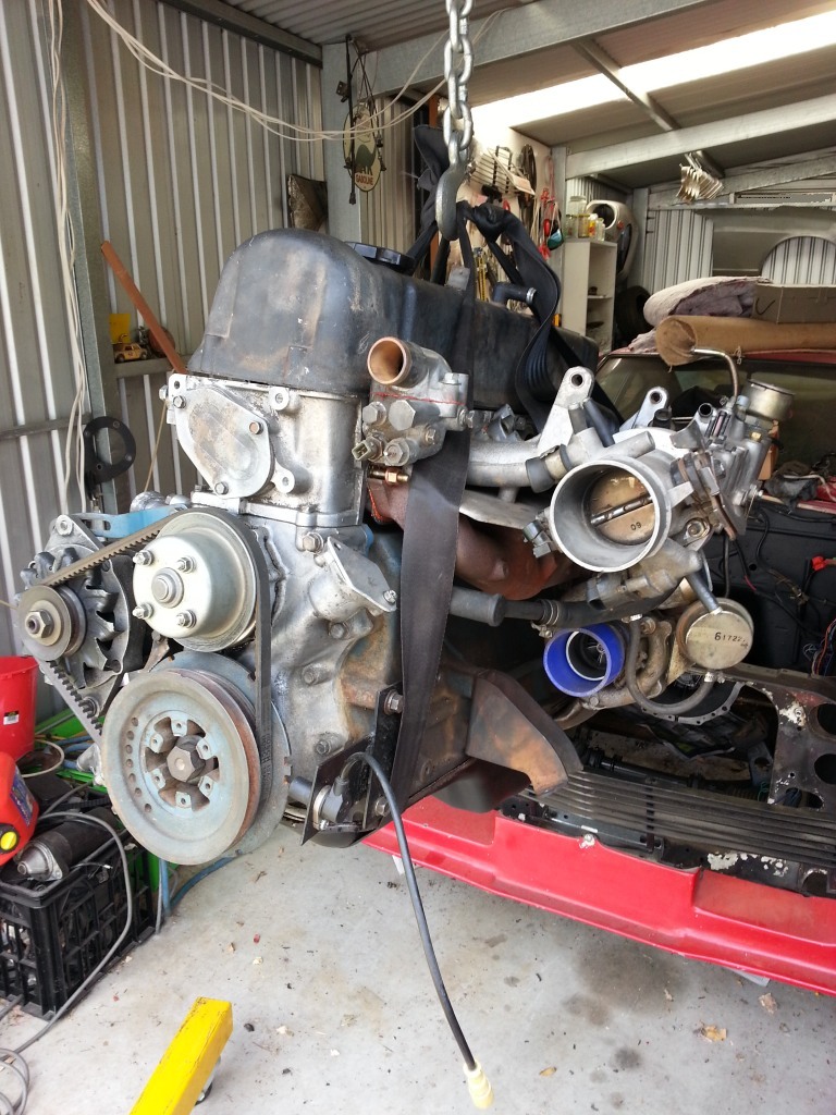

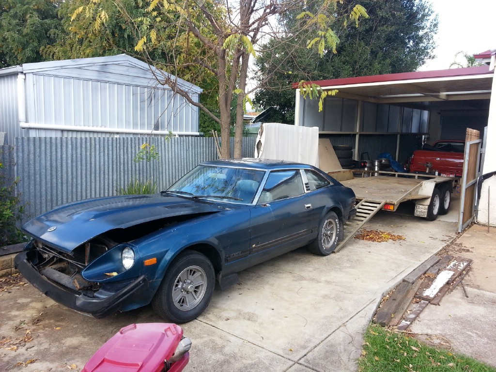

Firstly, as Antus said we set out to obtain a good L28 motor from a 280ZX which they are pretty common still so it didn't take too long... Although not a turbo car the motor had all the right bits to be a turbo engine (F54 block and a P90 head for those playing at home). Antus and I looked the motor over before buying it including compression testing and a good once over and getting it running which is more than the last engine. I then drove the car for 3 months so we knew it was good this time.

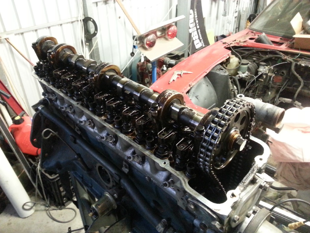

Once the engine was out of the car we stripped it down and inspected everything we could, replaced the water pump and checked out the chain tensioner and everything else that could be checked. Then back together with fresh gaskets where we could and out with that pesky dizzy.

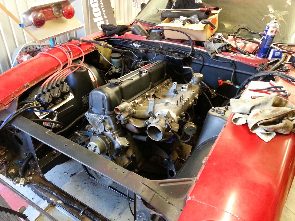

Then it was time to bolt the manifold and all the bits back on including the crank angle sensor that can be seen clearly hanging at the front of the engine below. All of the bits from the L20A were swapped over and the injectors were upgraded to a set that should flow enough however we didn't do the maths (note to self, always confirm what you put in before putting them in!)
While it was out I coated the engine bay matte black so that I could see if anything leaked and we also cleaned the engine for the same reason... Next it was a nights work to get it back in and ready to go. Everything slotted in nicely
