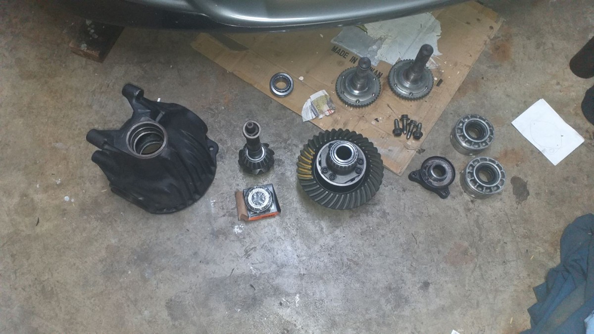

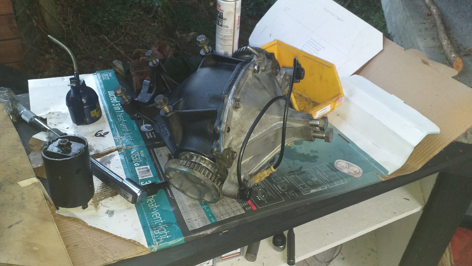

Got stuck into the diff today. Eaton trutrac centre and Motive 3.73 gears should wake it up a bit and give a lot better traction ( the missus was complaining about a lack of traction in moist conditions...)

Diff is ready to go, I just need to fill the oil in the morning once the sealant has cured overnight.

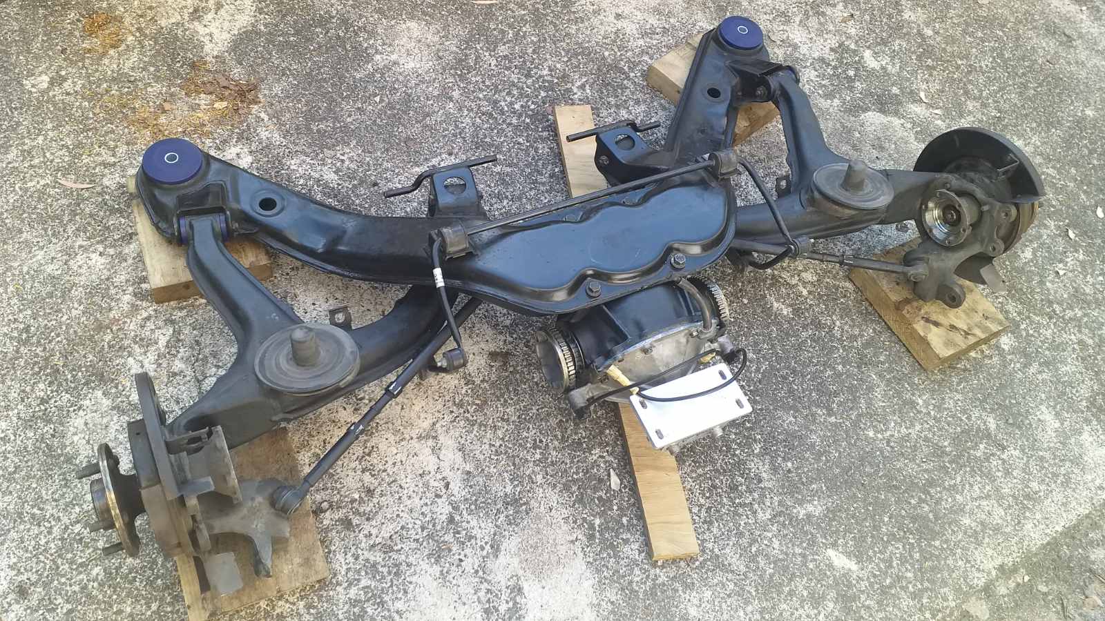

Got it all back together to go back into the car tomorrow. Gave it a quick clean and made it shiny.

She's back on all four wheels. Still need to torque all the suspension bushes bolts now that it is at ride height but it's to dark to do that now. Fired the old girl up without the cat back exhaust. Still got a cold start miss and it sounded angry which the guy walking past appreciated :)
