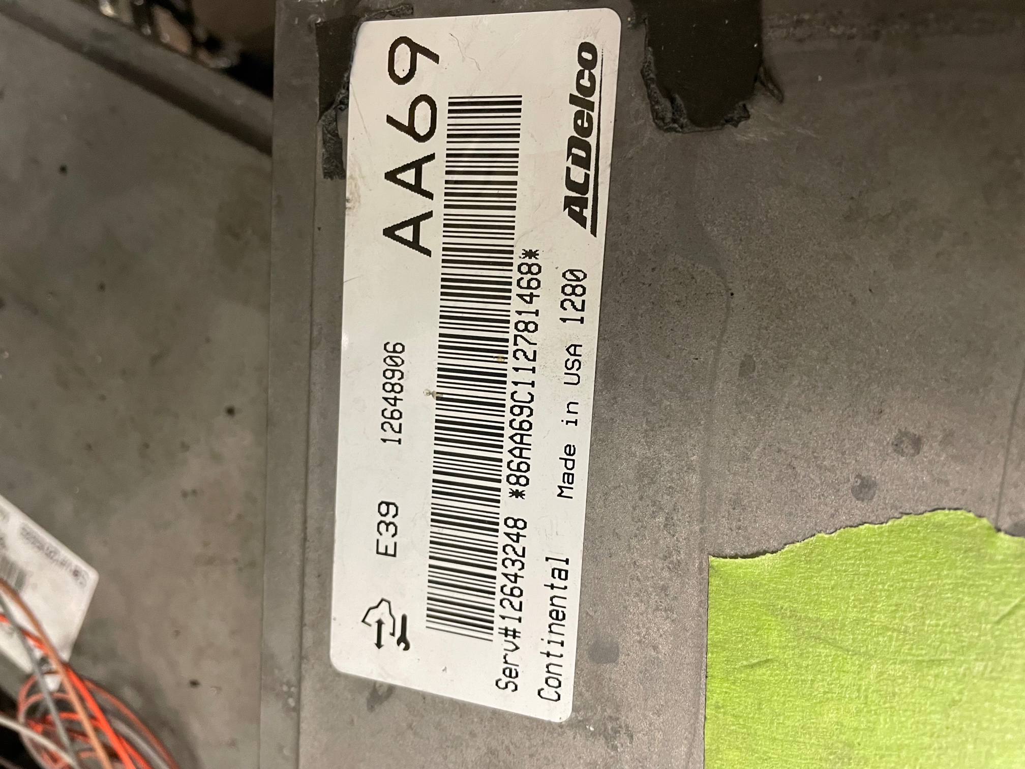

I don't need any but this is the first I've heard of shadow passwords.. Can you elaborate a little?

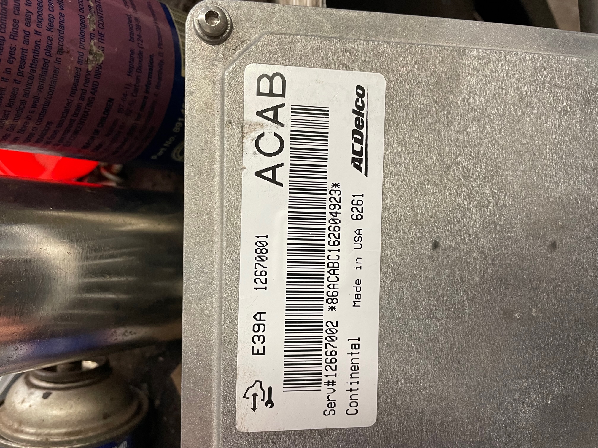

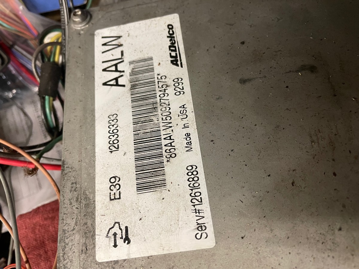

I do have some ecms and took a couple pics, I'll upload them here for you. Maybe if nobody else needs the password you could send me it for the e39 with ID AA69 on the top right, currently plugged into it on the bench for playing around.

sent you a password pm
You received ?
ironduke
Posts: 698
Re: Shadow Password E98, E39, E39A
Post by ironduke »
Yes I got it, thanks!! Now I need to learn what can be done with it, lol. I’ll try and take a look at the vin tomorrow and see where it is in the eeprom. Assuming it is.

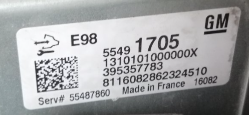

Got a locked one after some1 flashed wrong tune in and corrupted it.
55491997
1310101000000x
395357783
1117107872540185
serv#55487860
kostia111
Posts: 55
Joined: Mon Oct 21, 2019 4:58 am
Post by kostia111 »
Password=EBF56D76AC35AE36
