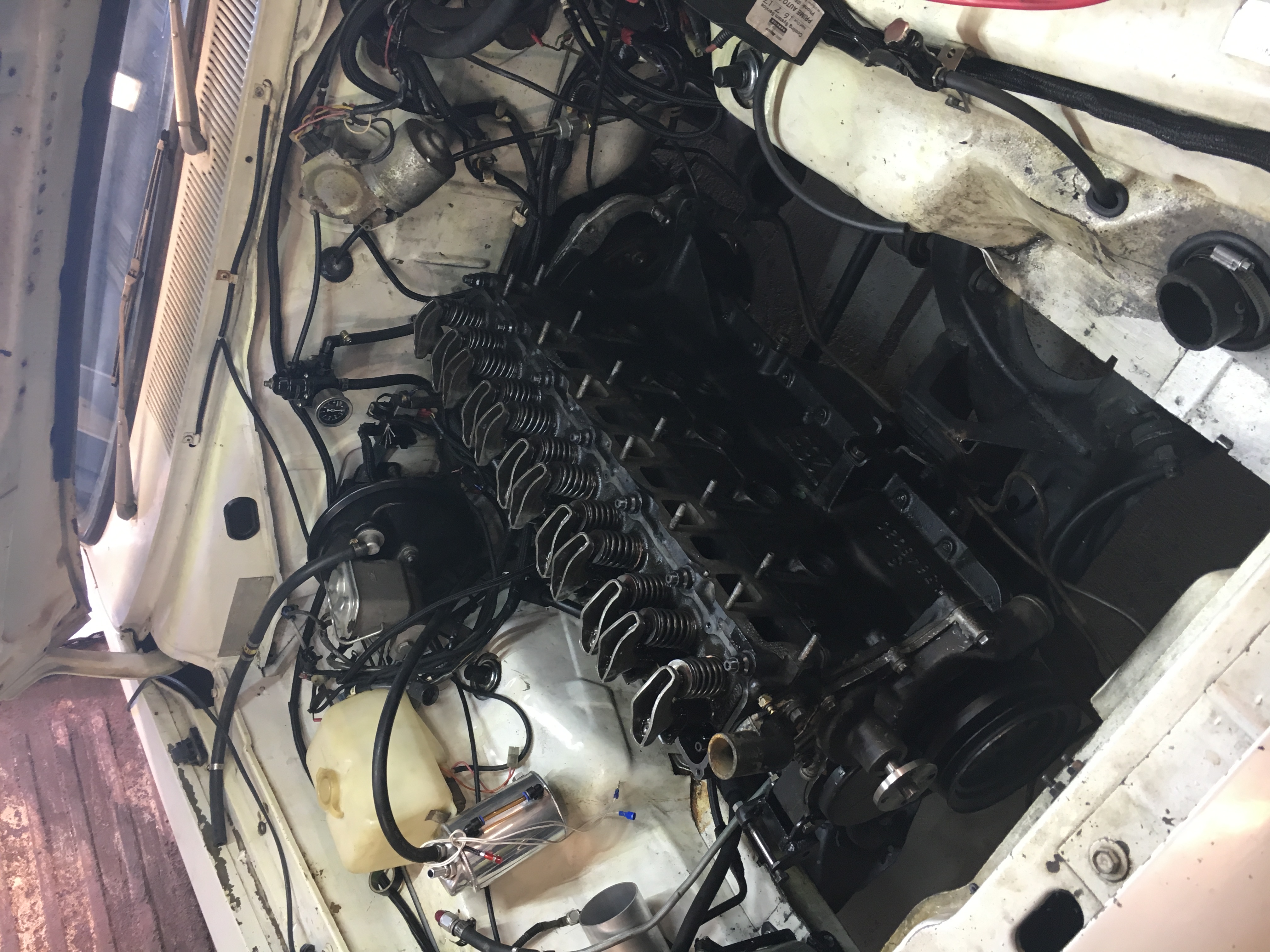

Motors back in and bolted up to the trans, should be running again soon.

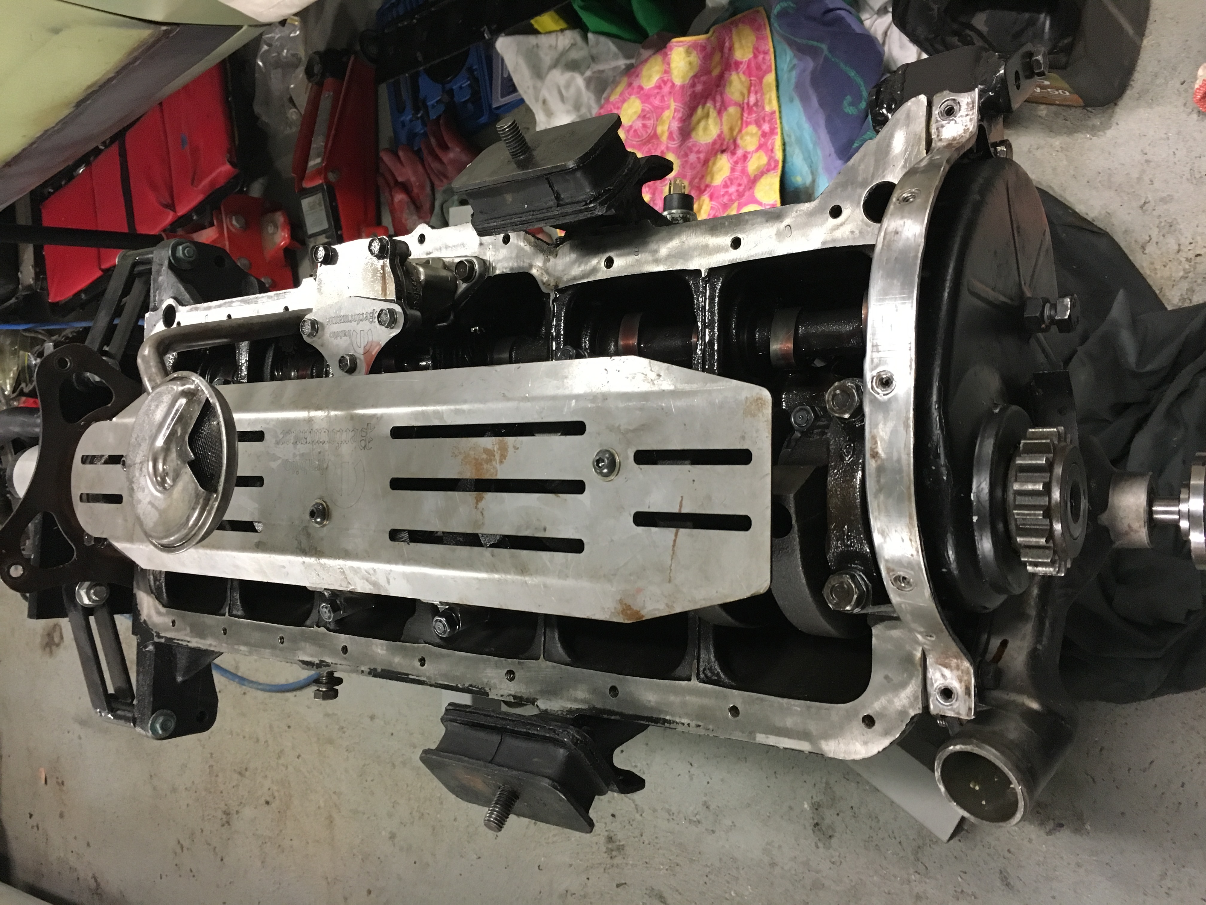

What's the cogged wheel on the front of the crank for? Ignition trigger?
heff0018
Posts: 1045
Re: 265 Hemi to efi
Post by heff0018 »
Nothing, its just an old timing chain sprocket I use to run the motor over with.

Charlescrown wrote:What's the cogged wheel on the front of the crank for? Ignition trigger?
heff0018 wrote:Nothing, its just an old timing chain sprocket I use to run the motor over with.
Glad someone asked teh question as I was sitting here going, errr that is a timing gear what is it doing on the outside of the timing case..... then I noticed that the pulleys were installed on the in car shot and though ok, temporary or you worked out it needed to be on the inside :P
Looking good so far, hopefully it will go grrr soon.
Need video of the initial start :D

Fitted up the alternator and clearance to the power steering pump is all good. Glad I took measurements before pullling the motor out.
Just waiting on a new rocker cover gasket that is on back order.
