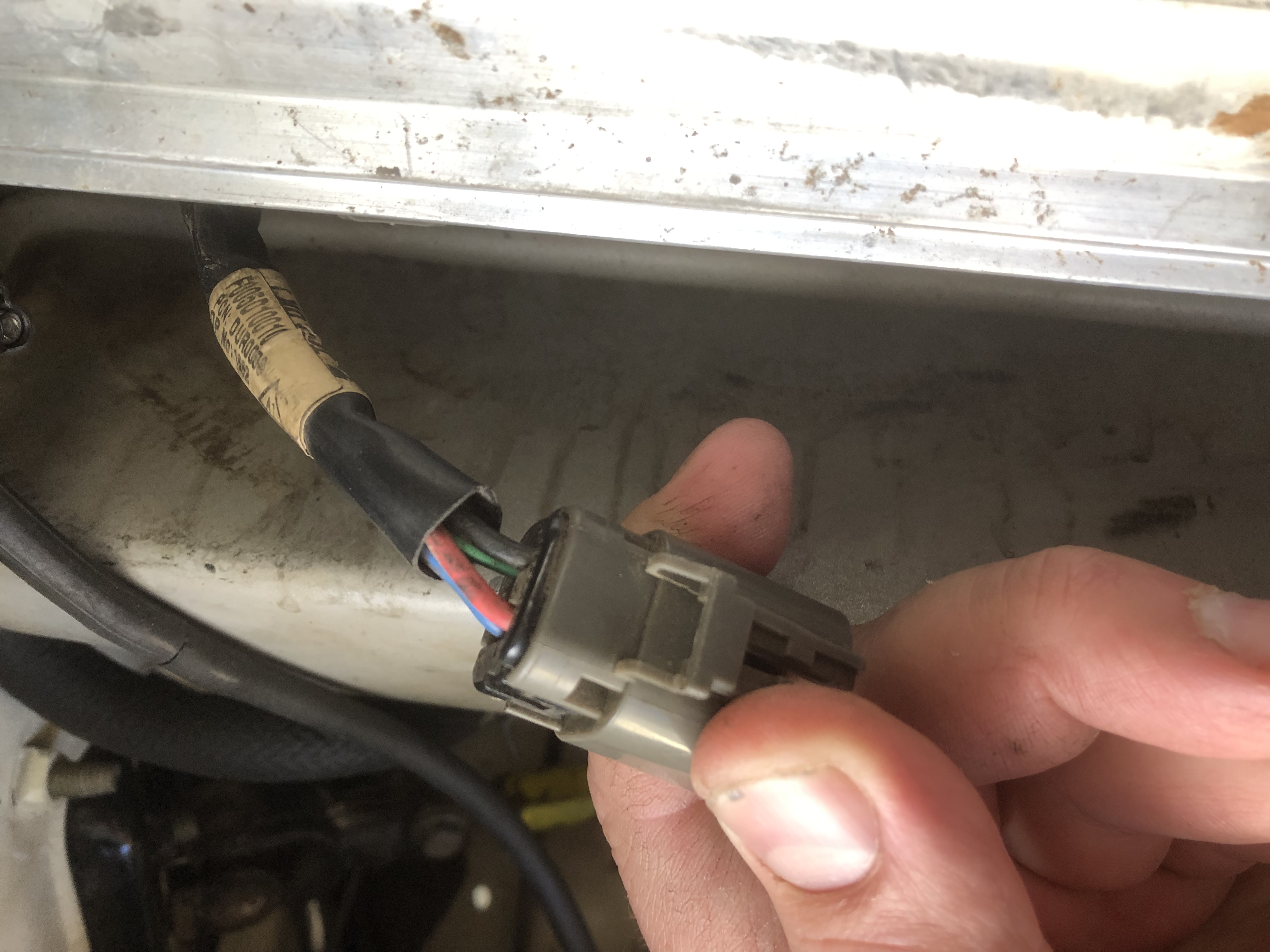

Hey mate,
Yes that’s correct.
The pig tail wires out of the dizzy are red, blue, green and black... wish I could figure out how to post pics on here...

Yes that’s it,
So the pig tail coming from the vs dizzy has red, black, green and blue...
Didn’t get a message sorry mate,
I checked my junk n that.. sorry to be a pain

From memory it’s dizzy Vp harness
Red = White/black
Green = light blue/white
Black = grey/red
Blue is not needed on vp.
Dazzle should sort you out.

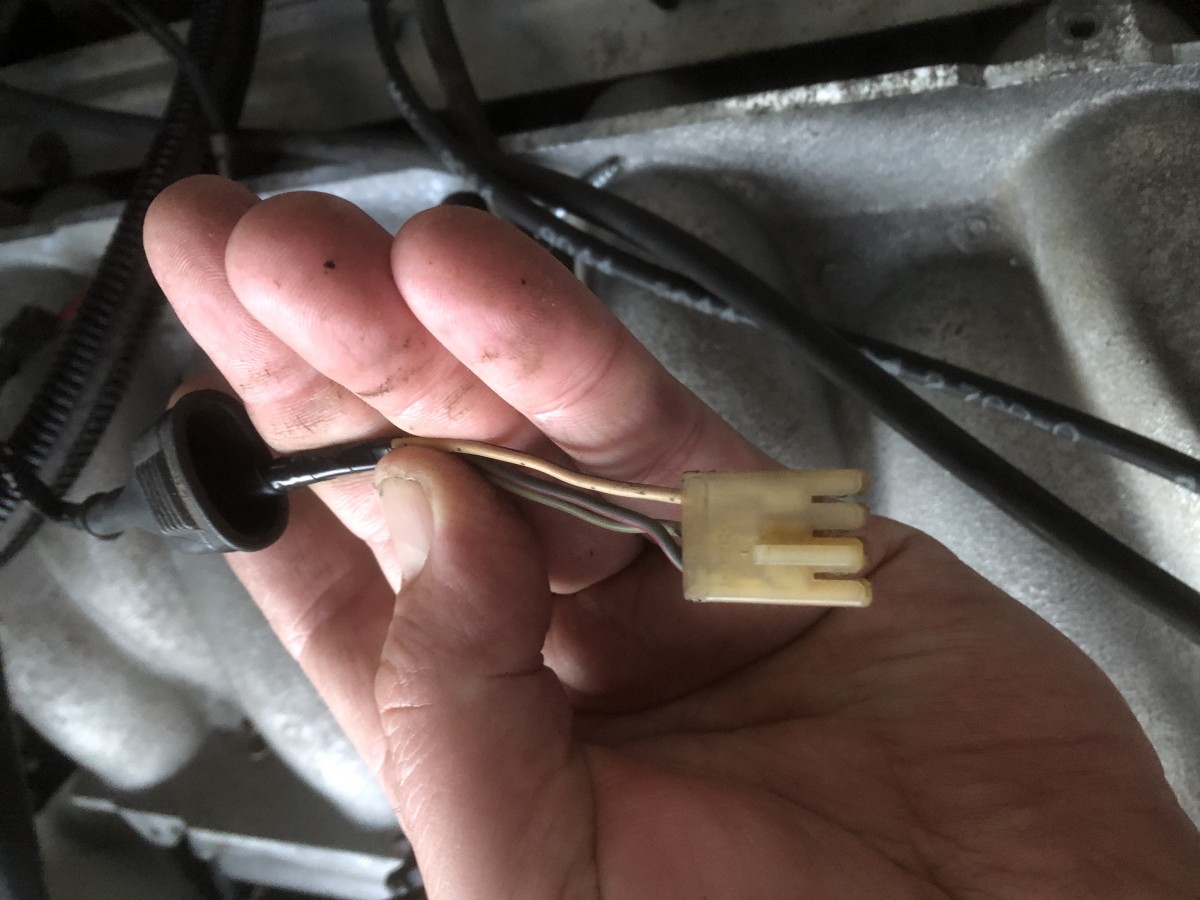

These are the pics
Humptydumpty
Posts: 58
Joined: Fri May 10, 2019 12:11 pm
cars: Toyota Bundera, Sr Hilux, Hilux workmate.
Location: Sydney
Re: converting harnes to vs 304 engine
Post by Humptydumpty »
Pic from VP harness

vs ss wrote:From memory it’s dizzy Vp harness
Red = White/black
Black = grey/red
Thanks mate,
Looks good the only thing I’m not sure on is the black wire... thought a couple of people said the black isn’t used from the vs dizzy loom.... cheers mate that’s helpful..

not sure if you have vs series 3/vt maf sensor engine or not without more pics.
1st pic looks like sequential plug...2nd pic need to look at shape of plug to see if you need vn/p or later vr/s plug or dissy to suit.
Usually if you have vn/p dissy or harness with vr/s opposite just change plug to match...can buy off efihardware.com last time i checked.
The o2 sensor just get correct one you need.
Got early blue plug dissy should be vn/p & black plug usually later vr/s but that all changes if aftermarket.
Black wire most like earth to back of head grouped with others

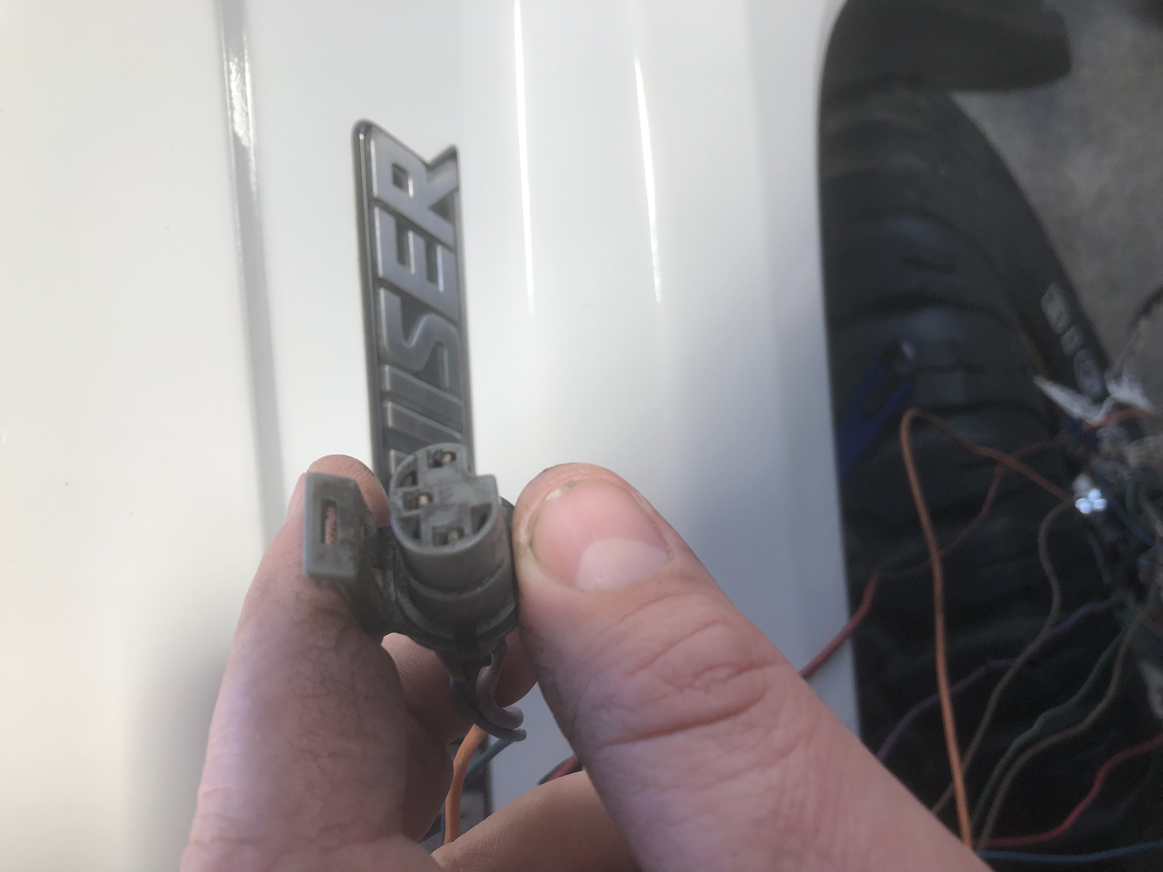

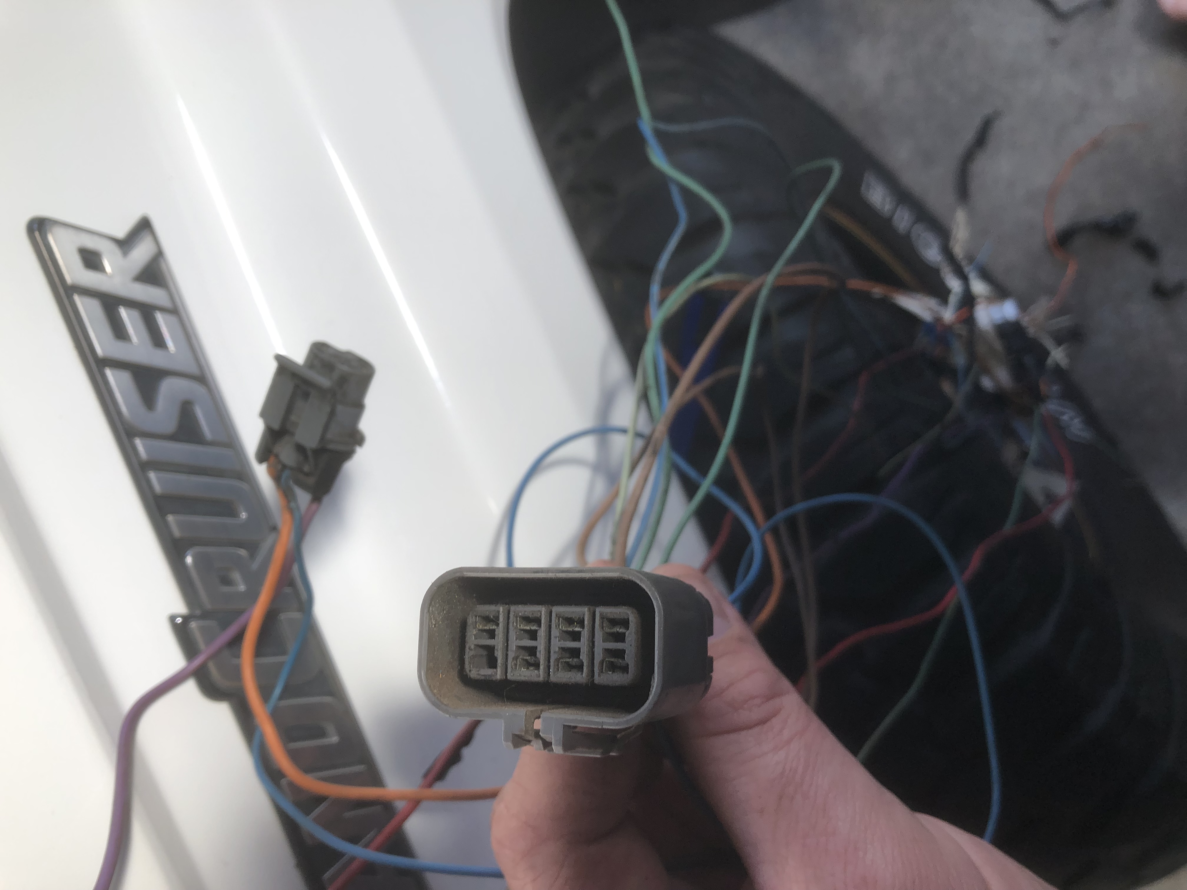

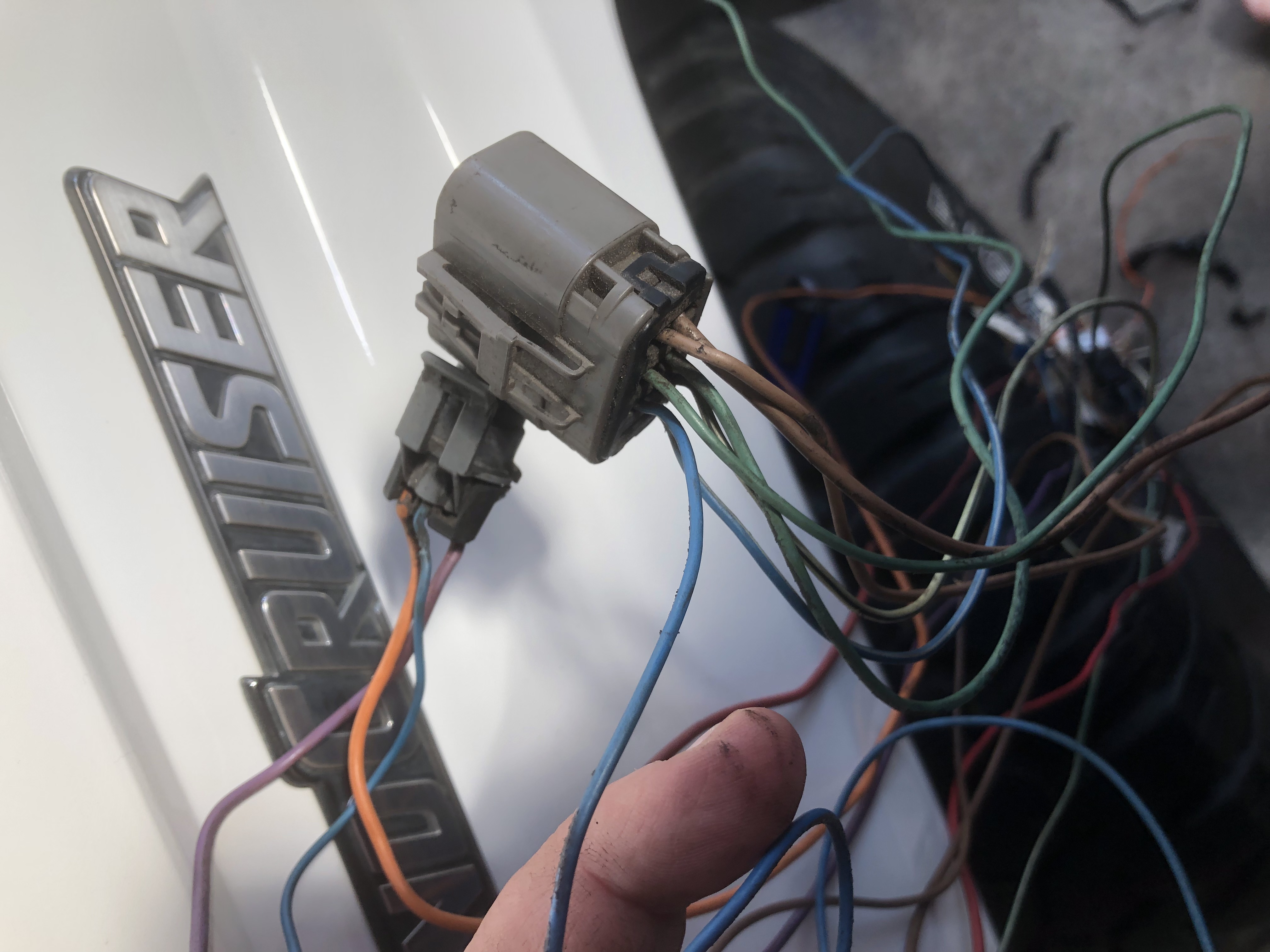

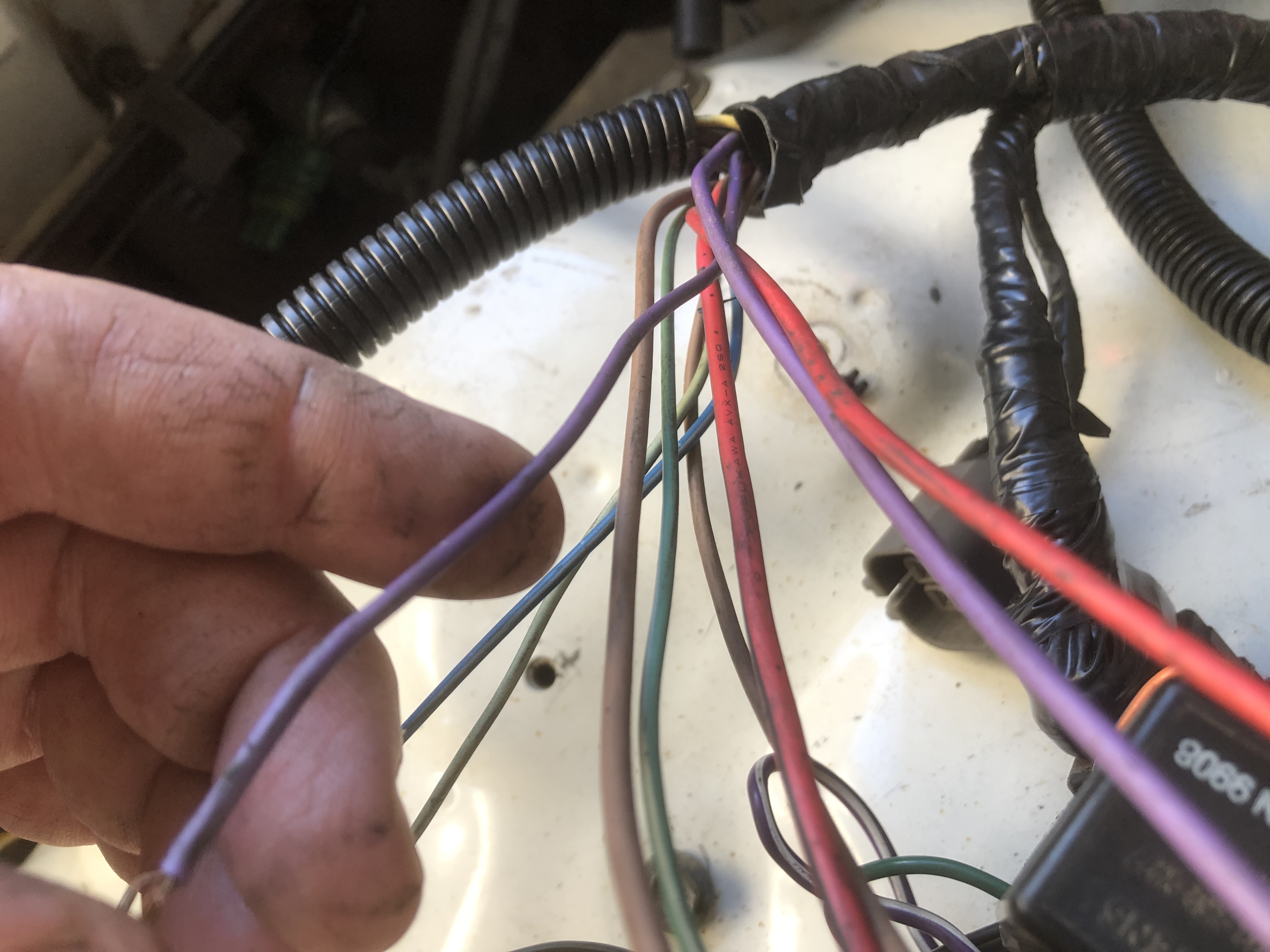

Hi guys,
Another question in regard to the air temp sensor and o2 sensor wires - I’m sorting the loom out and found 3 wires to the sensor plug - 1 is a power supply(purple wire) then a blue one that runs to a rectangle plug (see pic) then an orange one that runs back into the loom - can some tell me how this all Works (that rectangular plug doesn’t go to anything that I have) and the purple wire in last pic is o2 wire?
Thanks

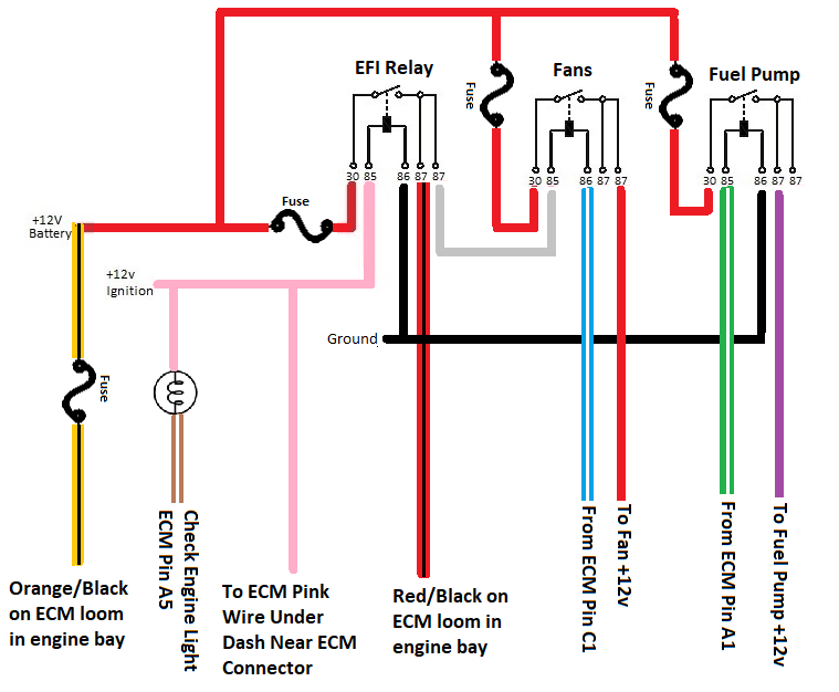

the 3 pin round plug is for the oil pressure sensor, i normally dont use, but if you wanted to use it for the oil pressure light you can by using the blue wire, the orange and purple are to allow the fuel pump to run once there is oil pressure.
most of the wires in the rectangle grey plug are for things like a/c fuel pump and fans to control relays, as that plug connects to the relay box in a commodore engine bay.
this might help you for a basic stand alone loom to get it running.
Stand Alone 808 Relay Wiring Diagram.png (48.76 KiB) Viewed 7545 times
