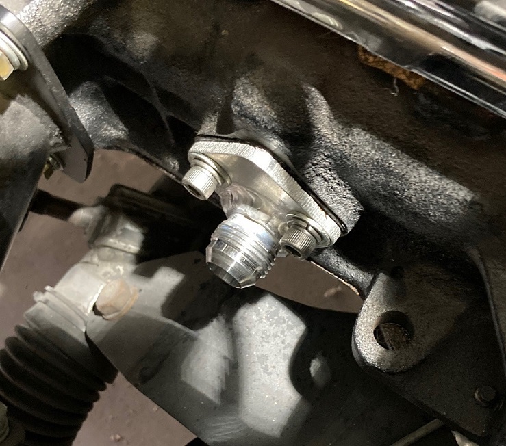

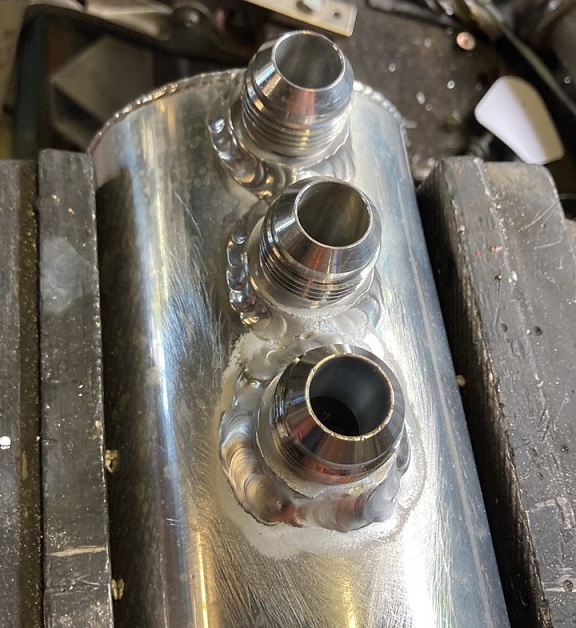

First thing i wanted to do was to add a vent from the sump to the catch can, as i was getting a bit of oil out the dipstick tube, this was probably partially as the seal on them is not real flash but also possibly because there is no way for the pressure to get out other than up the oil return passages and back to the tappet cover, so i got an alloy fuel pump blank off plate and a speedflow fitting and blew the cobwebs off the tig (this is the second real job for the tig since i bought it!)
Not the best weld but it will hold!
So this was the one i was worried about welding, its not the thickest alloy and i didnt want it to cave in on me, anyways it worked ok once i got some heat into it.
All installed and ready to roll, thankfully i had a bit of the clear hose left over because i always like to buy more than i need!

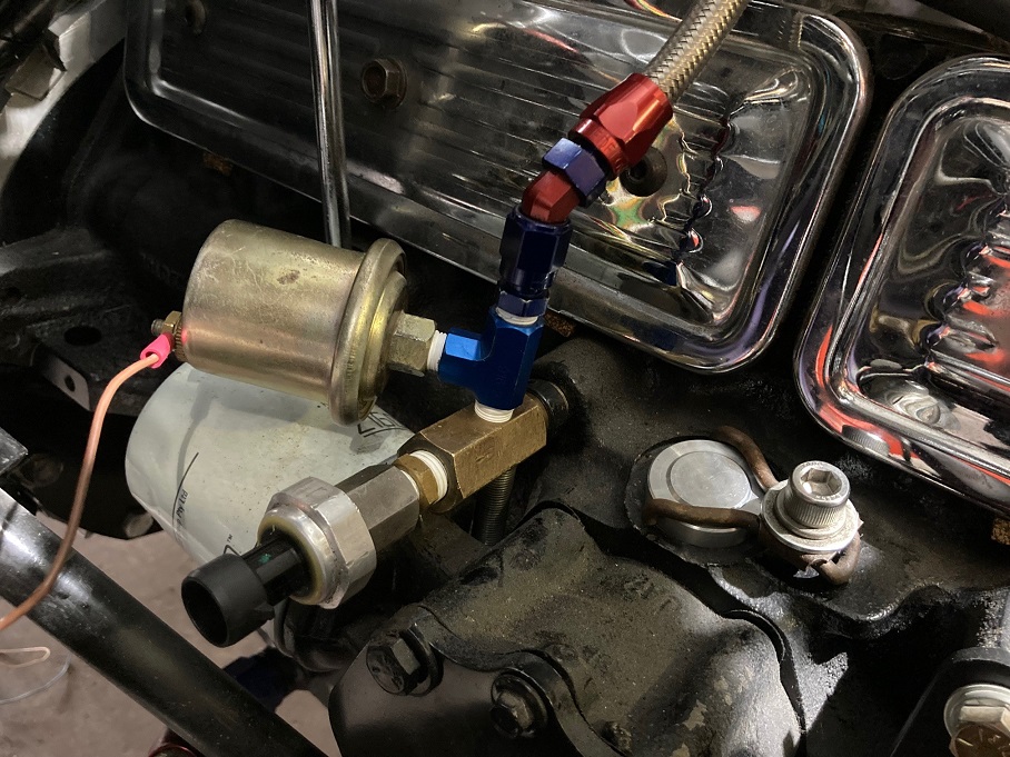

Next on the list was to add a few sensors to the engine, primarily engine oil pressure, and i also added trans temp just because the new pan had a second bung in it! So i got a speedflow T piece and got it all plumbed up, the sensor on the end is an alloytec oil pressure sensor, and the plug is the same as a TPS plug so all stuff i had laying around, the big bulb sensor is the dash gauge and the braided line is the oil feed to the turbo.
It then just needed a metric to imperial adaptor for the alloytec sensor.

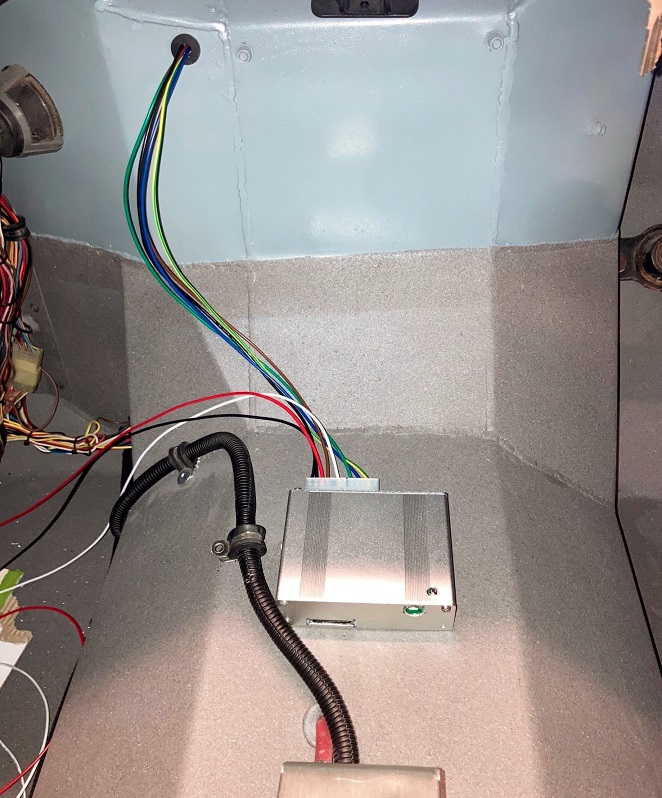

Started on installing the data logger and running wiring to the sensors etc.

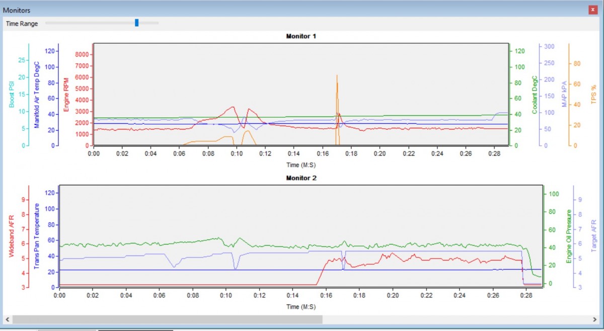

This is a quick log i did of it, you can see the bottom monitor with trans temp and engine oil pressure - very interested to see what that shows me!

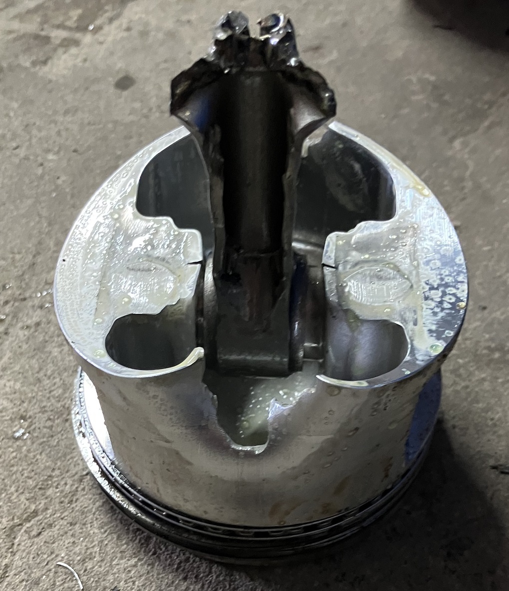

So i go out for my third run, did a nice big burnout, and right at the end of it, dropped a cylinder and engine was vibrating badly, so i backed off the start line, thankfully the small hole in the sump hadn't yet leaked anything onto the track!
But at that point when i looked under the car it was fairly clear it had thrown a rod!

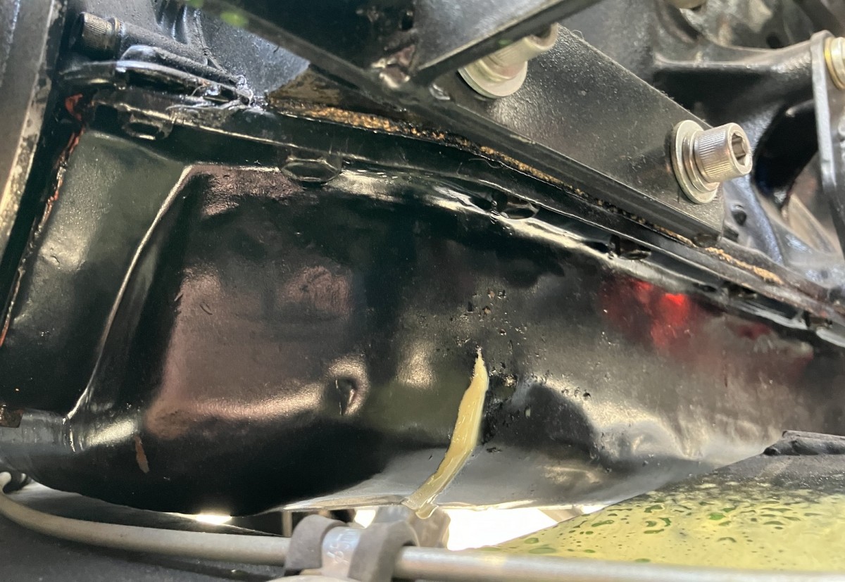

So i realised after the radiator top tank was cold that it was enpty, so i wanted to drain the sump to make sure there was no water in there rusting up things. So i went and bought a 10ltr jerry can and used that to drain 10ltrs of mayo out of the sump!

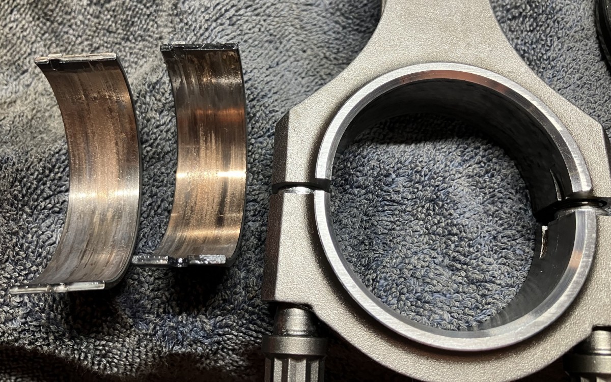

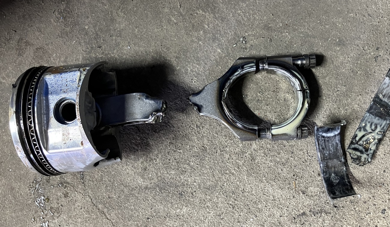

Got home and got the motor out and assessed the damage! Looks like lack of oil has caused it to spin a bearing and the rest is history!
You can see here either side of the rod its smacked the crank pretty hard and left some nice dints in the piston and cracks on the gudgeon pin area.

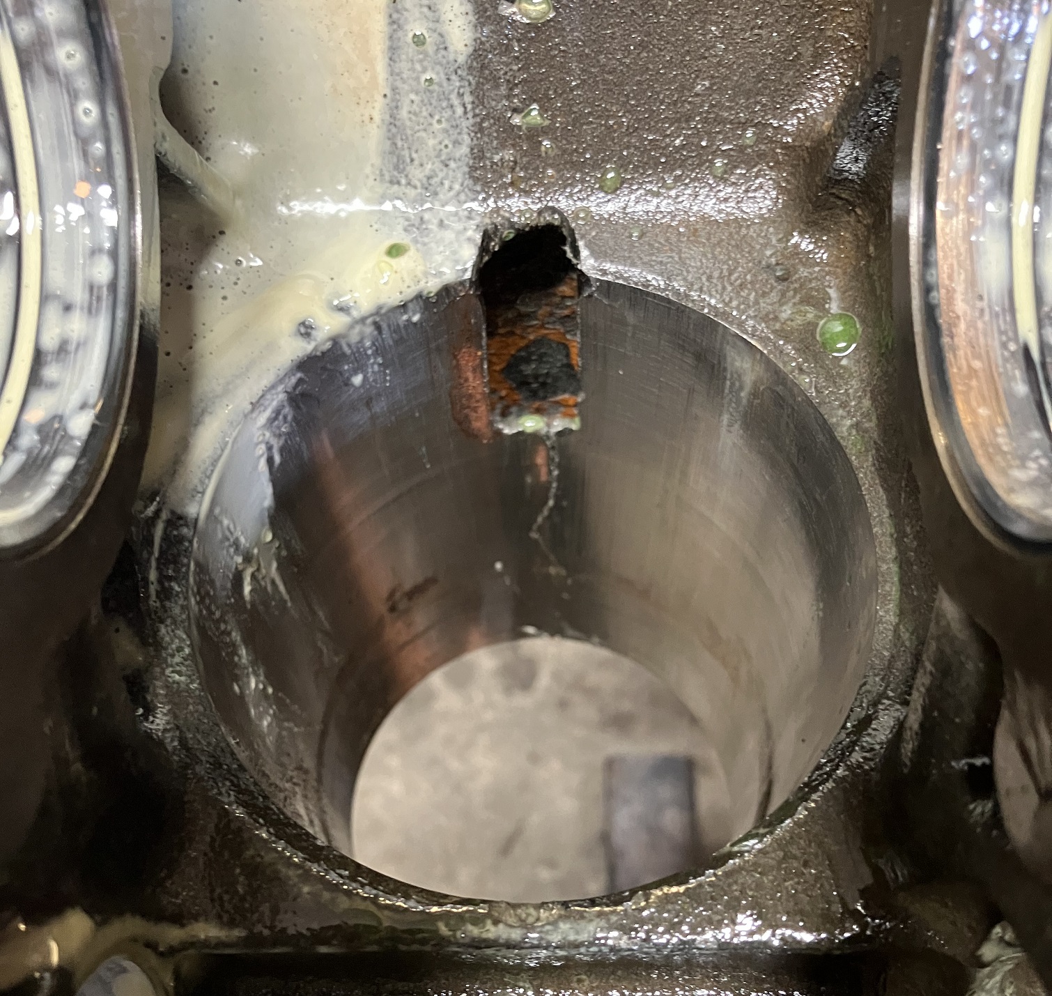

Clearly this is where the water came from
It looks like number 6 bearing wasn't far off following number 1 !!

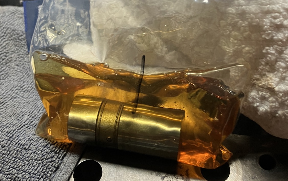

So i knew i needed to do some washing before everything started to rust! The lifters were a pain in the ass to pull apart and clean, but at $300 a set i didnt want to have to pay that twice!
Should be ready to drop in when the next engine is ready to go!

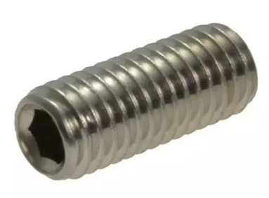

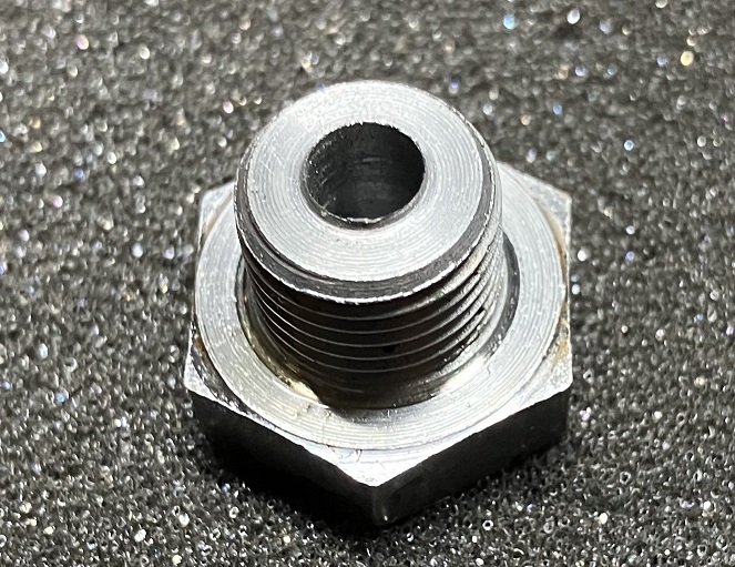

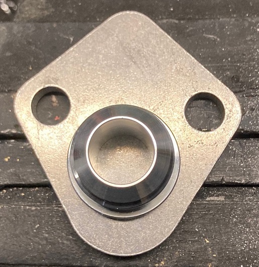

I've been doing some research on oil system mods for these things, so i will be drilling out some oil passages to be a bit larger and as well as that one common mod is to put a screw in the end of the oil pump to allow increasing the relief valve pressure which is hopefully all i'll need to do.

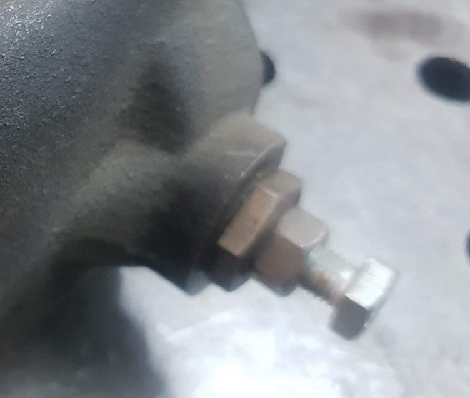

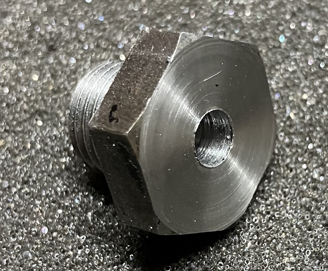

So i started doing what i could, machined the face of the bolt flat and drilled a small hole in it, next will be to tap it out.
This hole is basically the same size as the locating dowel that was on the end of this, the new grub screw will be a few mm larger, then it will get the locating dowel machined into its end.
This is what i purchased for it along with a matching lock nut.

@vlad - i have done a complete tear down, the block is empty. The only things i can find wrong are the fucked cylinder and some bearing wear on a few of the mains as well as the #6 rod end.
I have always been concerned with oil in this engine after my oil pressure gauge was going to zero on the dyno (almost zero by 4000rpm up to redline). i figured thought if it actually was it probably would have failed on the dyno, so i installed a oil pressure sensor into the data logger, it never went below 30psi in the logs. (so probably a bit low for safety!)
BUT .... the oil goes into the block around cylinder 4, then there is a main gallery running along the motor beside the lifters, which provides oil to them and also down to all the main bearings, then the mains feed the cam & rods, from what i understand too, the mains 1, 3, 5 have a second hole in them to feel oil to the cam bearings.
so 1 & 6 are not only at the ends of the engine (and the oil system), but 1 at least is also shared with a cam bearing, so potentially there is just not enough going to it. I've found a bit of info since which says to drill out a few passages in the block, namely the one from the pump to the main gallery, and then also to enlarge the passages going to the mains that feed cams also, so this all makes sense, hopefully between that and bumping the pressure up will solve the issue.
the only other thing i did wonder about is the external oil pickup i have, i did wonder if maybe i had it too close to the sump floor, but i have confirmed since stripping the motor that i can actually just fit my finger under it, so that should be plenty enough of a gap allow sufficient oil into it - i did also wonder about oil slosh on launch, but i saw this issue on the dyno so that rules out g-forces.
