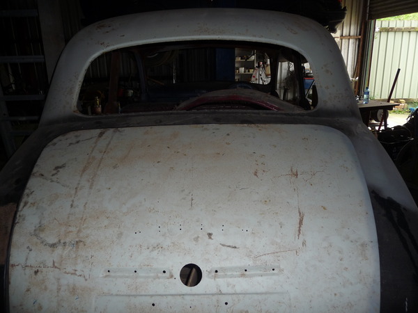

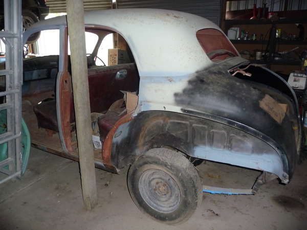

This has been in the planning stages for a while now, and in the want column for even longer! Finally last night the planets aligned and i have paid for this beast!
From what dad and i can see, this cars body is mint, the only one spot of rust we could find on it was about the size of 3 x 5c pieces lined up so for the age of the car its gold! The previous owner had planned to fit a L67 to it so there are a few mods in that regard but they will work for me anyways!
Obviously there is alot of work to be done but the plan is to cage it out and build it from the ground up to be legal for ANDRA Super Sedan (good for 9.00 - 1/4 mile) first time around unlike the Gemini.
