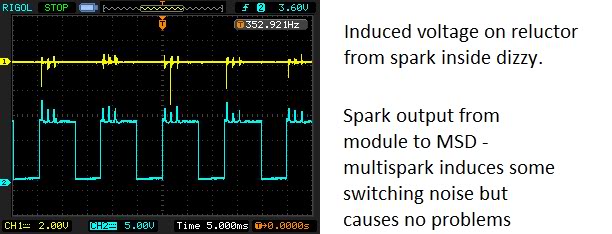

Interesting day of testing today. Had the reluctor test setup pictured above triggering the car - with a 12 tooth wheel we could easily test to 7kRPM. The spark plug firing into thin air sounded like a TIG! Injectors are noisy buggers too. Everything I scoped looked really good ...
Was at a bit of a loss but had suspected the CDI was inducing some interference in the reluctor signal inside the dizzy. So put the scope on the dizzy reluctor and span up the trigger simulator wheel. It was a full setup as we connected up the dizzy high voltage leads again (spark was being sent to one cyl as the engine was not turning), the dizzy reluctor was not used and with an engine thats not turning should just see a flat line. This is what we got...
So looks like the reluctor pickup is getting some nasty voltages on it and is probably false triggering from them.

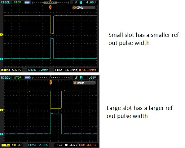

Also tested the theory of reluctor slot size vs ref out...

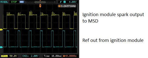

vn5000
- Posts: 551
- cars: vn v8 commodore
- Location: GOLD COAST QLD
Re: The Val
The multi spark looks like it is producing multiple sparks for about 4ms.When a v8 is spinning 6000rpm it is producing 400 sparks per sec,which means it has 2.5 ms to turn coil on and off. if the msd is sparking for 4ms after each trigger then it would be on constantly at high speed(just a theory as i havent had any experience with msd).Also to me the freqency and wavelength dont seem to match on your scope.
