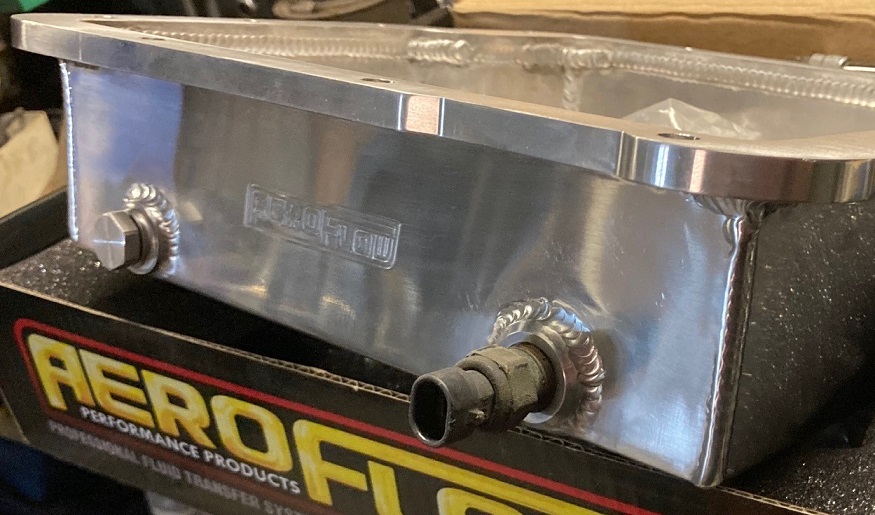

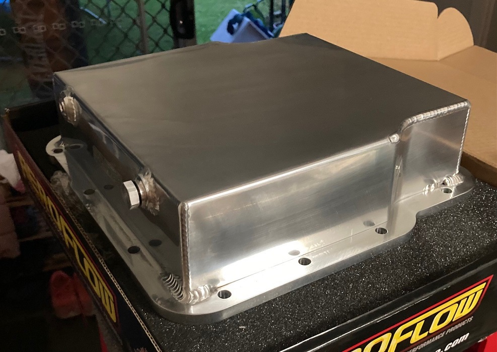

so first thing was i have constantly had oil leaks from the trimatic pan, and the main cause of this is the pressed steel pan rail, it just cuts the gasket if you tighten it too much, and if you dont do that it just leaks ... so screwed either way.... so i decided to bite the bullet and get an alloy pan with a 10mm rail on it, and i figure the extra oil capacity can't hurt at all!
So as it turns out this pan also comes with a second fitting, which is the right thread to suit an Ecotec V6 coolant temp sensor, so i'll be adding that into my data logging just cause i can!

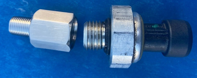

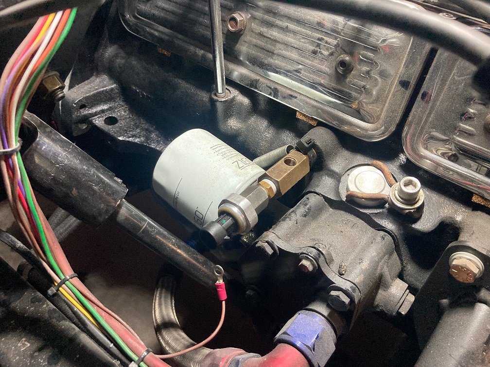

Next on the list i wanted to get an oil pressure sensor on the engine that i can see in data logs, so i found the right adaptor needed to use an Alloytec V6 oil pressure sensor that i already had.
I now just need a T piece out of the brass adaptor, which will feed my turbo and T off to the dash gauge sensor, this also works out well as the dash gauge sensor is really big and almost hit on the side of the oil pump, so things fit a bit nicer this way.

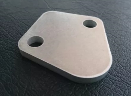

I also had issues of the dipstick tube blowing out some oil, not much but i don't want any to leak so i determined its probably in need of a crank case breather, so i have ordered this alloy fuel pump blank off plate, to which i will weld an alloy speedflow -12 fitting, then i can run this up to my oil catch can - speedflow parts are in the post as we speak!

Nice pan :thumbup:
