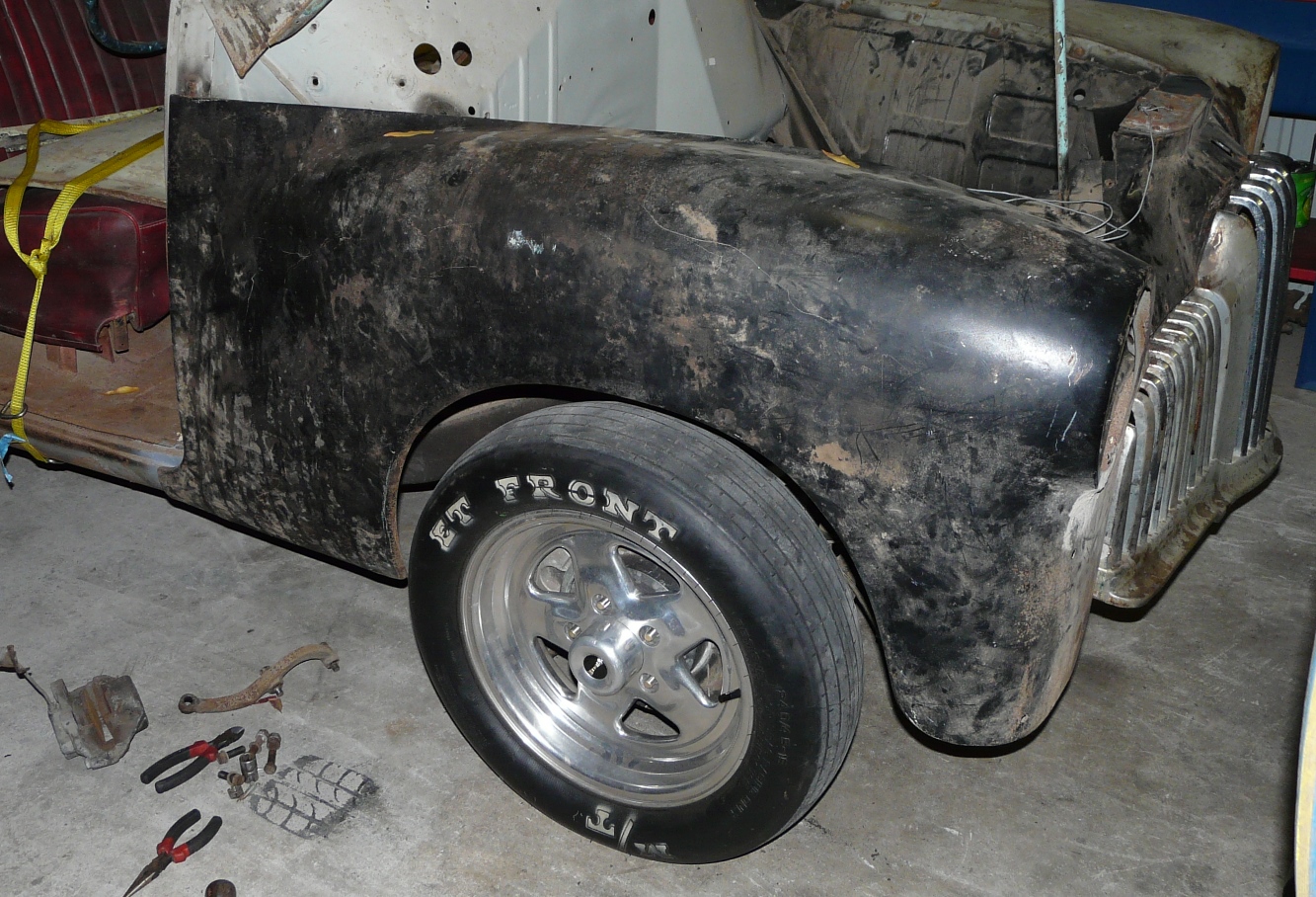

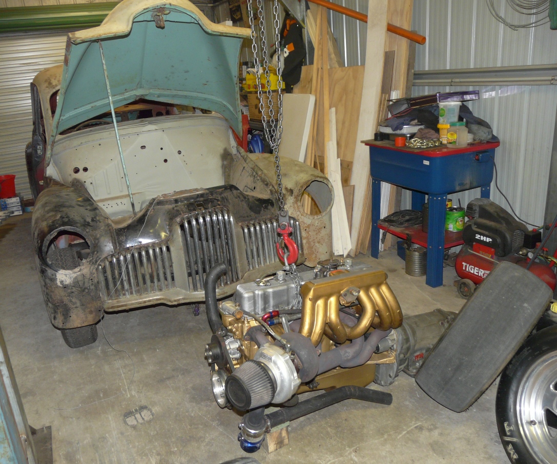

Got the car in my shed today and the gemini is out at my brothers place now (its new owner).
also started fitting the hoppers stoppers big brakes I have so then I could mount the front runners and see how they fit offset wise!

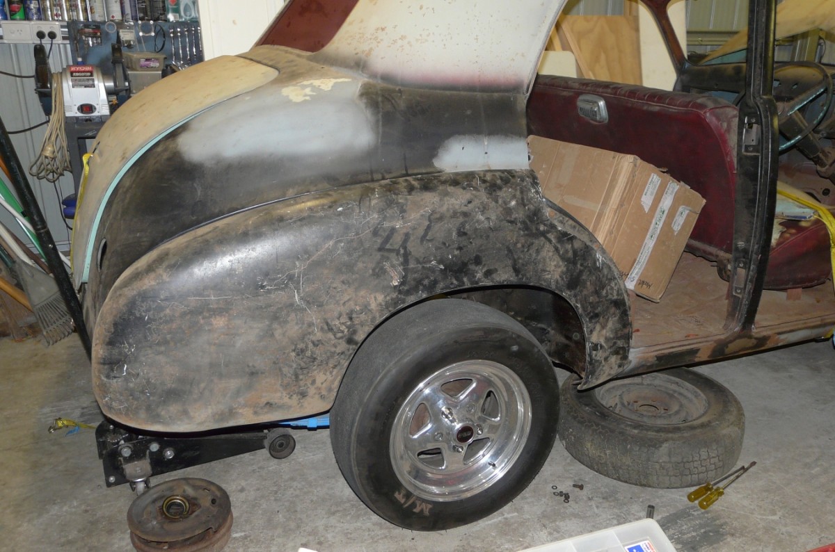

and dummied up a commodore axle in the original diff housing to see how it all fitted, will need the diff to be a bit wider to get the rim centred in the guard a bit better then I should be able to run a 10 inch slick no worries
(current tyre is 8 inch)
once I work out that side of things i'll make a start on cutting down a commodore diff for it....
also in the debating stage of cutting into the firewall to recess the motor in a few inches, basically need to do it to fit everything, it will be better for weight distribution, and so the question is how far, I want to go back as far as I can as then I can fit decent radiator and thermos fans etc ...
anyways lots of fun to be had, but so far enjoying the change of scenery in the shed

- Posts: 5638
when i mounted my v6 i lined number 1 plug up with front axle centreline to get the weight back wished i had 4 wheel scales at the time to see what difference it really made

yeah I want to get it back a fair bit so I can fit a decent radiator and Mondeo twin thermos but I don't want to go back too far or it will be a pain to get at the rear exhaust bolts and the EFI manifold will hit
back is good for sump clearance too aim for low on the engine bay too the lower the better.
yep that's the plan, I'm going to have solid engine mounts so I should be able to get the sump pretty close to the cross member without fear of hitting!

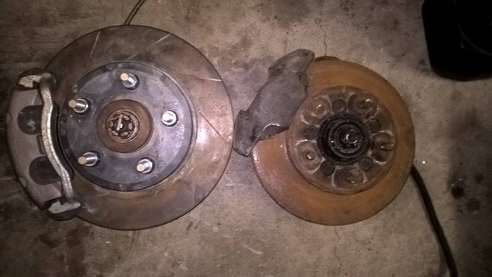

HR brakes V's Hoppers Stoppers kit
