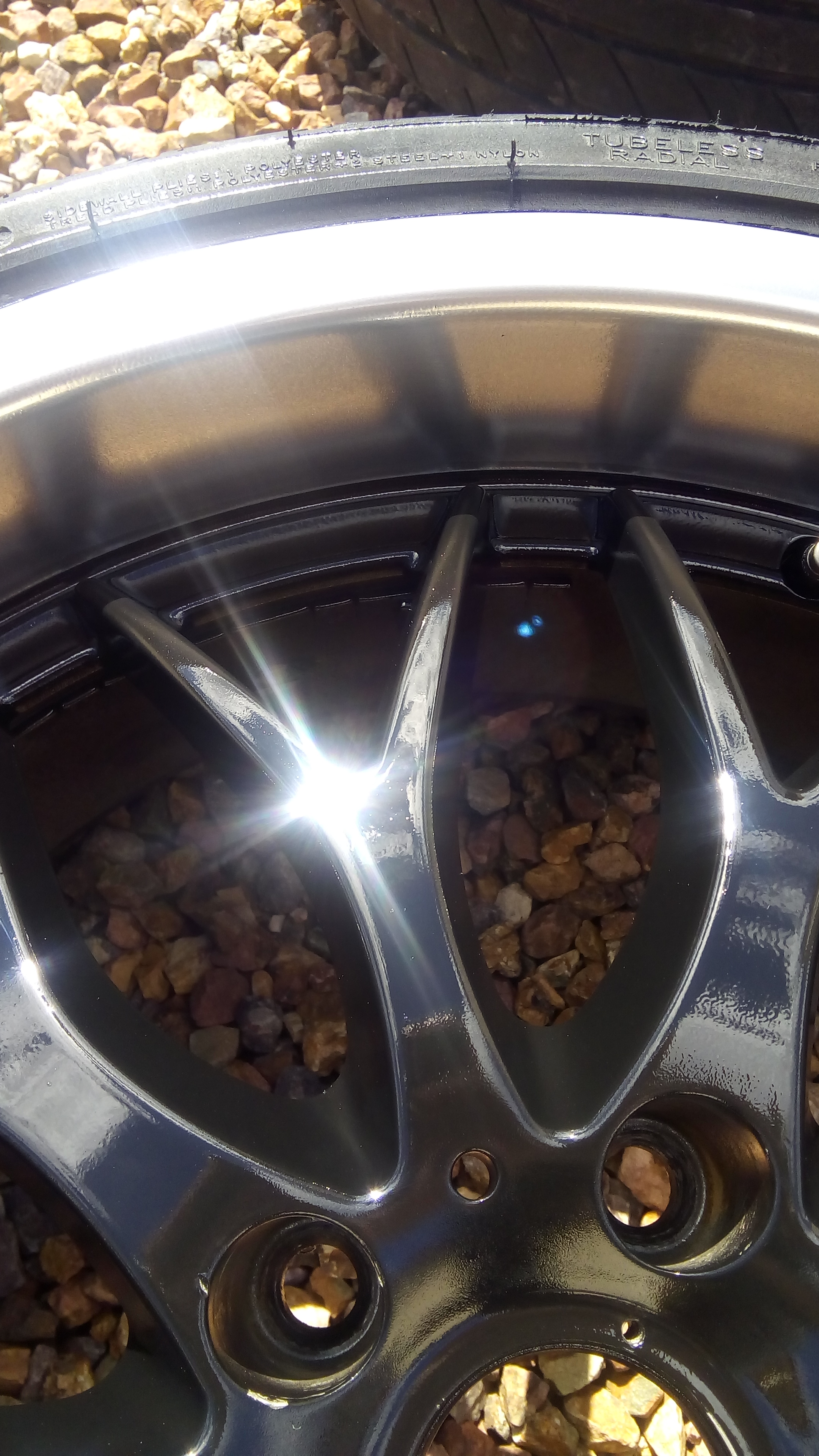

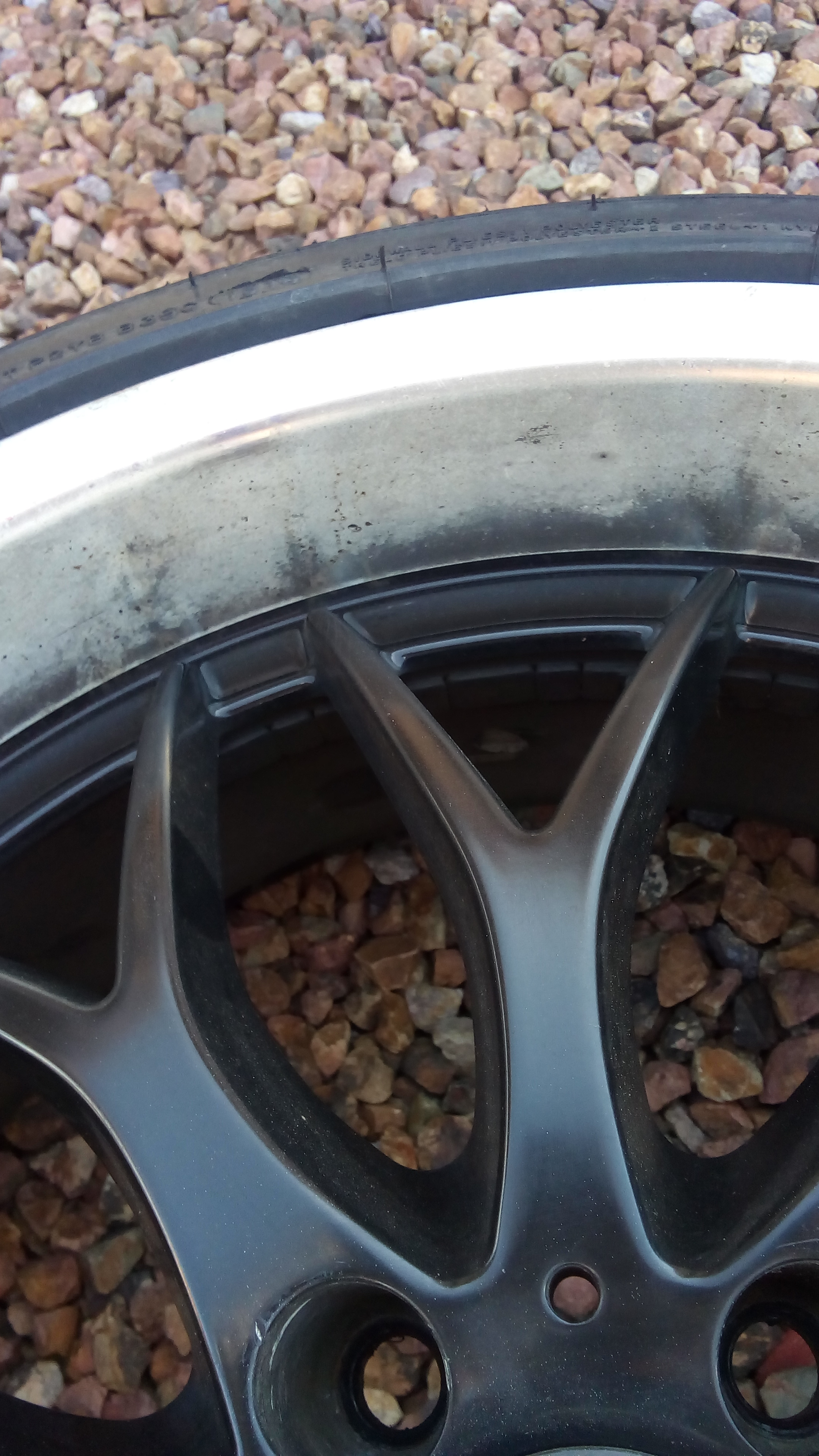

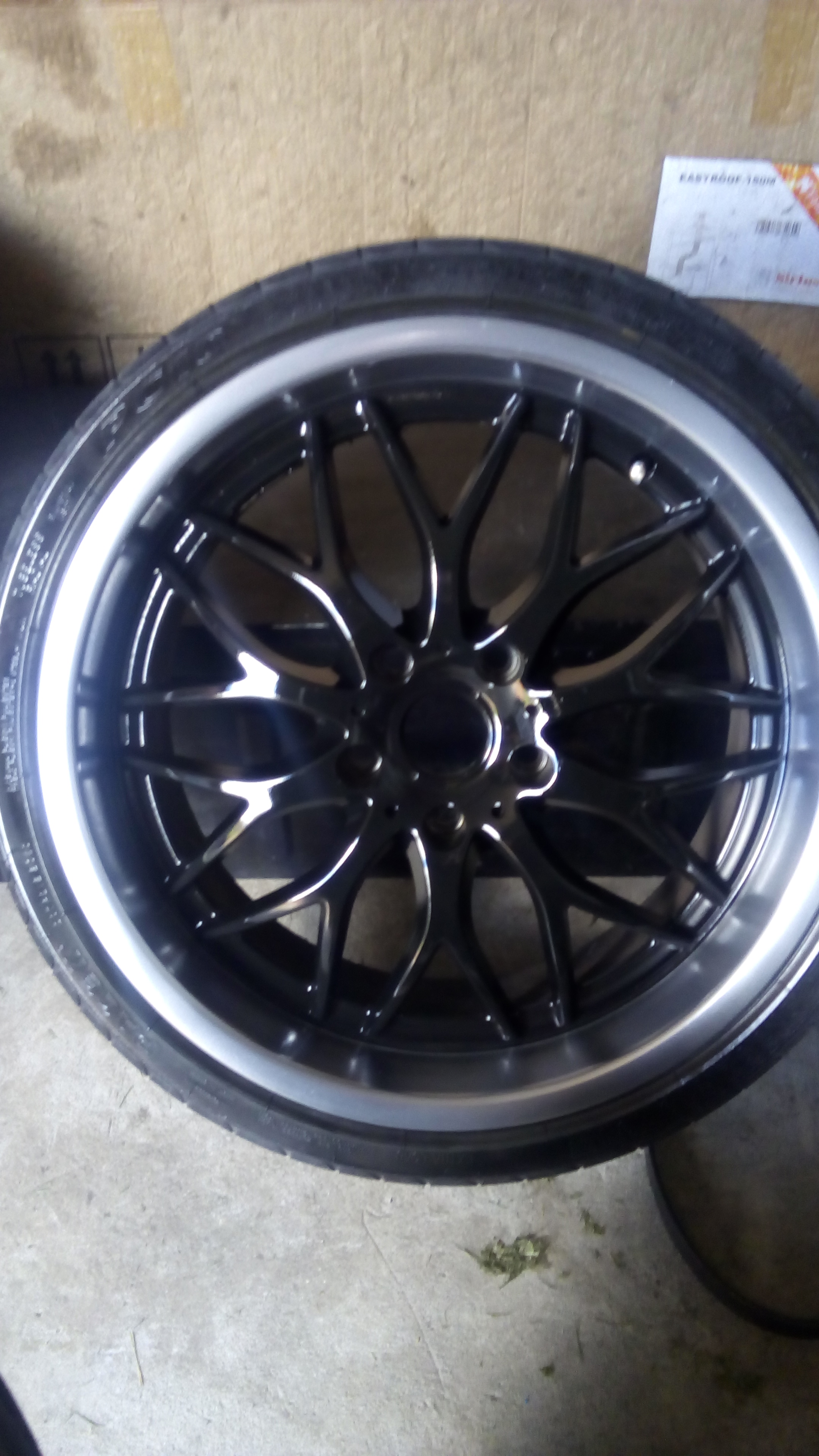

I have set IAC steps to 10 but haven't been driving yet because I have no wheels on, I have been restoring them back to there former glory.
Before After
Before After

Nice work what was the process you used to get them looking that good?
Re: VP V6 Calais
Removal of clear coating on the chrome only I used wet and dry 180 grit until all clear was removed.
Time to remove the scratches the 180 grit left behind i started with 320 then 800 sand paper was dry then i finished off with 1500 wet you can use 2000 or finer if you want.
Now the black I used a chux heavy duty scourer pads all you want to do is rough up the clear to give the new clear something to stick too, time to give the wheels a wash and let dry.
Now it's time to polish the metal I use autosol tube stuff now you see all that hard work sanding pay off, once you finished polishing it's time to wash and let dry again now put the wheels where your going to clear coat them, and give them a wipe over with grease and wax remover and lint free cloth.
Clear coat time I just use 2k high gloss clear coat purchased from a automotive paint supplier's I used 2 cans on all 4 wheels. ( Wear a approved safety mask when spraying this stuff )
My total cost was only $150 much cheaper than new wheels.
