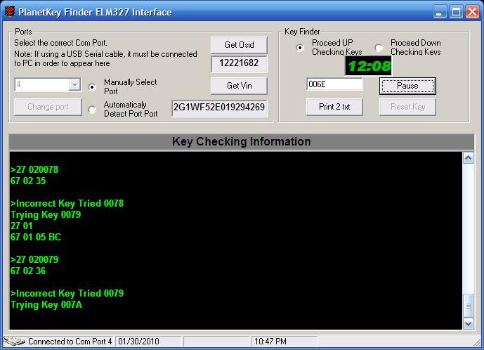

I used the 09 02 comand to get VIN
I now have the issue with dropping 0s fixed, Timers sometimes skips a few seconds, but hey when dealing with Hours or possibly days a few seconds is not much lol.
I have the OSID retrieved along with the VIN.
Anyone interested in the program? I will upload if its allowed.

Think I uploaded in correct spot, tool development section.
Looking for any/all feedback.
