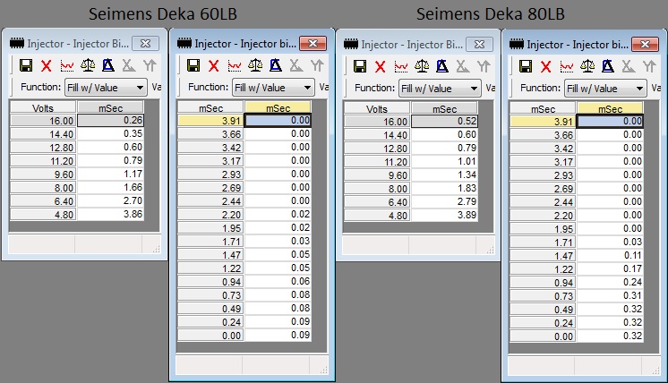

You list "Injector Battery Offset" above, what does it alter?
Re: 102 - Advanced Tuning Of A Delco ECM with $12P
The fuel delivery will vary with battery voltage, so there are a couple of tables to correct for this...
"Injector - Injector Bias vs ADINJ" is to correct the opening and closing time of the injector with respect to battery voltage.
"Voltage compensation vs Battery voltage" is to allow for the fuel pump speed variation with respect to battery voltage.
Posts: 10435
so this is an offset in mS. Theres part of the injector opening time when it will not flow fuel but this is part of the mS pulse, so different injectors or the lower the battery voltage usually means this time is increased .... long story short, in my case I replaced 19lb stock injectors with 80lb garden hose fittings and this table is up to shit!
you can usually find a graph or similar from manufacturers showing the voltage offsets to put into this table, and at worst case scenario you need to do a bit of fiddling in a spreadsheet to get the numbers that line up with the scale in the delco table ....
that said if you alternator is ALWAYS charging at 14.2v for example and you tune it there it should always be right ... this issue only comes into play mainly when you have a dodgy regulator or heat soak etc (which is probably more than likely regulator anyways) but issues aside, its like everything else, you want to have the right numbers in there to stop having anything being fudged because we all know the more you fudge the more you get dodgy results!
here is an example of the stock $12P table (the bottom one and red on the graph) compared to the info I got from Siemens for my injectors.
(Incorrect information removed and re-posted below)
its fairly clear that theres a huge difference in injector flows at different voltage and the fact that at 14.4v theres nearly double the mS difference, that's huge!
its worth noting that this difference is not necessarily about the flow of the injectors its more about their design and efficiency.

I'll have to track down some info for the Siemens 60lb units that we are using in the Dato.
Could this have an effect on cold start? (as the starter is sucking up lots of power.)

I would like to correct the previous post above with the injector offsets, they are not quite correct, so I have listed below what I believe to be the correct ones for both 60 and 80lb seimens dekas!
Edit by Antus: The first table pictured is "Injector - Injector Bias vs Battery Voltage" and the second "Injector - Injector bias add-on vs Injector pulse width". Also note Holden202T has configured the tables to display the other way around, make the values on the left hand side line up when using this information.
please note, these are the two tables in $12P ... other code bases might have different labels or such.
