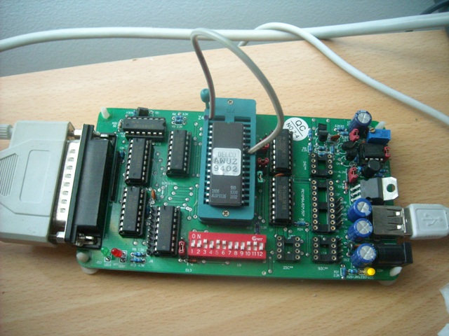

I've hit a snag with erasing the 27SF512 chips. I put them in the burner checking that it is set on the correct chip,part the way through the erase this message appears "Move jumper for erase W27Exxx and setting Vpp 12.75v" I've looked through the program & can't find what it's asking for. Any help with my previous post will be most appreciated.

on my willem, that message is when I add or remove my manual wire jumper from ZIF pin1 to ZIF pin 23.

Jumper wire?Jayme wrote:on my willem, that message is when I add or remove my manual wire jumper from ZIF pin1 to ZIF pin 23.

this is what I mean. it is the only way I can erase these things. some of the old ones take ages to erase, but new ones are instant.

Thanks Jayme I'll try that & see if it works
