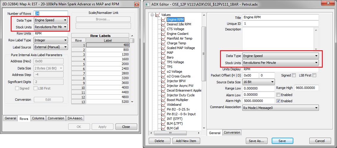

You probably need to link the ADX and XDF data items. TP needs to know the type of data in the table (edit the XDF table, and under each axis there is a data type), and then edit the ADX to change the item (say airflow) to the same type of data.

Yeah I think its just the way the calcs are setup it could also be written as 14.250 * 0.8312 * 0.9550 + 0.055 = 11.36AFR by using the reciprocal to make it a multiply (1/1.203=0.8312)
This is what needs to be setup. On the left is the XDF item (select the table and press F2), under the column and row setup you must match the Data Type and Stock Units to the ADX setup for the two axis. To change the ADX select Aquisition and then edit definition, under the values heading you can find what items are logged. So for the RPM vs Airflow table choose engine RPM and make the Data Type and Stock Units the same as your XDF item rows, then find the MAF airflow item and match the Data Type and Stock Units to the XDF column settings.
