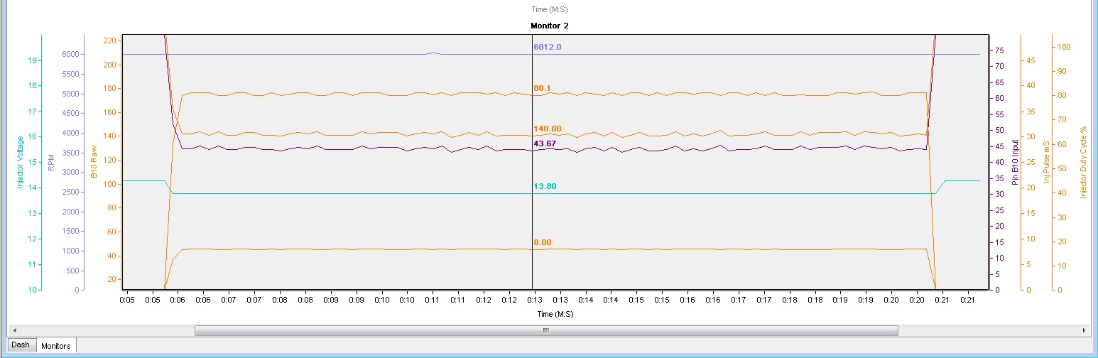

test run, holds pressure ok with a set of 42lb injectors, biggest i have atm. B10 is the fuel pressure. Will need to try higher pressure and see how it goes.

It is a very impressive set up with results to match

nice and steady that.
Re: Injector Flow Testing Data
be interesting to see how the pump holds up to the ID1000's
will be interesting, 044 wont handle them for sure but interesting to see what it can supply.
