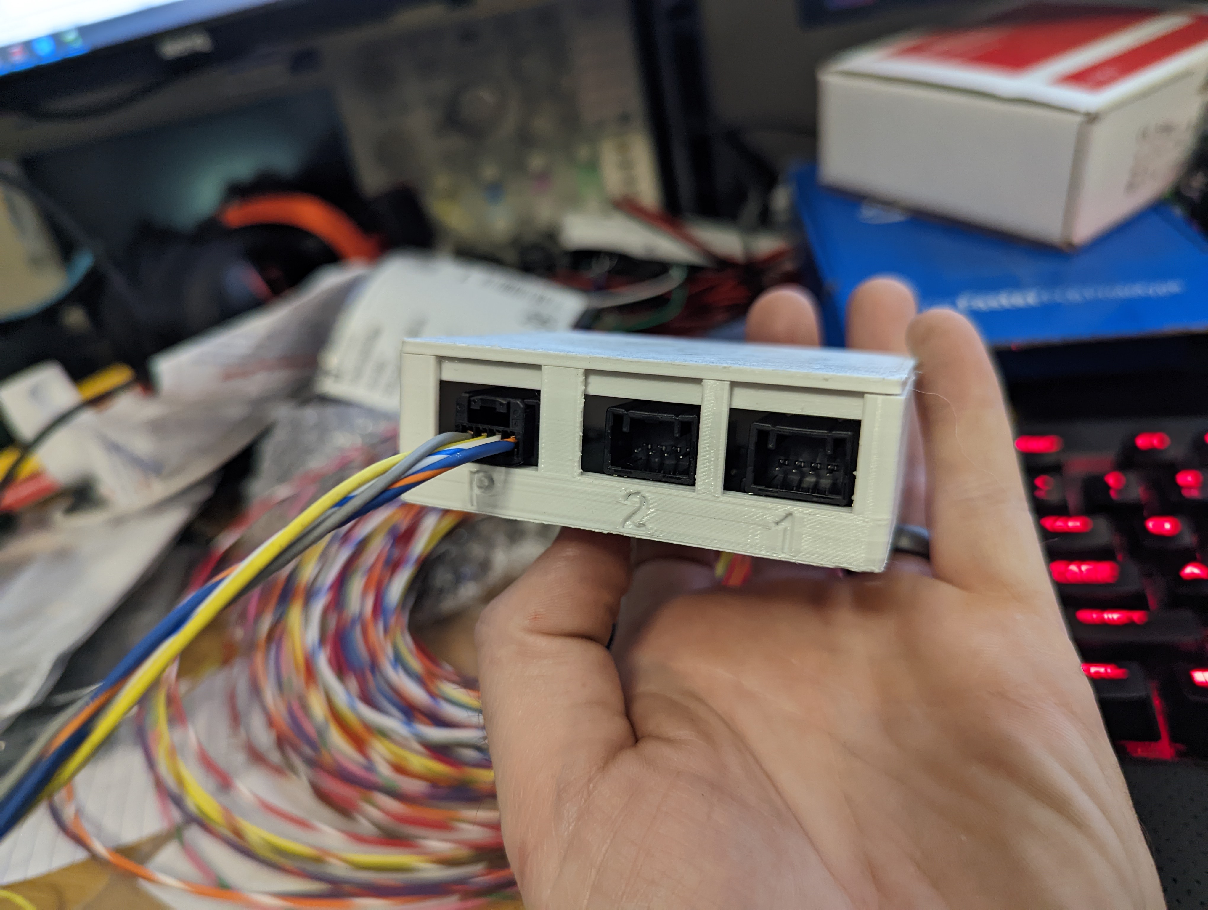

Well i finally connected it up to my bench ECU to start testing it. 3D printed a little box for it.
Turns out the O2 signal and ground reference are isolated. So i need to ground the O2 low references to the output to get any data.
Checked for any biasing circuit that might cause issues shorting low ref to ground and see no DC current generated. So it should be safe to simply ground the HO2S low references for the secondaries to ground.
Edit: Finished connecting and testing on the bench ECU. So a few things to note:
1) The O2 sensor's low references are isolated and not by default referenced to anything. You must supply the low reference, and it is not internally connected to ground.
2) The O2 ADC seems to sample up to 1.107V where it caps out.
3) Hard to say for sure the resolution since there are 2 PIDs that HPT shows. One (2 byte PID) gives 0.005v resolution. The other (1 byte PID) gives 0.004v resolution.
4) There does not appear to be any form of filtering on the O2 input, as it bounces around a lot even on a bench harness. The noise is basically 1 step/lsb of resolution.
5) The internal 450 mV bias on the input pin does not appear to source or sink any current, so this leads me to believe they're using an op amp to buffer in the input with a biasing network.
I also was able to grab the PIDs and do some sniffing to figure out the conversion. It's very strange. 0x00 = 0V. 0xFF = 1.107 V.

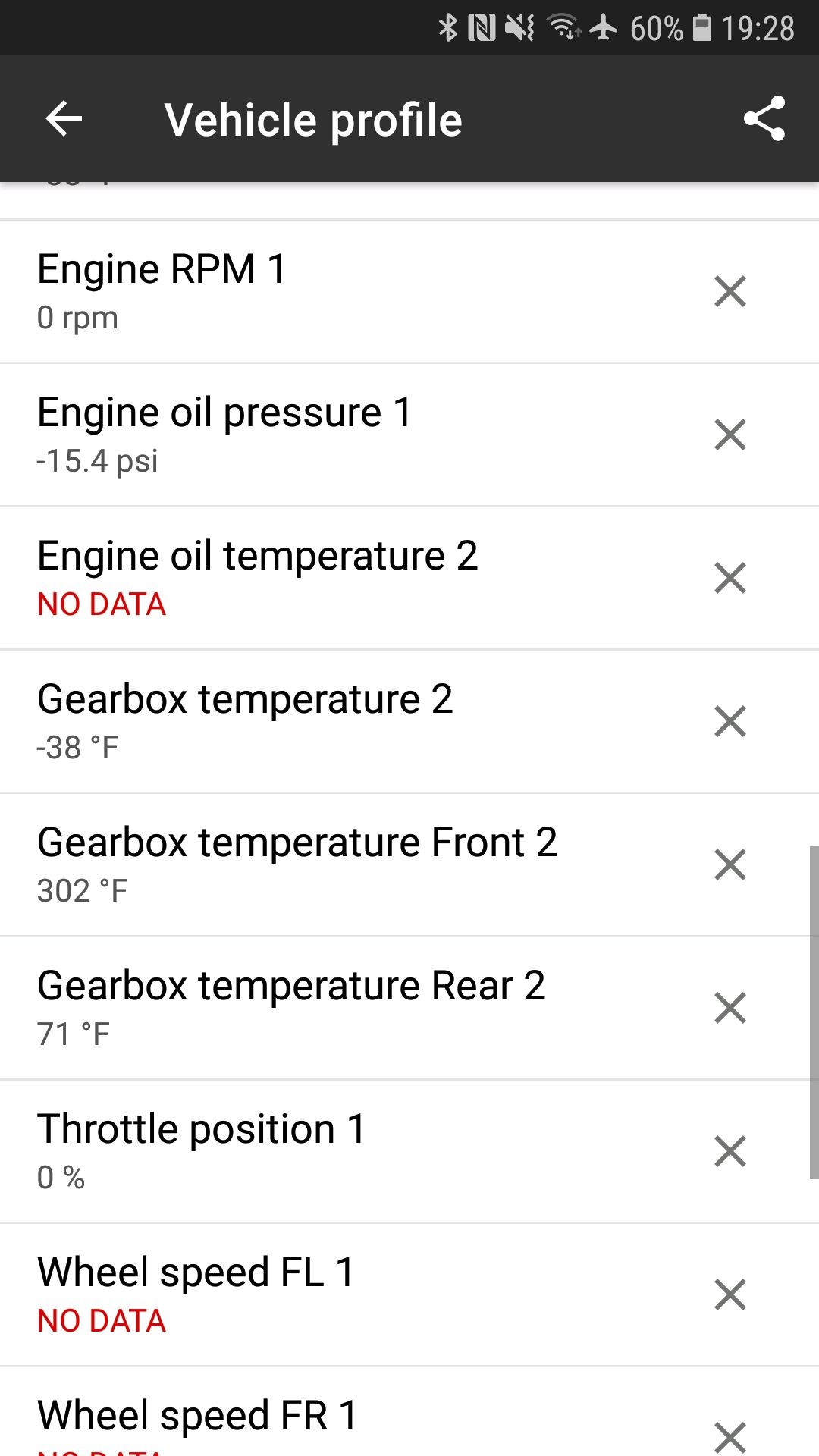

On track yesterday, today and tomorrow in the new setup for my C5Z testing this box. It works great. Surprisingly well honestly.
Fwiw the setup is a 2001 Corvette. 468 stroker with factory ECU. Dailey dry sump and and trans/diff coolers.
This box was used to log temp data using these extra channels.
