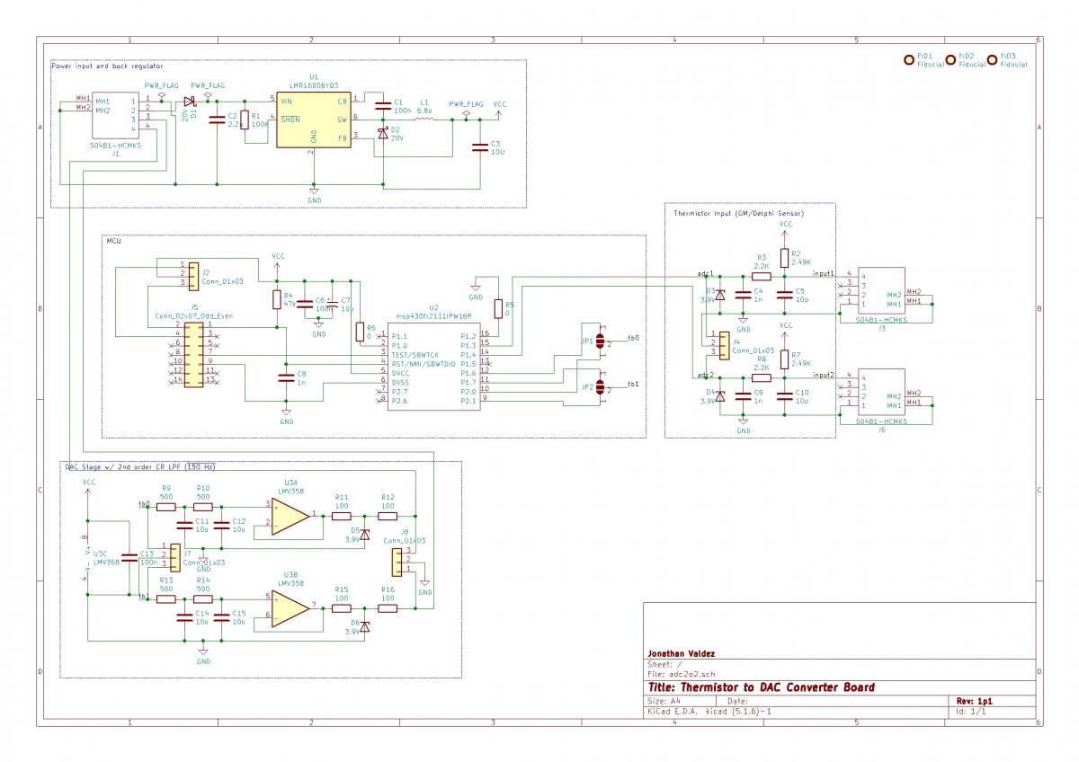

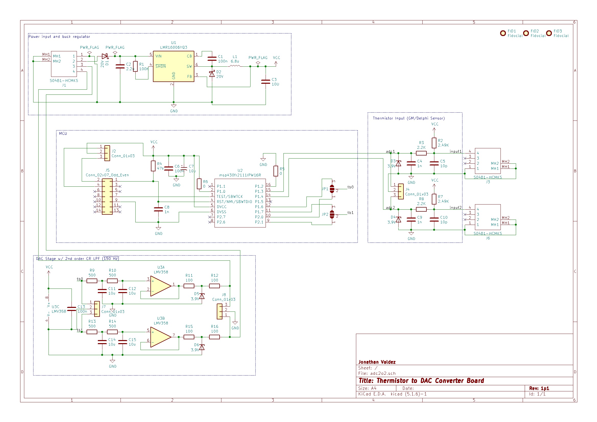

Hey there all,
decided to use this as a place to put this tool development notes and what not.
What does the tool do:
This tool is designed to take 2 separate inputs for fluid thermistors (specifically GM/Delphi thermistors), and output an analog voltage to the ECU for datalogging over the unused secondary O2 sensor inputs.
Why?
Most C5s that get tracked seriously will not have catalytic converters, and the O2 sensors for the post-cat sensors are not connected or installed. The OEM ECU doesn't have many inputs that can be used to recording voltage via OBD logging tools (such as race chrono, for lap data acquisition). This is an idea I had to convert the 2 unused O2 post-cat O2 sensor inputs to temp sensor inputs that I could datalog the voltage for and then convert the voltage back to temperature.
For me, I'm wanting to use these inputs to record differential and transmission temperatures in race chrono by datalogging the post-cat O2 voltages and doing some math on them to derive the temperature.
The challenges:
The O2 sensor input range is 0 to 1 V, so the range is fairly narrow. There also is typically some sort of biasing network with an op amp to 450 mV. I don't believe this to be a problem if you have a strong enough output driver. The other challenge is that finding a purely analog way to convert the resistance to a predictable output voltage that linearized temperature readings was extremely difficult. Due to this, I opted to add a small MCU that would sample the resistance value, calculate the resistance and then could determine the temperature and generate a PWM output that could be filtered to be make an analog DC output voltage.
There are 2 parts to this project: The schematic/board, and the firmware for the MCU.
Circuit design: I cranked this design out in about 1 hour. It has 4 main components
[*]Power stage: Take 4-28V DC input and regulate it down to 3.3V for MCU and component use
[*]Thermistor analog front end: A simple voltage divider network to sample the thermistor resistance, as well as provide some protection to the MCU I/Os
[*]MCU: The MSP430FR2111 is the brains of the board, sampling the resistance input and generating a PWM output
[*]DAC: Using a 10-bit PWM timer with a 2nd order low pass filter set below 150 Hz to generate a buffered DC analog voltage that the ECU can understand
The power stage uses a DC/DC buck regulator (TI LMR16006YQ3). This is capable of taking all input voltages from 4 V to 40 V and regulating it down to a 3.3V output efficiently. An LDO would generate too much heat due to the power draw of the op amps. It also features a schottky diode to provide reverse battery protection up to 20V (flipped power and ground wires).
The thermistor analog front end uses a 2.49K pull up resistor to 3.3V. This value is selected because this is the nominal value of a delphi temperature sensor at room temp (25C). It provides decent voltage range across temperature that the MCU should be able to sample. The 2.2K series resistor with 1nF capacitor is used to provide a current limiting functionality for over-voltage conditions where the ESD cell will trigger. While it technically provides a low pass filter functionality (-3 DB at ~78 kHz), that is not the primary function). There is a 3.9V zener diode designed to provide protection for the IOs in over-voltage conditions. This will require some testing, the datasheets show that it could have leakages as high as 10 uA at 1V, which would introduce a fairly large sampling error. I will play with this when I get the system in. It might end up being DNPed.
The MCU hardware is fairly simply. It has the standard decoupling capacitors needed, as well as a SPI By Wire (2 wire JTAG like programming interface TI uses) header for debug/programming. P1.3 and P1.4 are used as ADC inputs in the MCU (10-bit ADC right now, but it supports 12-bit. This will be something I have to test). The MCU utilizes P1.0 and P1.2 as ADC reference inputs (at least the option to). There are 2 pairs of outputs for the GPIO usage. P1.6/P2.0 and P1.7/P2.1. These pins are used by the timer module to generate a PWM output. Using the solder/bridge input for 2 GPIO to 1 output gives me the flexibility to choose different GPIOs if needed (due to functionality needs).
DAC stage is the more interesting part of the circuit. The target PWM frequency at 10-bit resolution will be somewhere in the 2 to 8 kHz range. We obviously do not want to see the on/off switching of the GPIO at the ECU. Utilizing a 2nd order low pass filter with a cut off frequency of about 30 Hz. Selecting the resistance and capacitance values is fairly straight forward, but the goal is to keep resistance low enough such that the series resistance does not affect the voltage seen by the buffer too much (since all op amps have an input bias current, which is the amount of current they "consume" on the + or - pins). The other balancing act is keeping capacitors small enough to fit on the board with ease. The output of the 2nd stage low pass filter is fed into a non-inverting op amp (the LMV358, a dual channel op amp package supporting 3.3V single ended supply with rail-to-rail capabilities). The Op amp is another choice because I need an op amp that can be supplied with a 0V and 3.3V input (instead of the usual +/- supply requirements) and can drive rail to rail. The output of the op amp has 2 100-ohm series resistors and a clamping zener diode to provide some protection to the op amp's driver, since this pin will be directly connected to a long wire that runs to the ECU.

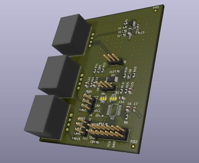

Cranking out a quick and dirty layout in 1-2 hours resulted in this: It's far from ideal, with the long narrow power wire trace that breaks up the ground plane, but it is a 2 layer board that's small and meets the requirements for JLCPCB's $2/5 board manufacturing. We'll see how it performs.

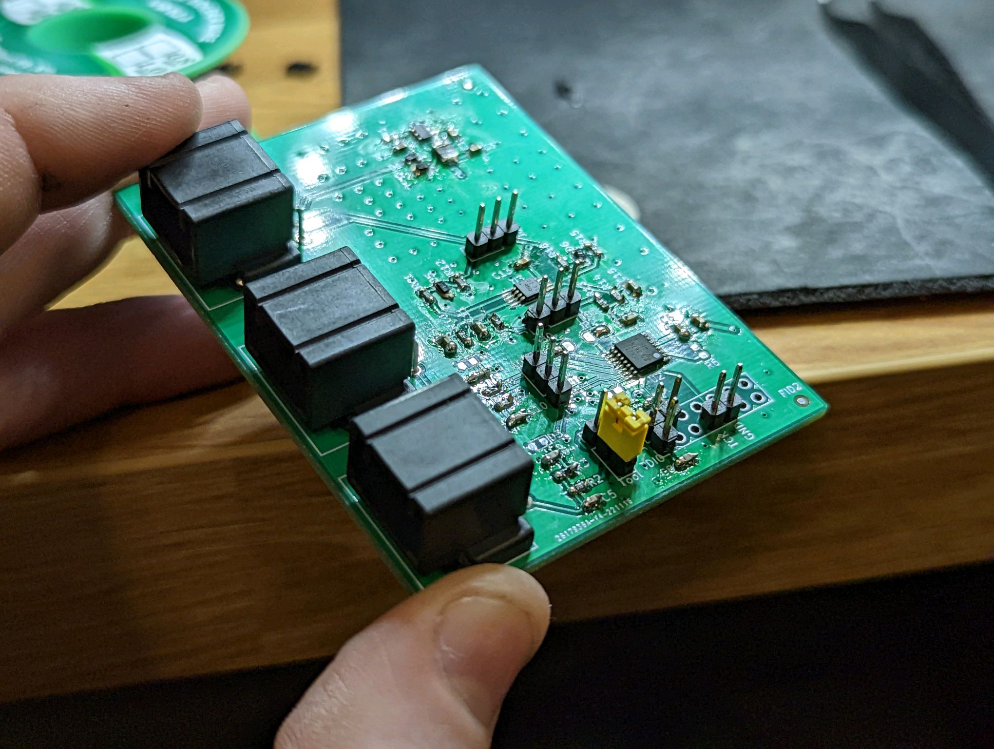

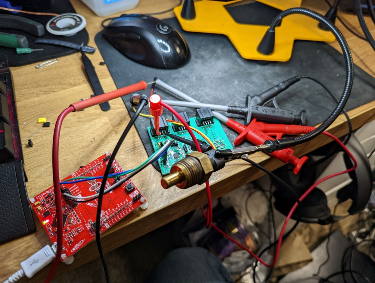

Got the prototype boards in and assembled them. Realized that 0603 components might have been a mistake with your standard home soldering equipment lol. I do it all the time at work but don't have a great setup at home.
Here's a quick and dirty setup using the C5 transmission thermistor I had laying around.
Flashed the board and to my surprise everything seems to be working. Checked resistance of thermistor with multimeter, then checked it with the MCU at a breakpoint. You can see the measured resistance. Then it calls a function to look up the temp. From that point it goes through another function which takes some defines that defines the lower and upper limits for voltage and temp output to determine the output target voltage to send to the ECU. Here we see 2 waveforms. The raw GPIO PWM output from the MCU (at 1 khz) and the 2nd order low pass filter output in blue.
The MCU binary size is pretty close to the limit of this MCU though... However, it works.
Wonder if it makes sense to rev the board for bigger footprint SMD components for easier soldering and possibly to accept other inputs (such as a voltage input or something).
Next step: To make sure an MCU can actually see this input as expected so that we can datalog it.
. It's ugly but it's together.Here's a quick and dirty setup using the C5 transmission thermistor I had laying around.
