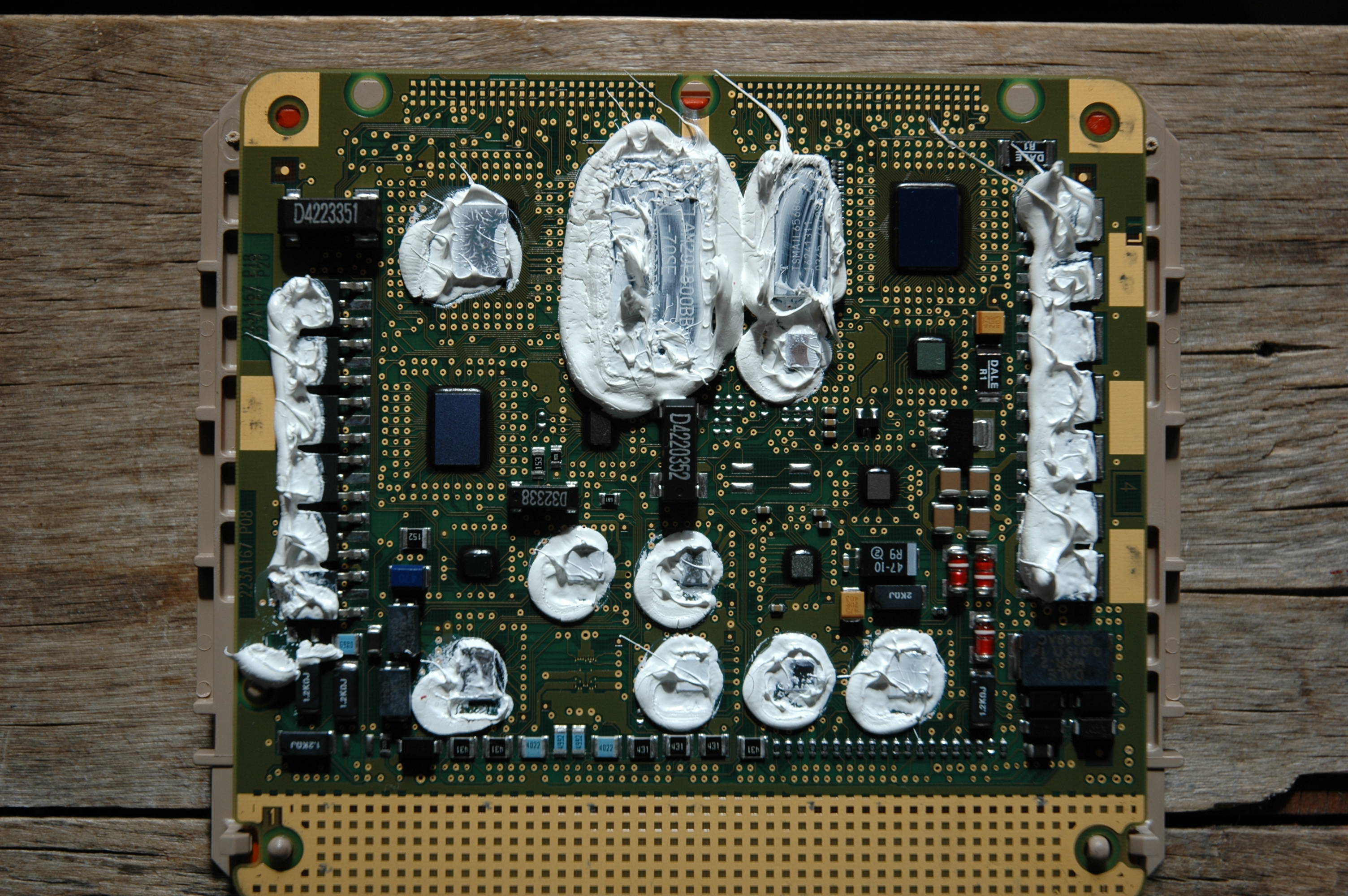

Re: PCM Hammer fails on P12
Inside of a 2003 l6 4.2 pcm.
Uses 1mb chip but bin is 512kb, There is also some slave file $C000 size.
It looks like the second part of chip [upper 512kb bytes] are referenced in code, but can`t be read from memory. Maybe shared with other cpu or bankswitched somehow. The slave is also loaded somewhere. Starting at $10000 but again couldn`t figure yet where it is in memory layout.
A real dump of full chip will help alot how memory is organized.
SLave ram is at 80 00 00 address.
It can take multipart flash routines if they are between ffa000 and ffe000.
main cpu ID is 10
slave ID is 17
It also can take some slave flash routine that is loaded at ff8xxx and is max $600 bytes long. But seems unused with factory tools. Maybe some underground equipment ready.
Reading of 512kb bin part is easy. The main difference between ls1 reading is the COP, needs to keep slave quiet.
AWESOME!
Thank you very much kur4o, the community really appreciates your efforts!
So they are physically very different as well ...
What a funky looking little ECU!
What is the CPU number? if its identifiable?
Im going to guess a 68k variant like all of the other VPW platforms. Would be good to confirm, though.
And so much potting compound sprinkled around the board - it can only mean that this board runs hot in all of those places. They must be buying the stuff in railroad tank car amounts.
Rick
Rick
IMO it's Thermal Paste and I agree they sure do pour it on when a little dab will do!
