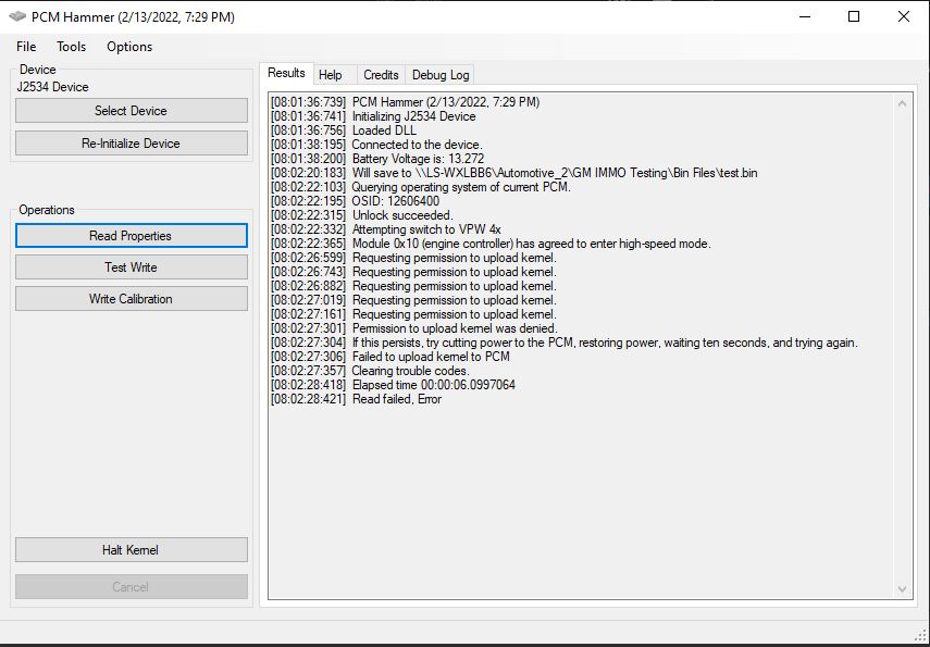

Maybe this has been asked before and I missed it, but I am trying to read the flash from a P12 PCM. Everything works exactly as if reading an LS PCM up to the point where it uploads the kernel and then it is denied. Is there anything that fix that? I also have much interest in reading flash from a P10 PCM as well. I have included a screenshot of the error with the P12. Thank you in advance and awesome work.

Sorry, the PCMHammer suite works only with the P01 and P59 at this point in time ...
No one has stepped up to the plate to add other VPW speaking units ...
The source code is here: LegacyNsfw/PcmHacks If you (or someone you know) has the skills to add them.

Even if the kernel could be uploaded successfully, I'd be surprised if it worked on anything but a P01 or P59. To support other PCMs, we need to know:
* which address to upload the kernel to
* the addresses of the registers that the CPU uses to communicate to the VPW chip
* the ID of the flash chip, so that we can find out how to write to it
And if the VPW chip isn't the same in the other PCMs, someone will have to figure that out as well.
The P04 has some quirks in the way the kernel gets uploaded that will require making the kernel much smaller, possibly using two kernels.
None of this is impossible but it takes time and effort to figure it out. And some times it takes a lot of trial-and-error.
