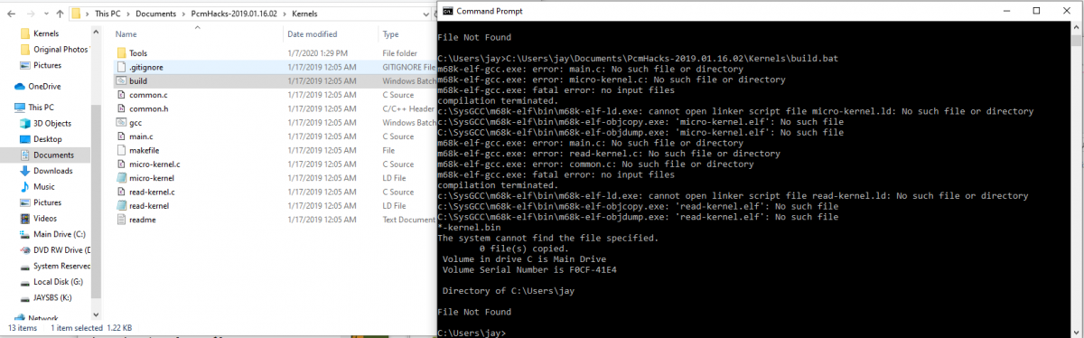

everything is right where it should be, this is really annoying. anyone else wanna try compliling it ill drop it in a zip

Slick as snot ...Vampyre wrote:everything is right where it should be, this is really annoying. anyone else wanna try compliling it ill drop it in a zip
That image shows your current directory being "C:\Users\Jay", you need to change directories to the "PcmHacks\Kernels" directory. [edit]
Shame on me, I missed it previously ...
My bad, I apologize, I should have caught that!Vampyre wrote:tried to rebuild read_kernel and now i get this but all files are in the folder
C:\>C:\Users\vampy\Documents\PcmHacks-2019.01.16.02\PcmHacks-2019.01.16.02\Kernels\build.bat
