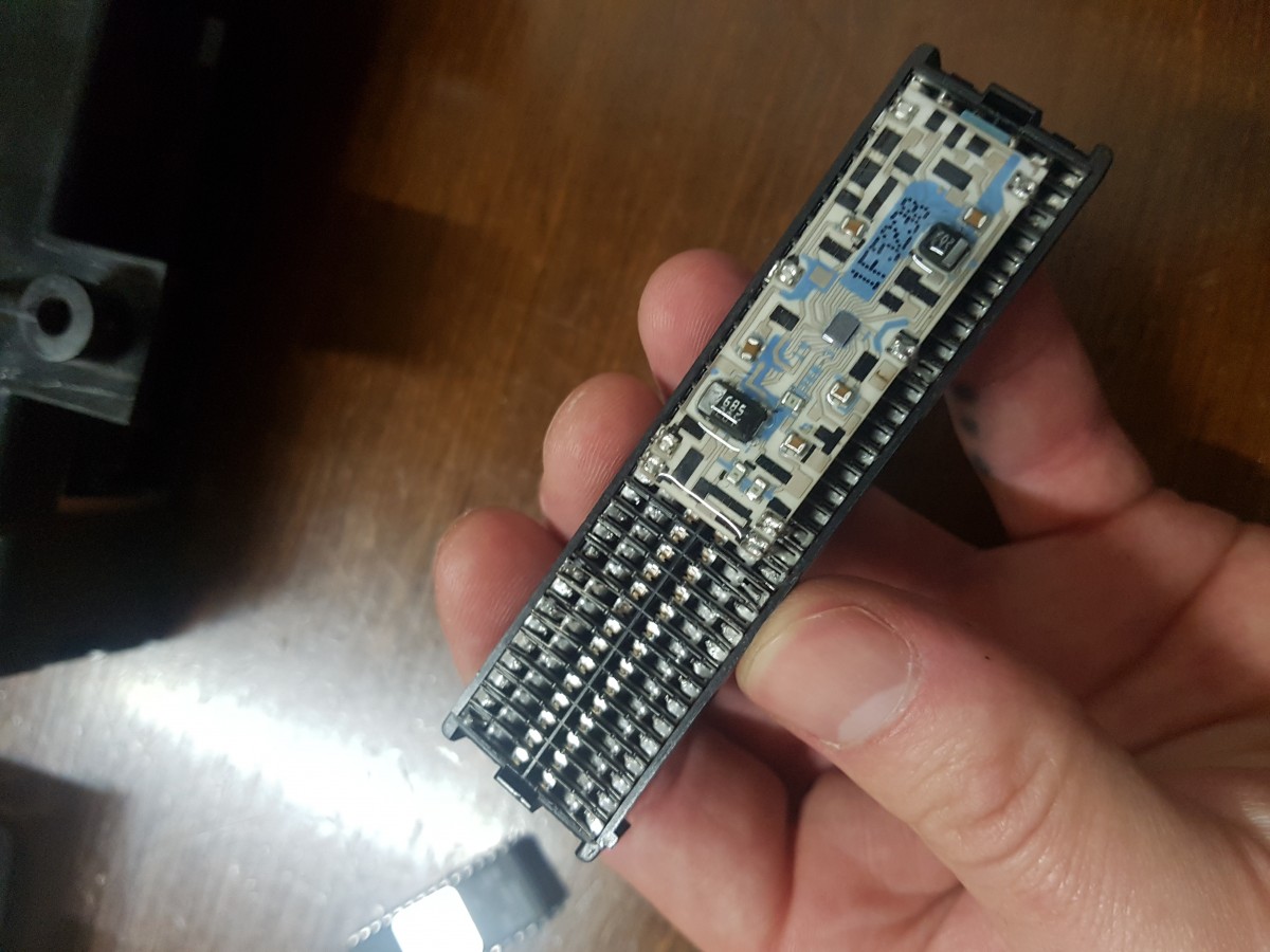

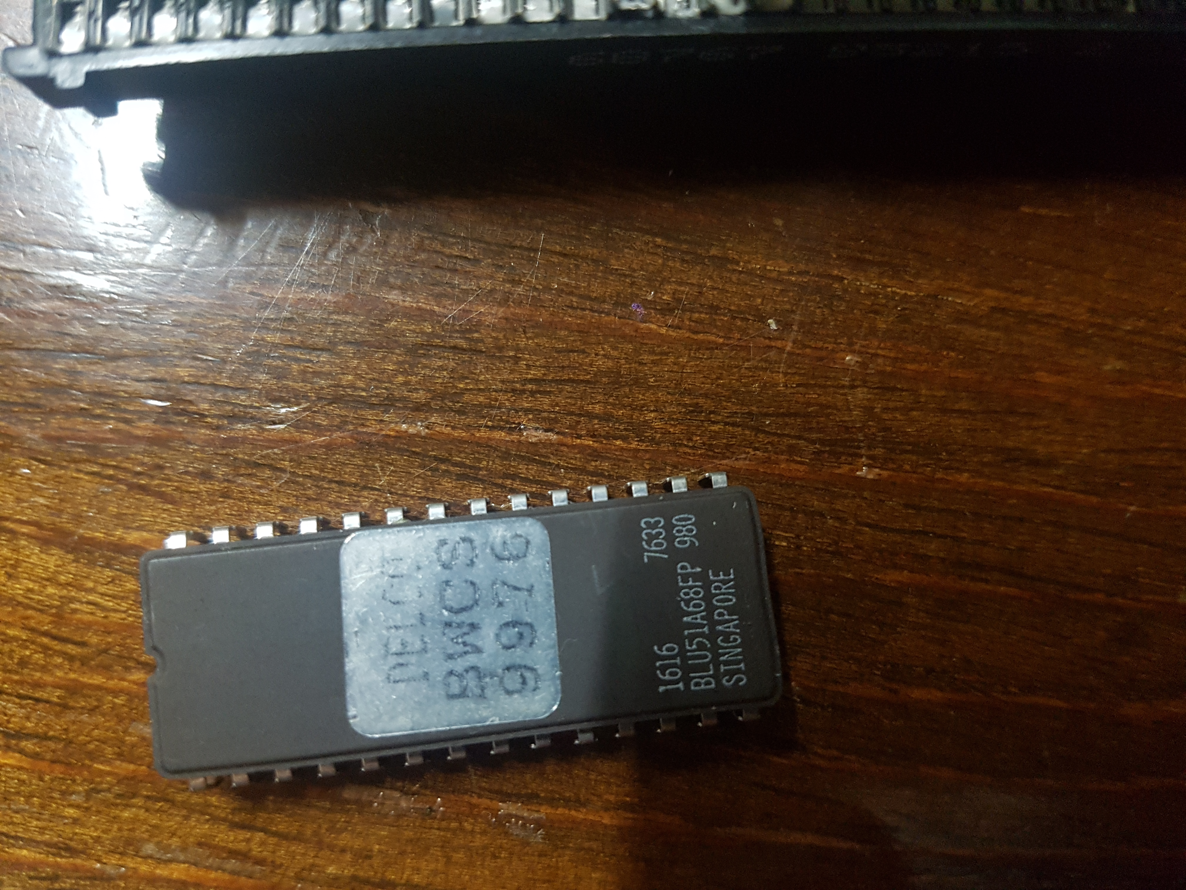

Hi all I was given a 16211838 ecu with a memcal that has a knock board on it along with a chip that has been butchered off it. The chip reads BWC9976
I already have a 808 and NVRAM with all the kit that I still have not used yet due to my ss still not ready to go.
Can I use the memcal along with the NVRAM to utilize the knock board, or can I take the knock board off and use it on my current memcal?
Can this be used in my vp ss?

Yes, the 1F knock board is the correct knock filter to use for a v8. viewtopic.php?f=11&t=214&start=20#p13685
