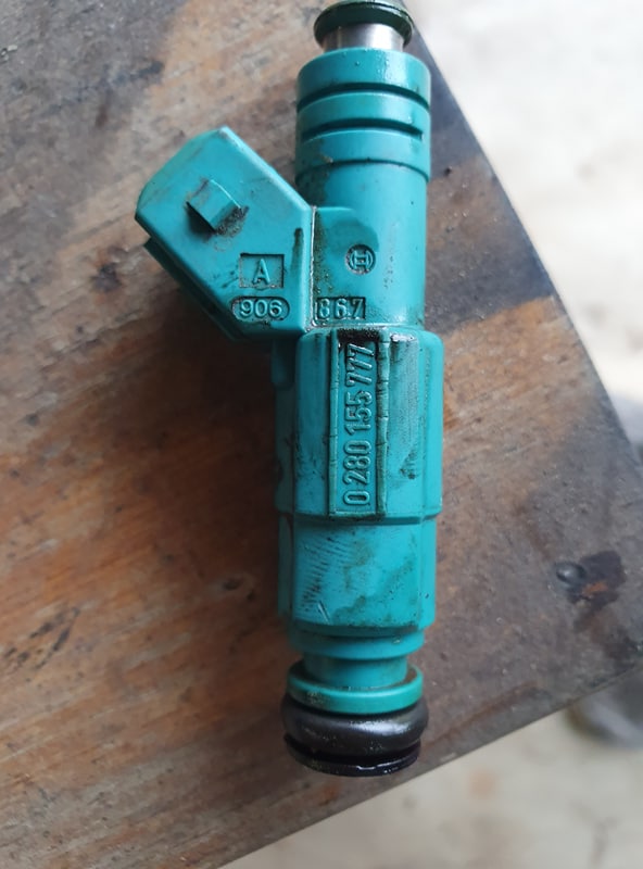

Ill attach a photo of the injectors in question as someone asked earlier the colour

yeah they are the late ecotec ones.
Would be a good idea to check the fuel pressure. should be about 50 psi

yeah ive just spent some time searching injectors
0 280 155 777 (EV6)
21.44 LB/HR 219.85 CC/MIN 162 G/MIN 12 Ohm 3.5bar OP
are the ones i have
0 280 150 973 (EV1)
20.21 LB/HR 207 CC/MIN 152.8 G/MIN 12 Ohm 3.0bar OP
are the grey tops so fuck all difference between them..
