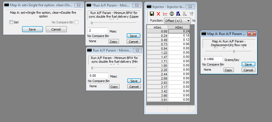

Can someone please confirm the following as referenced to my screenshot attached:
If i have the delco set for double fire option it will fire the injectors and spark 2 times per firing cycle of the cylinder (ie wasted spark)
If the BPW is below 2 seconds the Delco will force single fire mode.
Regardless of the firing mode the BPW will have a small amount of time added as per the injector bias add on.
Looking at the tables attched is there any other parameter that could prevent the Delco from commanding less than 2.5ms? Obviously other than the VE and flow calcs completed while running. I can lower the VE right down to nearly nothing and the BPW will not go lower.
I run a 424 in my Torana and can see that at idle and low loads the 80lb injectors are at ~1.7ms. i drive the car and get off the throttle where i see the bpw go to 0.55ms. My injector bias add on table has 0.55ms added at 0.00ms commanded.
Is there anyone successfully running larger than 60lb injectors with a 305 ecu?
I have also added the latest tune we did with the 65lb injectors. All i have tried to do is install the 80lb injectors, load this tune with the displacement/injector flow rate changed to accommodate the larger flow rate. I can get it so the car will have the same measured AFR under some load but at low RPM and low load it misses and drops a couple cylinders from over fuelling.
As a test i simply wound the rail pressure down from 45psi to 30 psi. the missfire improved and the cylinders got better but it was still not enough to get rid of the issues.
Thanks for all of the help so far.

- Settings 1.png (34.02 KiB) Viewed 4053 times

Set your displacement Injector flow correctly you have it at 0.15 for ethanol and 80lb injectors on a 712cc cylinder it should be around 0.033 that's why your VE tables are stupidly low and probably confusing the shit out of the ecu calculations it works on ideal gas laws and having the number way wrong could do bad things. You will have to lift all your VE tables up afterwards till you are around the 90 VE in the 100kpa zone. Set the injector bias vs battery volts table to the 80lb seimens deka values that can be found on this site. Turn double fire back on and get your fueling back to normal with the VE table. See if that fixes it
- Posts: 5636
Re: 305 tuning issues. Please help
And disable lean cruise while you are tuning so you don't battle with it pulling fuel out
