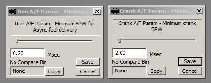

It makes sense to me also. Can yo utell me where in the $12p XDF i can find it though? I cannot see it in version v112
- Posts: 8124
Re: 305 tuning issues. Please help
should be these 2.

Vlad I have zeroed both of those parameters out,
Yoda I have also zeroed that whole table out.
It appears no matter what I do the injector BPW won't go less than 2.5 m/s. And the car would not run on all cylinders at low RPM.
For a trial I wound the base fuel pressure down to 30psi (the regulator minimum) the car did start to run on all 8 as checked with a temp gun on the exhaust but it still has a misfire.
Any ideas why the ecu isn't commanding less than 2.5m/s? I have the ecu forced in single fire mode to try and get the BPW better but no luck.
