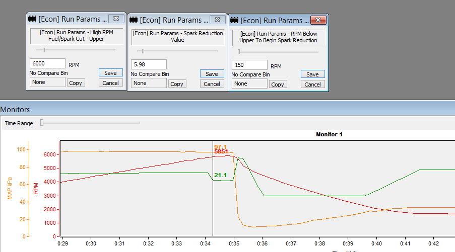

tdracertd is on the money. this picture should explain it all.... its dropping your timing by 5.98 degrees exactly 150 rpm below your hard fuel cut threshold. exactly like it is programmed to do :)

I have my soft cut zeroed out. Rev limit runs straight into hard/fuel cut (808). Very unlikely that I will run into the limiter though, as all my torque is quite low in the rev range. If you have spark cut option, I see no need for a soft cut on a racecar.

had a look at one of the dyno charts and before it even gets to 5800 the torque curve virtually fallen off the graph entirely, kinda pointless. Not going to make any more power by increasing thew soft limiter.
Looking at the torque cuve.
as the curve peaks and plateaus for a while, at around 5000-5250 it falls that hard and sharply it looses 80Nm in 550rpm lol. Looks like an elbow or cliff.
To me that shows there is something nqr.
