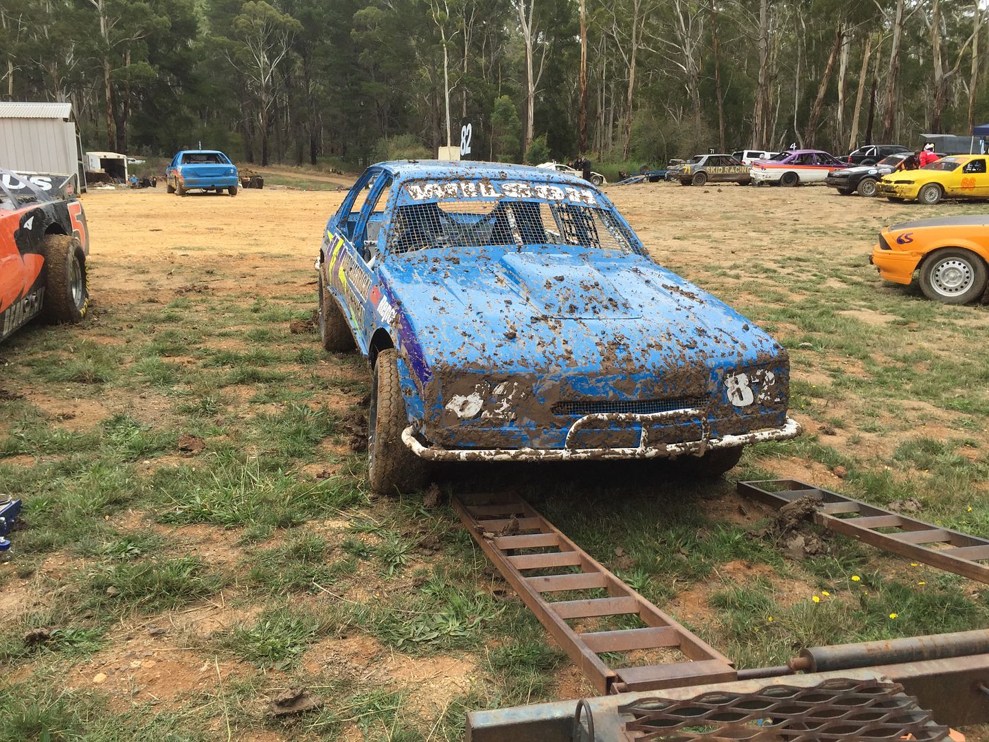

Soooo.... Took the car out for a shake down run today, HOLY SHIT!!! very different car, super fast and really well balanced, very easy to drive quick. Pulls really hard out of the turns and you really need to 'feed' throttle rather than stab like Im used to. I started rear in race two and lapped the field by lap 8 :D only to be taken out by a rookie in a Kingswood that couldn't drive. Stripped the splines on the steering rack input shaft and banged up the brand new panels :x oh well, thats speedway
some things to fix are -
move steering wheel and throttle forward 2 inches
Get tyre monitor working (read temps not pressure?)
Diff ratio change
Other than that she's good to go and gives me lots of confidence :thumbup:
