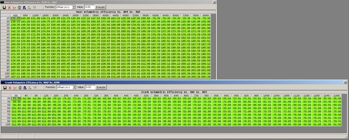

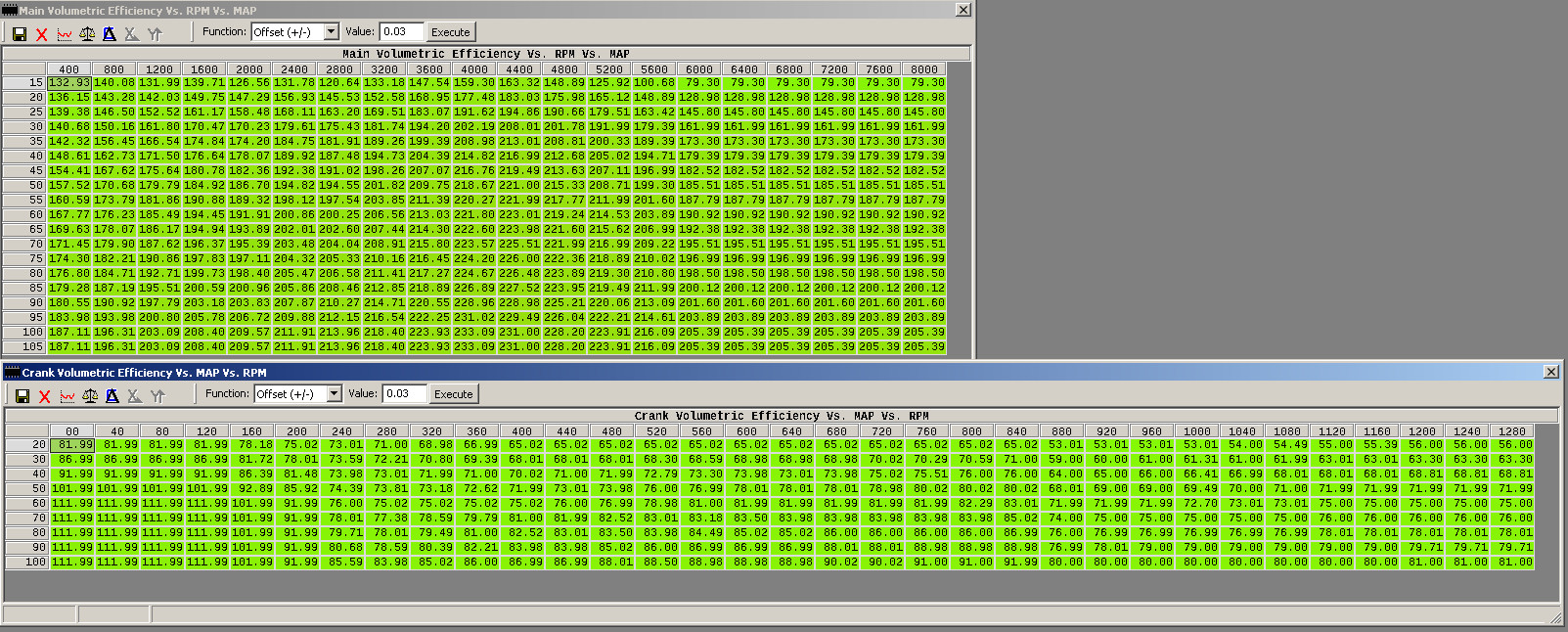

Right now there are two tables, one for cranking VE and one for normal running. They are both big enough with enough resolution for almost any NA motor. The first group of 1UZ motors came out in 1989 so they were probably using an 8bit ECU. If that was enough to run them back in the day what the Delphi box has to offer will be totally fine.
I also want boost and what we have to do is either cut the resolution by the amount of boost you want to run (2bar = 1/2 resolution in VE table, still totally fine) or move the VE table to somewhere with more room in the ROM and make it bigger. It would also be possible to halve or double the resolution of the table after it is moved. It's a lot easier to move the table but I haven't tried it because I only have one box and I don't know if it will make a brick.
How much is an ECU near you? This one cost me $80 + sh. I want to buy a whole, running vehicle with PCM for $300-400 for this project so you can see my hesitation to rush out and brick this one. There's no reason to have custom code to get the fueling right on any NA V8 engine I can think of, just a calibration modification.

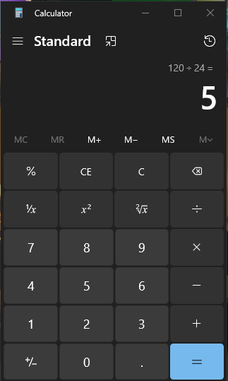

With enough work they could also work with the trigger wheels of the V6s of it's time. For 58x, you'd need a lot of extra work. Turn off filtering in the Delco CIC and do all the decode and filtering in software.
Link to it's datasheet viewtopic.php?p=131488#p131488
A piggy back board could be made to bypass some functions of the CIC (it's apparently needed for flashing with PCMHammer). Count the high and low edges of the 58x pattern and send a pulse to main CPU every 5 counts. A little extra work for the 2 missing teeth and sync data that get's sent over SPI to main CPU.
For a full on signal converter, one 58x tooth/gap is the size of a 24x short tooth, and double that for a 24x large tooth. If not for the missing teeth, a full on converter would be effortless even for me just using ChatGPT.
- Capture.PNG (18.52 KiB) Viewed 276 times
Don't stress specific units.
