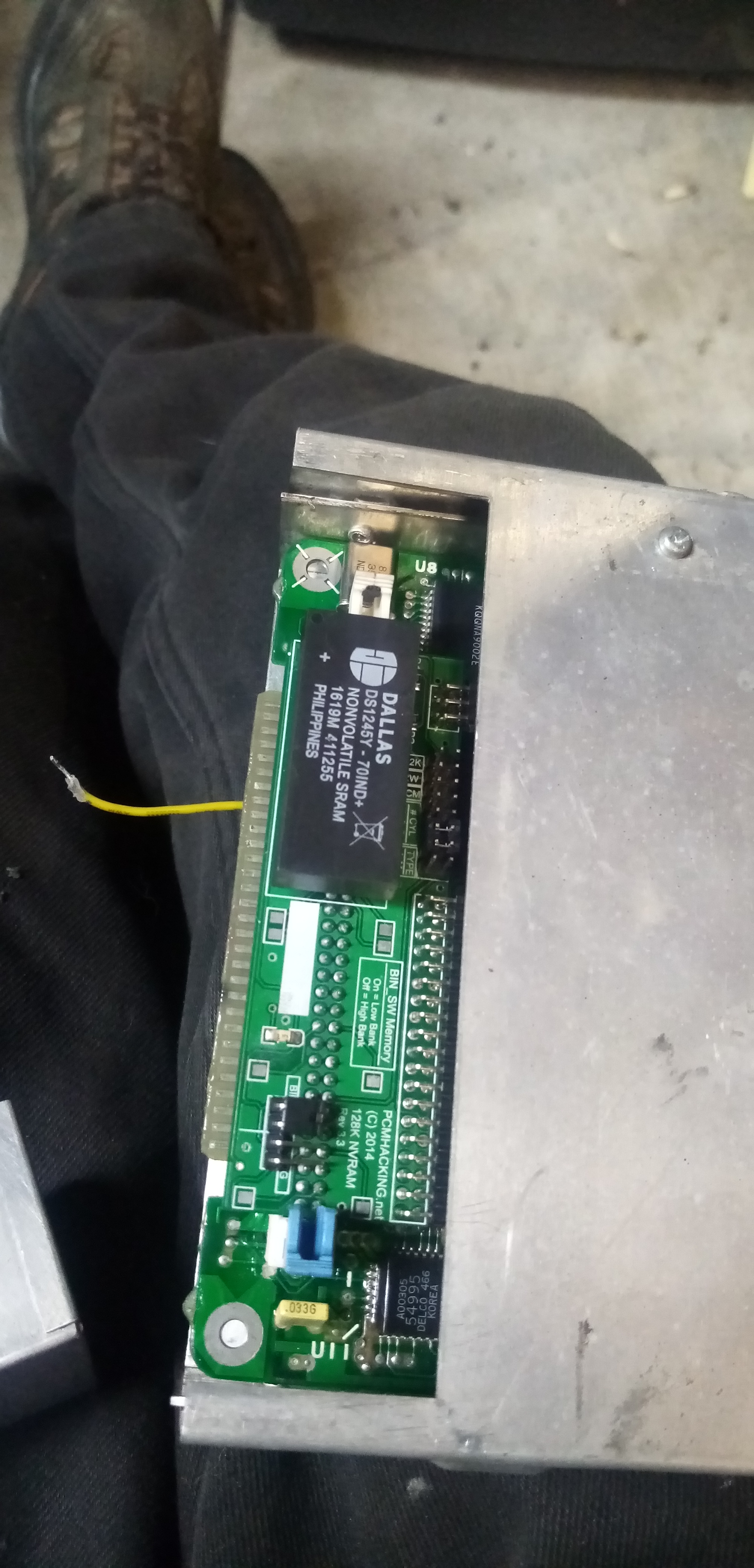

- Posts: 5639
Re: Can't connect to 808 with USB comes and nvram
This is what greeted me when I took the lid off least there was no redbacks lol. What it's bounced round and touched is anyone's guess but I'll resolder and reprogram it and see what it does on the bench worst case I have spares
