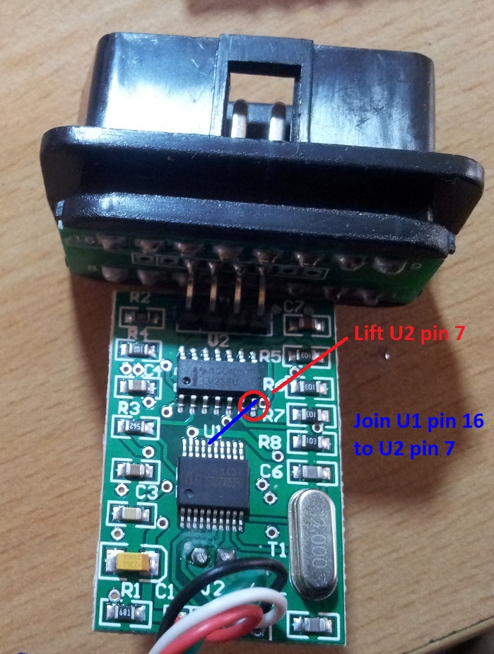

To use a cheap POS ebay USB-KKL interface with the older Motronic ECUs they need a slight modification to work reliably.
The KKL interface uses two lines, a 'K' half duplex line, and a 'L' low speed init line.
It's very similar to an ALDL one wire interface, the K line is used for both tx and rx. The L line is simplex and only used to "wake up" the ECU by sending a 5 baud ID byte (yes 5 baud, i.e. 2 seconds per byte!) then it's not used any further.
The cheapest KKL cables use a WinChipHead CH340T USB-serial bridge, which is quite decent - but for some reason the interfaces are designed with the K and L lines effectively tied together which makes the connection very unstable.
The fix is to separate the L line, and connect it to the CH340T chip's RTS pin so it can be driven independently of the K line:
And here's a schematic I traced out for the un-modified interface, you can see that the K and L lines are tied together:

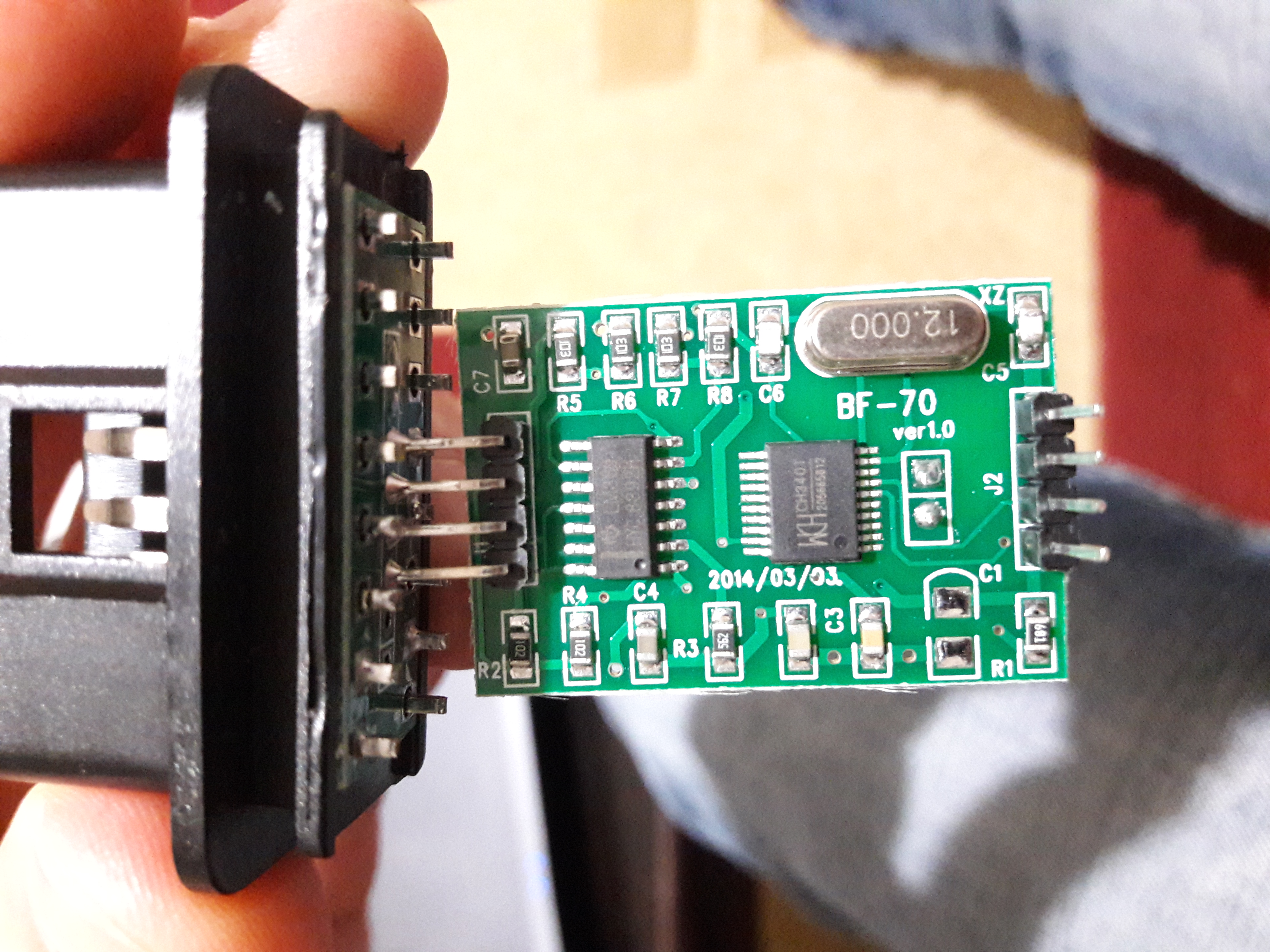

Will this modification work on this cheap usb kkl cable?
Posts: 9006
Re: Fixing cheap ebay USB KKL cables
It looks like the same design down to the same component numbering in the same place. I think it would work.
canibeanartist
Posts: 1
Joined: Sun Jun 14, 2020 5:29 am
cars: 2011 Audi A5
Post by canibeanartist »
besiseitaj's cable is missing C1 in comparison to festy's original post. What is the significance of this capacitor?
Posts: 9006
Its to reduce electrical noise. The board with it will likely be slightly better in marginal conditions, and also introduces less of its own noise in to the circuit.
