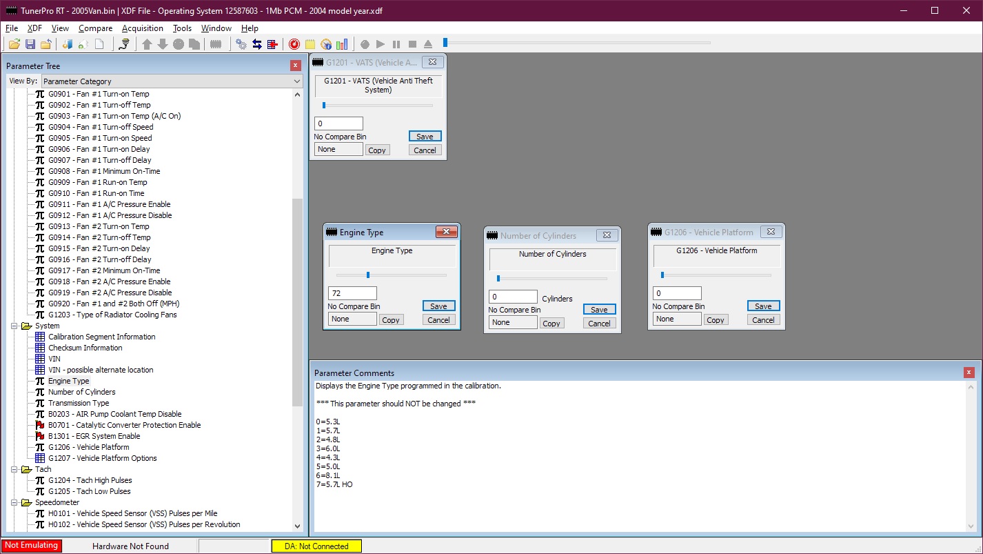

Going back I loaded the original .bin back in TunerPro to take a closer look, this time digging more into some of the settings and many of them don't appear to make sense (Engine Type 72, Number of Cylinders 0). I attached a screenshot of a few. I decided to go back and flash the original .bin back onto the PCM to see if I can at least go back to before but LS Driod will no longer sync the bluetooth connection. The default OBDLink andriod app still connects.

It looks to me like you dont have the right XDF for the OS. You probably have changed something which has had unintended side effects and might be crashing the PCM. You will probably need to open the pcm and ground the pin which triggers recovery mode, and use that to be able to flash the original bin back in.
Then you'll need to identify what OS the bin is and either get the right XDF, or put a supported OS on the PCM and work from there. Since its a transplant that should be fine. Can you upload your original bin here?

As Antus suspected, wrong XDF for the OS ...
In the title bar of TunerPro it says you are using the XDF for OsID: 125 87 603
The bin file you attached (2005Van.bin) is OsID: 125 92 618
That is a fail ... You MUST use the proper XDF for the OsID.
That I know of there is NO XDF for OsID: 12592618.
It would be best to replace OsID: 12592618 with a supported OS like OsID: 12587603.
The VIN is invalid so I suspect it's a modified bin ...
