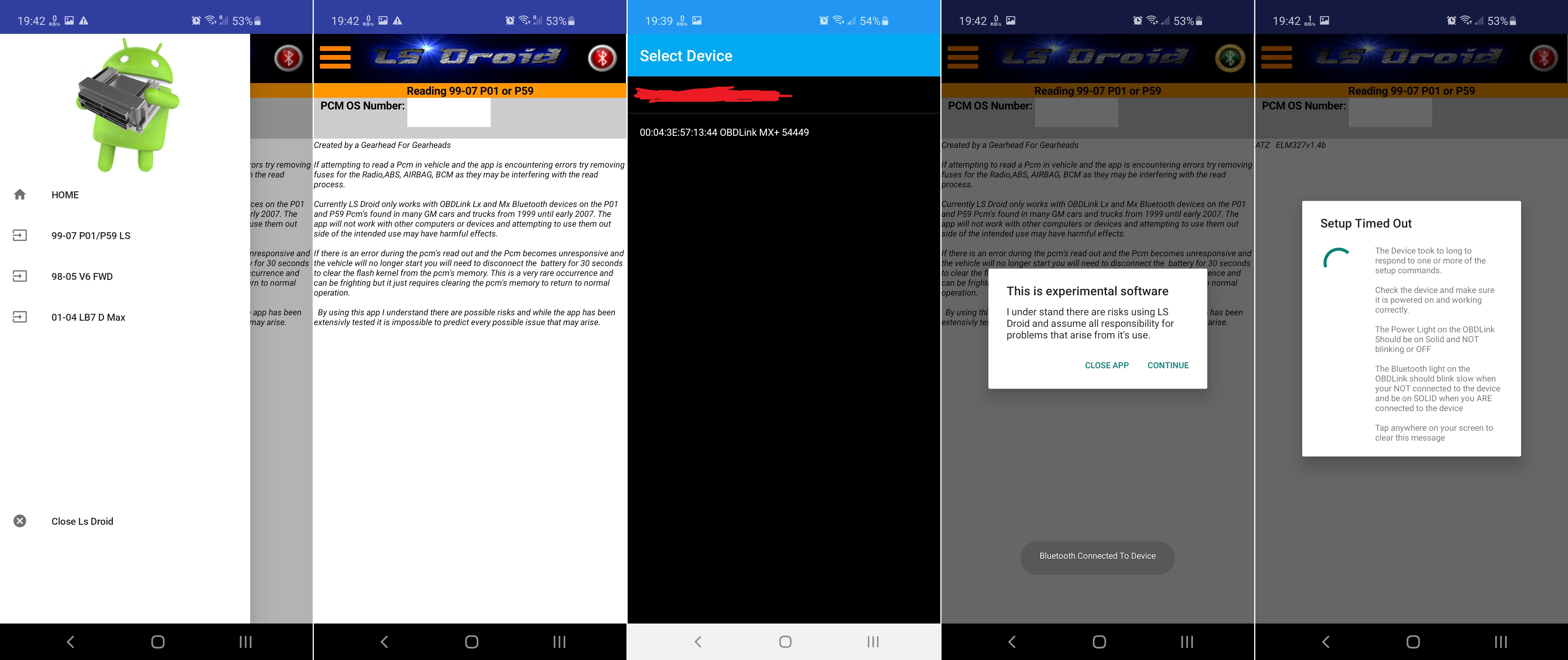

Okay bad news :( I tried grounding the correct pin but with no success. I tried it with various timing at various points while trying to connect, no success.
I attached some screenshots to explain better where the communication is breaking down. I load up LS Droid select Read, click on P01/P59 then press the bluetooth button in the top right. I can select the device and a prompt comes up with the experimental warning. I get notified by Andriod that Bluetooth is connected. I press continue and the ODB and Host lights on the scanner turn on briefly but go out, nothing happens in the output window and a few seconds later I get a Setup Timed Out popup.
I tried grounding the pin before and after selecting the bluetooth device, during and after pressing continue, and while waiting for it to timeout. No change.
I validated the ODBLinkMX+ is working fine with another car. I also tried LS Driod 2.1, 2.2, 2.2B.
Would my results be different with a different ODB2 interface device and a PC?

vvise wrote: [09:09:00:854] 0x0FFC00 99% 00:01
[09:09:00:864] Read complete.
[09:09:00:875] All read-request messages succeeded on the first try. You have an excellent connection to the PCM.
[09:09:00:892] We're not sure how much retrying is normal for a read operation on a 1024kb PCM.
Says it completed a 1m read successfully, no retries ...
Why the CRC failed is unknown with out further investigation.
Do you have the full Debug log for this read??
if you do, can you either PM it to me or post it as an attachment ... (it's to big paste into a post)
As for the Test Write ... Maybe it all needs to get power cycled, a read was just accomplished, it also gets the OsID and apparently did so successfully, so the PCM appears to be responding.
At least that's what I see.

vvise
Posts: 12
Joined: Thu Sep 17, 2020 2:51 pm
cars: 1978 280Z
Re: First time tuning. Need some help.
Post by vvise »
I'm trying to collect more data for you guys but I'm having some issues. I rebooted everything and afterwards I had a hard time initializing the device in PCM Hammer. Finally have it connected but now I can't even get a Read Properties to work.

Can someone confirm what I should be trying. I have the ODBLinkMX+ bluetooth connected to my PC. I tried grounding the pin to the negative on my bench harness for 1 second followed by a short wait, then I tried to re-initialize the device. No change. I tried the same thing but then pressing Read Properties, also nothing.
How do I force the device to boot in recovery?
Posts: 9006
you have it all set up and running ready to read then you bridge the pin between the red marks and one of the ground points momentarily. A couple are marked with black Xs, you can identify them as looking like pads but they are connected to large solid areas of the PCB. Then you begin the read or write. This pulls address pin 17 (I think? from memory?) low for a moment which is enough to crash the pcm, cause it to fail to see the calibration or OS signature which means it thinks its unprogrammed, and the address is high enough that the boot block (at the beginning of the chip) is ok to function without interruption which allows the boot mode code to continue running until the flash begins.
