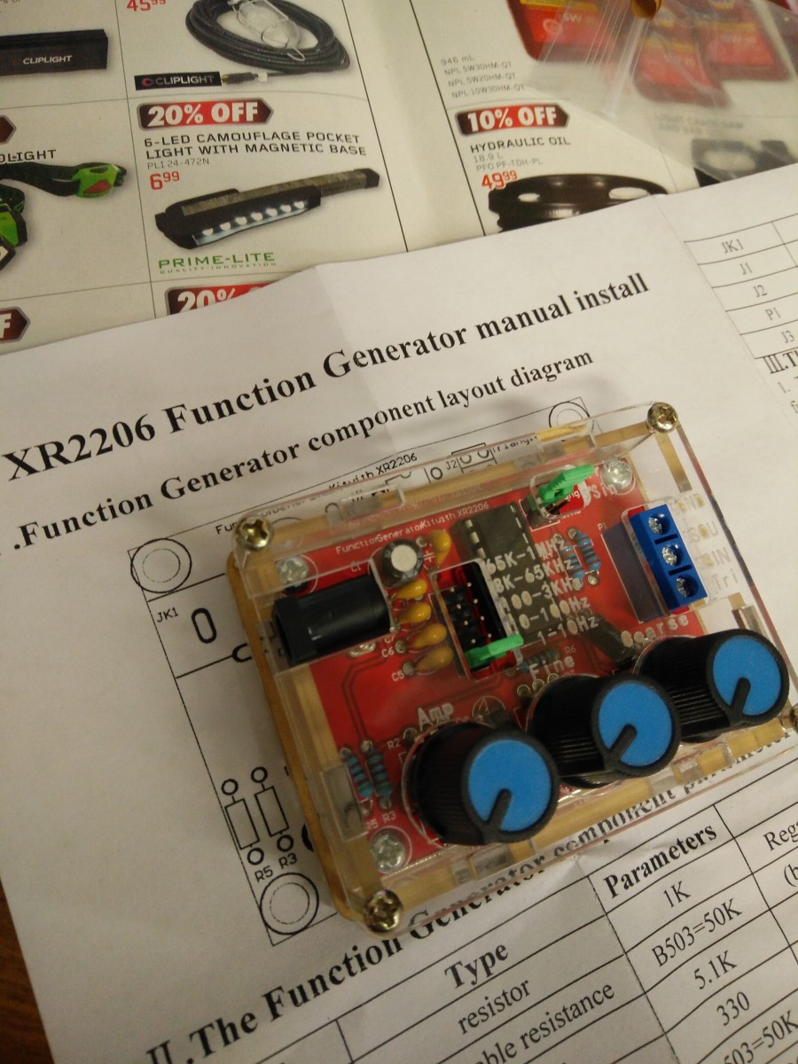

Had this show up today and zapped it together. It will most likely work with the V6 OS and bin it seems..

Oooh, talk about an ancient circuit! A blast from the past if you will.
I remember assembling one of those back in the '80s while in Tech School!
Nothing wrong with it - just brings back memories!
Mike
Mike

I have a p59 in it. I still haven't wired in that pwm generator, but I have the crank sensor wires exposed and ready to go for the generator. Provided its close enough to the v6 signal. For now I bumped up the idle on the dsl1 injection pump controller to 850 rpm. The voltage output of the alternator is a little more stable on the voltmeter. Would like my battery light and fans to work correctly with this... Would also be cool for the fuel pump to cycle normally on key on and running. That would be more ideal and safer than having it run on all the time..
