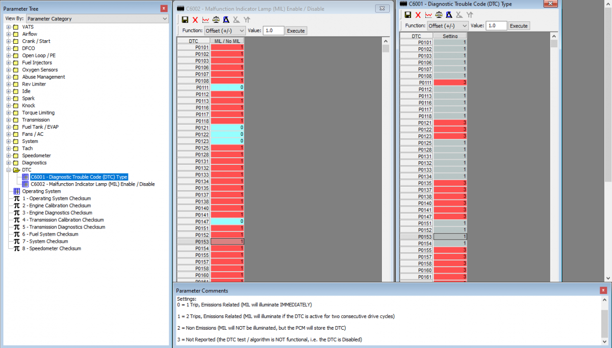

Mods that I have are longtubes, high flow cats, Blackwing intake, and a few other small things. I keep getting a P0153(Slow O2 sensor warmup). I wanted to turn this code off so it wouldn't effect my car going into closed loop. Attached is screenshot of the DTC's in TunerPro.
This site had the correct XDF for my OS version. Now my ECU has been tuned by ECS. They are very popular on the Corvette Forum for mail order tunes.

I have tuned out that slow response code. The interesting piece was when datalogging through the OBDLink app on my phone, the waves look the same for right and left side O2 signal. The sensor looks to work, but the more research I did the more I found people with the same issues. They all Tuned it out.
This process wasn't terrible, I just wish I knew how to do real tuning for A/F so I could get a few more ponies than the mail order tune has.
