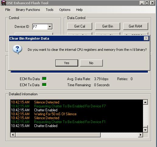

I did a read on the old flash tool 1.27 this morning & was a bit of a pain but new it worked, so then on the same vehicle I used the 1.28 & SWEET!
Was so much quicker & easier to connect with disabling chatter!
So can we just click auto echo rather than ignore?
Also once I did read bin it came up with the attached option, what is this used for?

- clear cpu memory flash.JPG (45.78 KiB) Viewed 9520 times
Re: The FlashTool V1.28
it clears the areas of data in the received bin that contain unnecessary information.
(basically the contents of the internal memory in the processor, and some information specific to your car)
