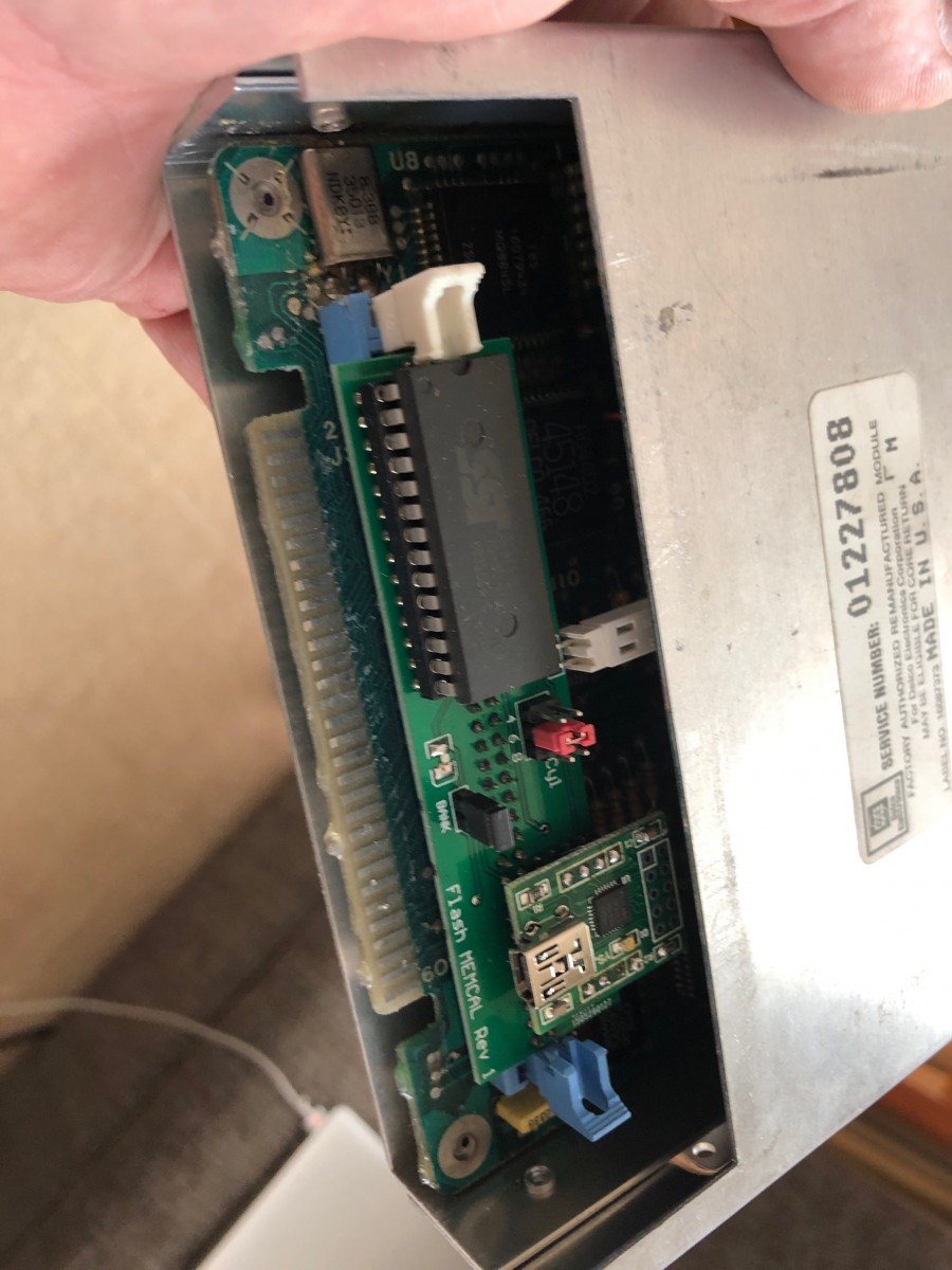

]I got a pile of ECUs years back, in my throwing out of most of my shit ; I found this. WTF is it? Any idea?
Two wires soldered to the 808 with an adapter for USB comms. The ECU is labelled like its from the US of A in a big way, but, still an 808.
[attachment=0]wtfisthis.jpg[/attachment
What is this in my 808?

Thats a good question. Can you see what that USB board is doing? Surely its not for programming the flash. It is a comms board instead? Whats on the back side of it?
- Posts: 10013
Re: What is this in my 808?
Actually I reckon that usb board is some kind of a comms interface, probably that white connector on the back of the board goes back to the main board for serial. so its some kind of non-real time interface.

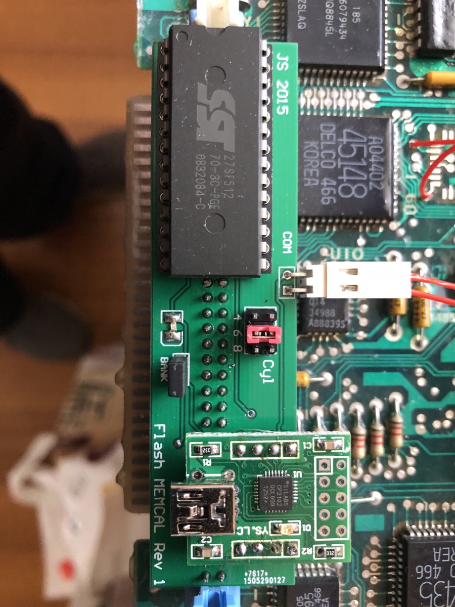

will pull it apart tonight and see if its got any identifiers on it. i know the two wires from the 2 wire header from the comms board go to just in front of where the memcal is ; not sure whats there on an 808 so will be interesting to see

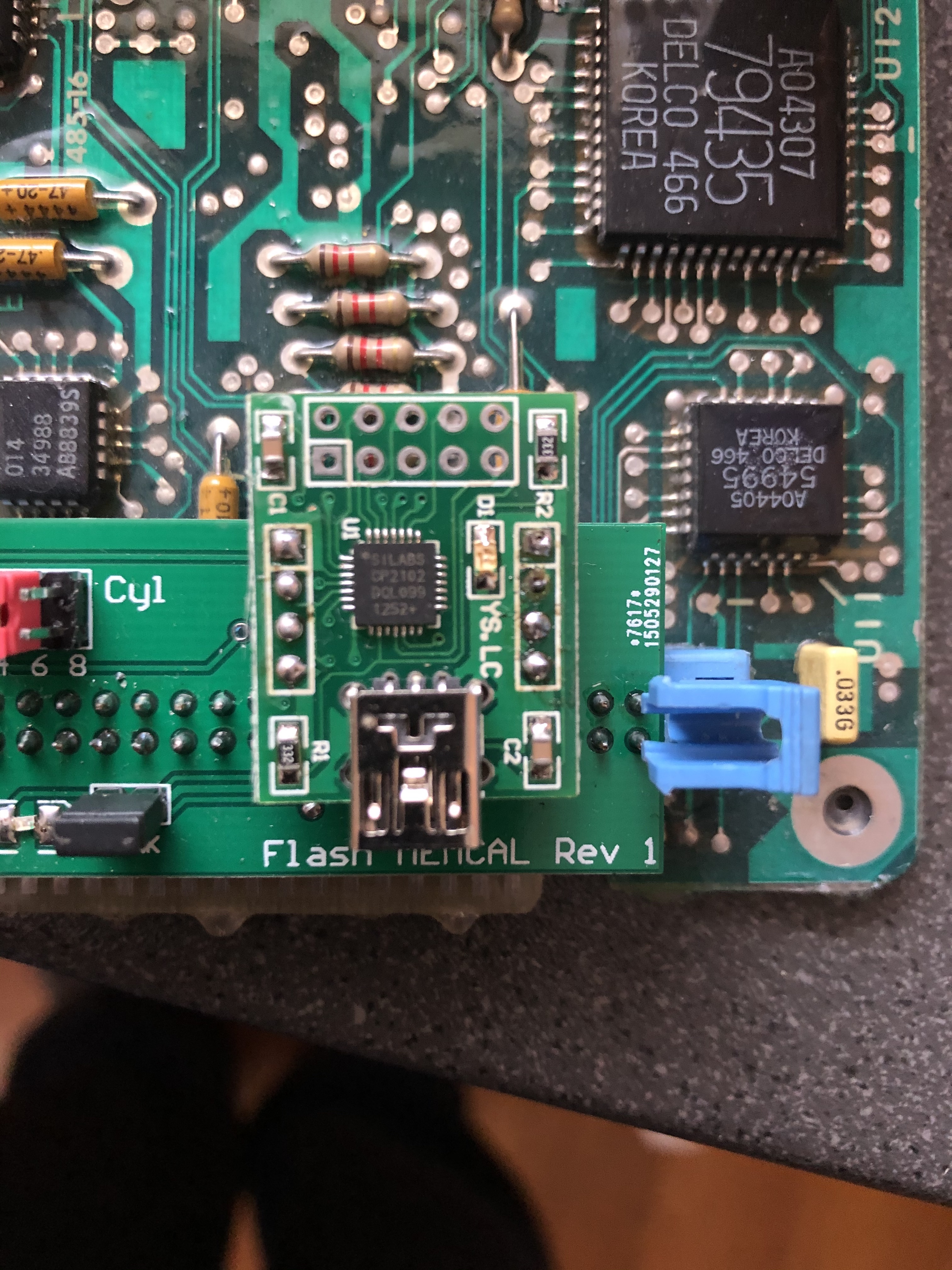

more closer up

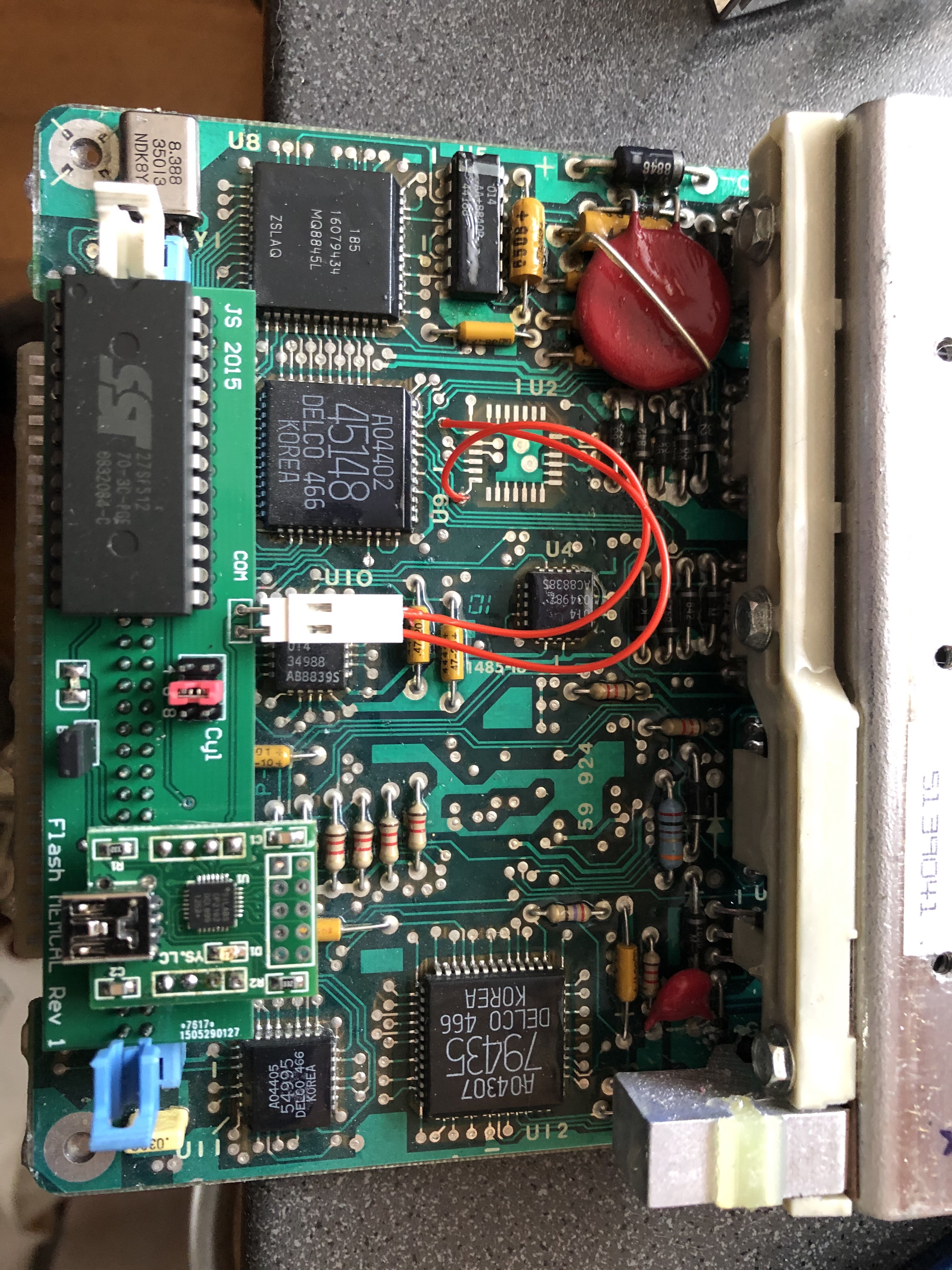

whole board. can see goes to TX and RX
as close as i could get with shitty phone. that interface is soldered on. the empty header looks like SPI for that little chip which i am guessing is similar to a max232.
yep .... USB to UART bridge.

- Posts: 10013
Yeah my guess is that is one of the boards Festy used to make. Its a nice design. eeprom on board, and comms module built in.
- Posts: 2678
But 2015 date???
It’s nice to be “all in one” but surely the memcal standoff isn’t up to plugging and unplugging of the USB without connection dramas?
