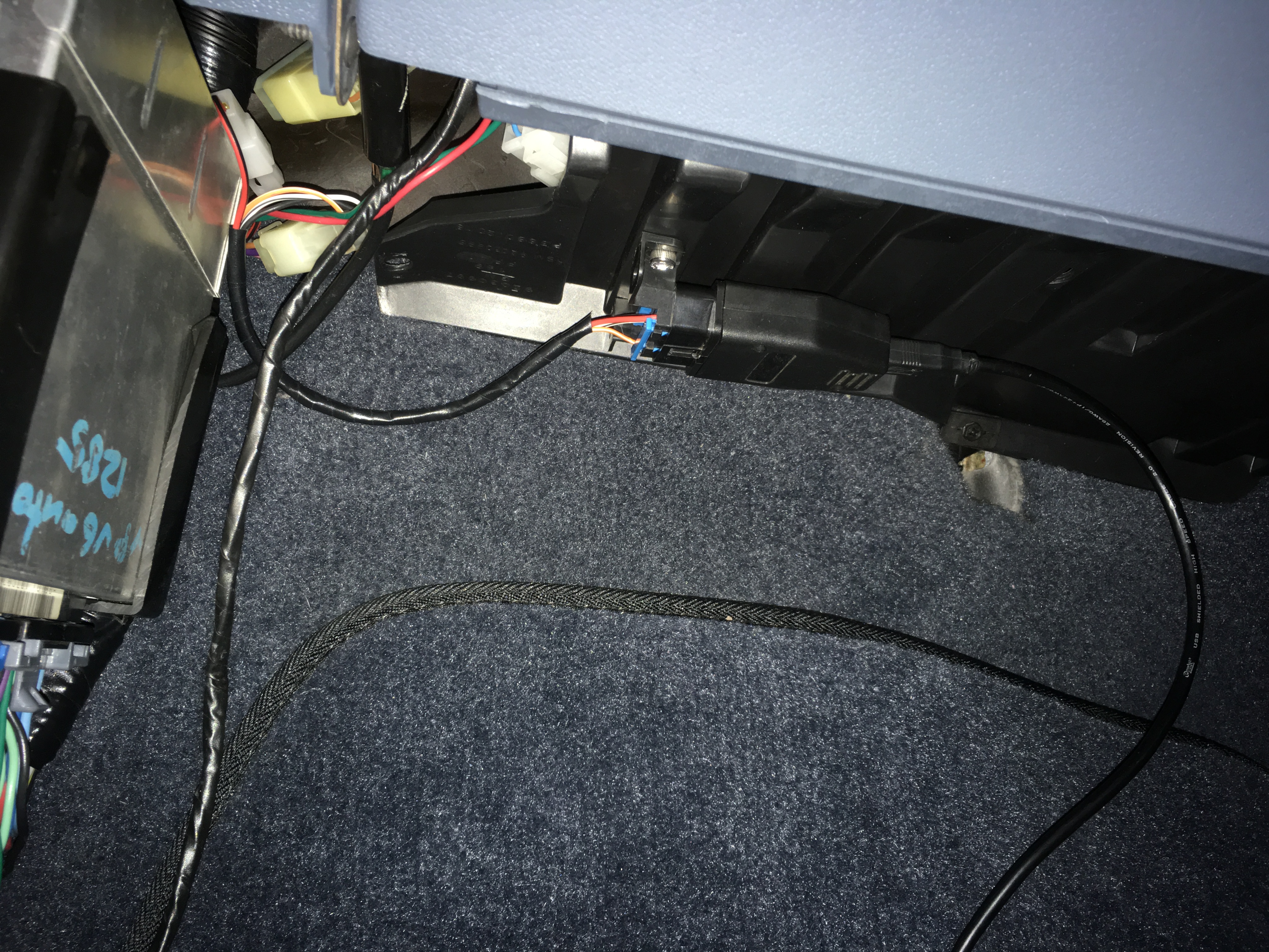

This is what I did on mine, was literally just 4 wire, min of 2 to make it work but I also wanted 12V and paperclip diag mode too.
Way easier than opening up the kick panel every time I find something I need to change in the tune and its also one cable and TP settings for all my cars.
I sold my USB comms 808 and went the 082, 305 and 808 with SXR board path so to use my ALDL cable for everything.
