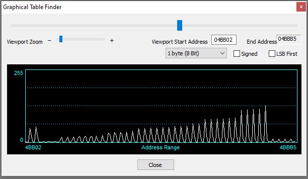

Gampy wrote:2000 Grand Am GT LA1 12201465.bin
2005 Grand Am GT LA1 12594385.bin
It is my understanding these files were pulled with TinyTuner, apparently it doesn't write the Parameter Block to bin.
See here: V6 ability for pcm hammer.
I have also updated my post with a bin in the V6 ability for pcm hammer. thread.
Same results with it.
2000 Grand AM DTC Axis starts at 4BB02
2005 Grand AM DTC Axis starts at 471DA
I use 2d mode in a slope rising up to ID the axis
- 2d winols.JPG (64.28 KiB) Viewed 3131 times
- 2d.JPG (44.17 KiB) Viewed 3131 times
