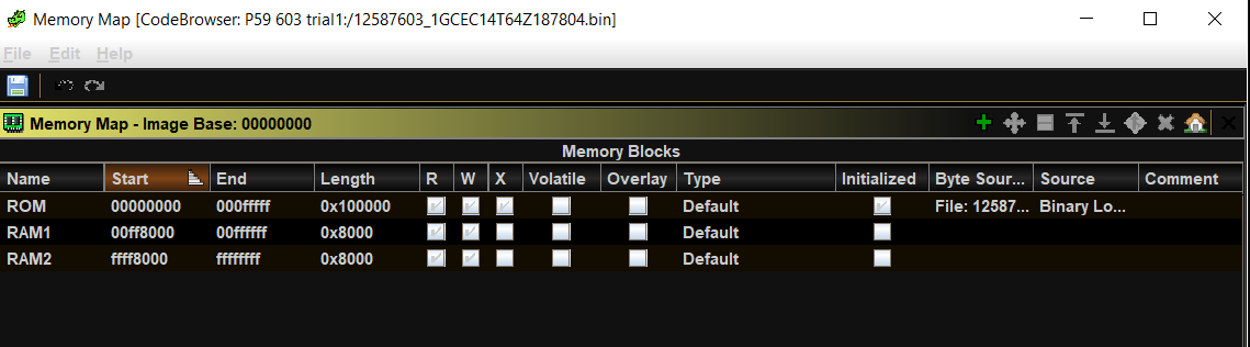

Re: 12587603 OS disassembly
working on getting a fresh binary to run within ghidra. Following Antus's post here:
viewtopic.php?f=42&t=6247&start=10
I setup the follow memory map. Does this look correct? I'm getting functions and references in both RAM maps which from what I understand should only be in 1- so I am assuming it is not setup correctly.
edit- its only analyzing to the segment tables around 0x502ish before it quits. so I'm off somewhere. Maybe the cpu32 instructions aren't loaded in correctly??
