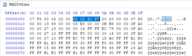

- Posts: 9006
Re: GM TCM Checksum Calculation
The same ID is also here at the start of the file. Maybe were looking at a table of contents as well, at one or the other end.
- Image20.png (11.51 KiB) Viewed 9596 times
