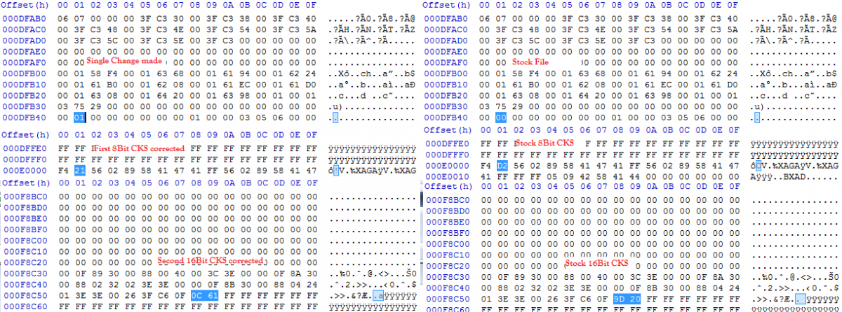

Range for both crc checksum is figured, too bad the checksum method is some custom crc-16 that don`t match anything I have tried.
Here is a test bin that should match with $9d20 checksum if anyone is willing to explore the method.
In the disassembly there is some bytes used in the calculation. Maybe some table for crc. Here are the bytes looked up in 4 ranges by 32 bytes
These are consistant accross different ngc3 calibrations.
Big thanks to VX L67 Getrag for giving some great help.

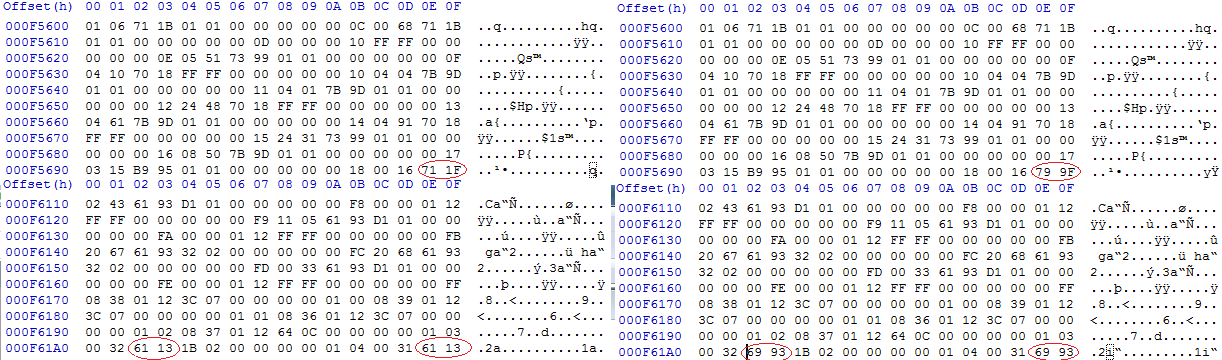

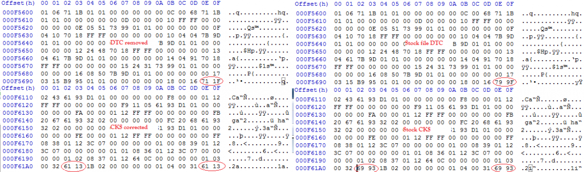

Re: Dodge bins checksum
Not sure whether this is just me looking simple???
It looks like it's just adding the amount changed???
VX L67 Getrag wrote:Not sure whether this is just me looking simple???
What you look at here is the dtcs turned off for p0016,p0031,p0032. Stil haven`t look that in details. I want to figure the checksum first before diving in some tables and dtcs discoveries.
The crc checksum location is down the file at $f8924
You mean this 1, this is the 8Bit CKS you already figured out didn't you?
OK so this is the 1 you were talking about....
Yeah that 1's not that simple, that other 1 I posted earlier I thought was CKS corrected on P0016 but yeah I was comparing the wrong files SORRYRe: Dodge bins checksum

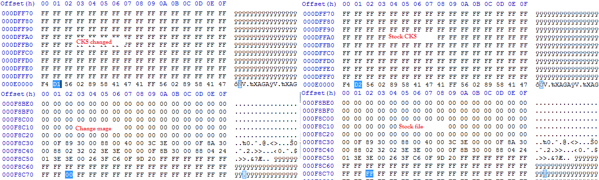

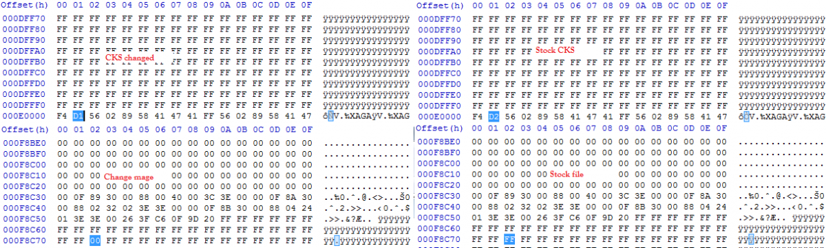

You got that range right.
the 8bit sum 2`s compl range is 10000-e0000,e0004-end of file,stored at e0001
The Os part checksum range is 10000-dffff and is stored at the last word that have data, in this case it is at f8c58.
The cal data checksum is hardbiult range and can vary but at this case it must be e015c-f8923, stored at f8924.
Both the os and caldata checksum uses the same method of calculation.
