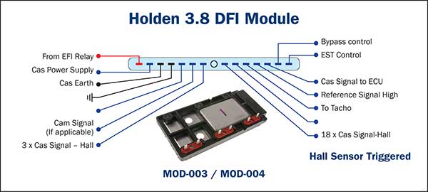

This pic shows how the wiring is linked.
If you have swapped out PCMs I would double check none of the contact pin sockets have 'backed out'. Are the anti back out 'combs' still in the harness connectors.
It still sounds like an earth, as it's common to both spark and cam sensor

'quipt4it wrote:This pic shows how the wiring is linked.
I have checked multiple times the connectors at the PCM as far as i can tell they are pushed in nicely including the actual wires in the connectors too. This was one of the 1st things i got told to check funny enough since we did the swap. The only thing thats not original with this car is the BCM but that came from another VT and had it linked up to the original L67 PCM for a couple years with no issues but i cant see the BCM having any relation to spark or the cam signal surely?
cheers for that image mayb i will take off the harmonic balancer again and test the wires between the cam sensor and the crank sensor, they seem to be the only wires i think i cant access properly especially the crank sensor plug and mayb with heat over the years 1 of the wires has snapped or corroded somewhere there? i was told the DFI's do have a shitty earths but i have checked the DFI plate and mount bracket is nice and clean.
