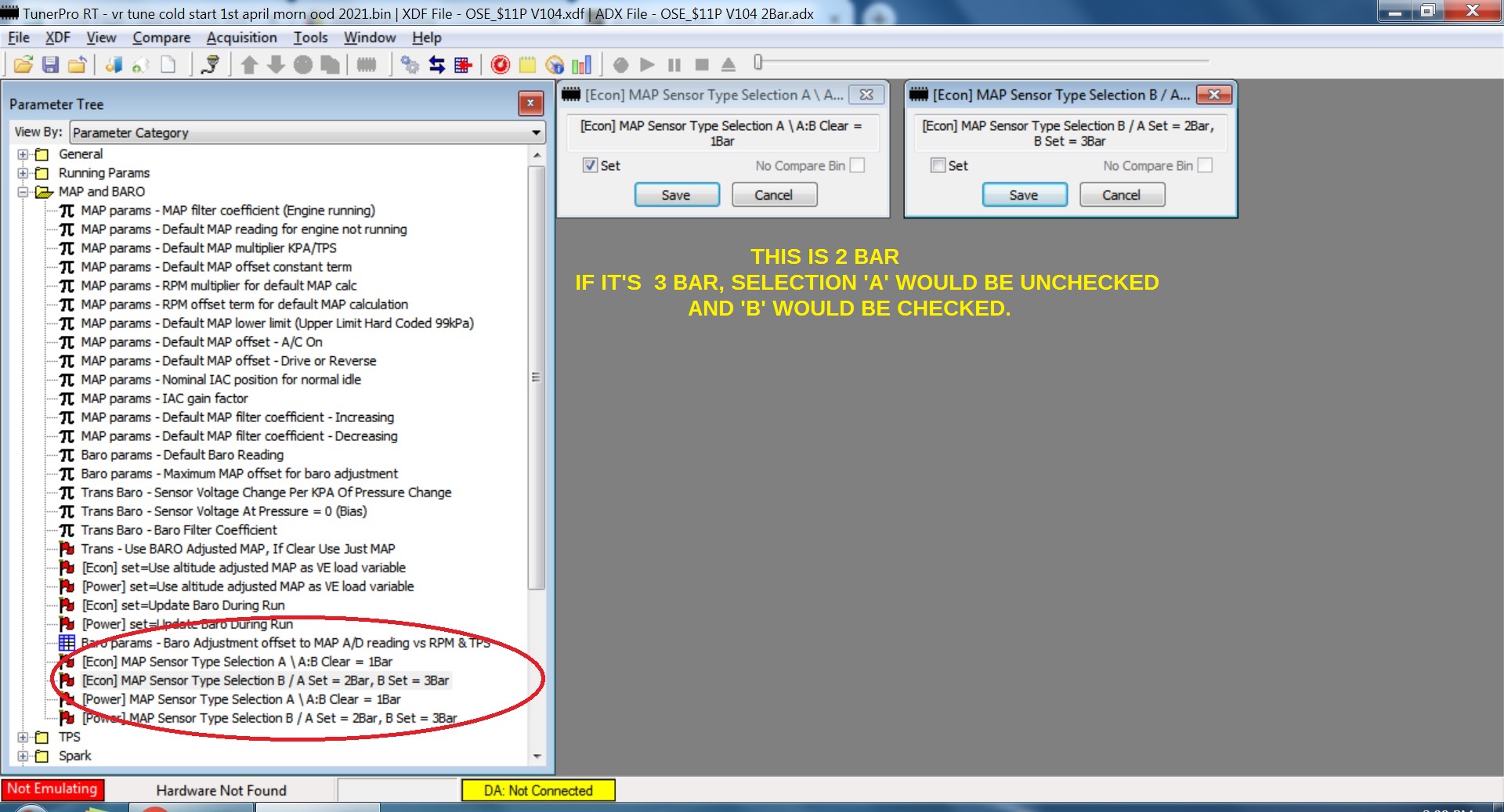

Make sure also your MAP flags are set to the appropriate MAP sensor.
