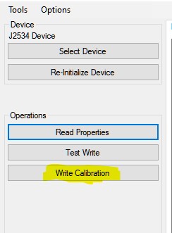

You want to write the calibration.. It's not in the drop down, it's right on the main screen..
Screenshot 2021-04-10 112537.jpg (17.49 KiB) Viewed 1707 times
