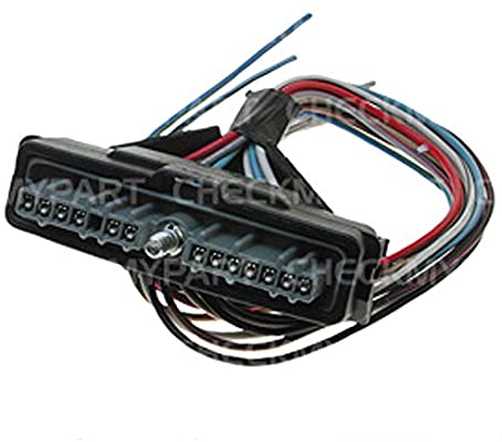

Easier to buy the short harness for the DFI.
That way you have a tight new plug as well:
https://www.nikithinka.com/index.php?ma ... _id=147915
Have you narrowed the problem down to this?

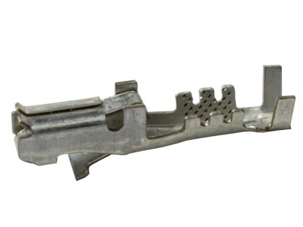

Re: Removing wires from DFI plug
I think it's this one but I would have to double check.
Only problem is the shipping from the USA is a killer, but I usually buy everything to make a whole harness from scratch to make it worth it.
https://www.eficonnection.com/home/prod ... terminal-2

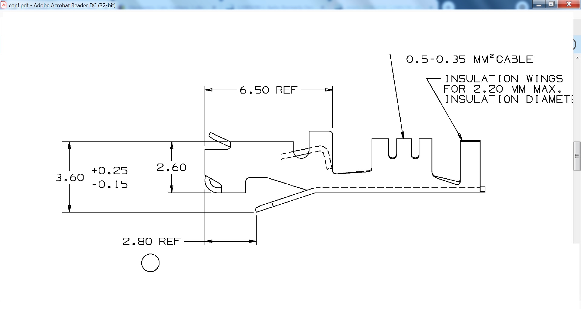

RS Components have a range of these terminals, if they are indeed the right ones. They have 600 for local delivery.
https://au.rs-online.com/web/p/automoti ... s/8011099/
As I mentioned above, replacing the whole plug is much simpler and more effective.
They have a range of other Delphi Connectors/ Terminals as well if anyone is interested :)

'quipt4it wrote:Easier to buy the short harness for the DFI.
i cant see the photo for this one? but my main goal is to run wires externally with brand new cam and crank sensor connectors that run to the DFI then to the ECU so i can fault find a potential wiring issue from this thread i posted months ago viewtopic.php?f=7&t=7051 Just want to try it this way rather then pulling the whole engine harness out then find out its not the issue but im almost certain im on the right track with it now.
vlad01 wrote:I think it's this one but I would have to double check.
this is exactly them awesome
'quipt4it wrote:RS Components have a range of these terminals, if they are indeed the right ones. They have 600 for local delivery.
https://au.rs-online.com/web/c/?searchT ... +terminals
https://au.rs-online.com/web/c/?sra=oss ... connectors
This 1st link looks like them also i'll give these try.

wrx884 wrote:...i cant see the photo for this one?...
This is it.
get connected - Copy.jpg (20.71 KiB) Viewed 6660 times
The terminal I linked to in my second post is the 150.2 series, however, the p/n you are looking for is 12089290.
Just checked PEC Australia in their eBay listings and it is no longer showing (from above picture). I have sent them a message re availability.
Holden used to sell the DFI harness under p/n 92143911. Worth a try.
